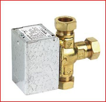

Hi Sefton, if you have either of these, I would suspect the little synchron motor has failed. Very common, but you need to do a few electrical tests to be sure. It's a lot easier when we know more about your system ;)
View media item 38425 View media item 44939
Yes Pete - I do have a motorised v/v exactly as you have illustrated. I operated the slave lever and latched it into position. Still no joy. I am suspecting the programmer.
Simply latching the lever will not close the internal switch on either of those valves. That lever is for opening the valve to enable filling of the system. A multimeter is a must for diagnosing your fault. It's more likely to be the internal motor than anything else. Unless you are capable of doing some tests then it's not possible to be certain.
I have a multimeter and I am capable of doing some tests.
With a meter, you need to test for power to the white wire of the valve. This is easily done at the wiring centre.
