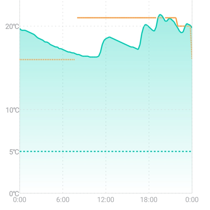

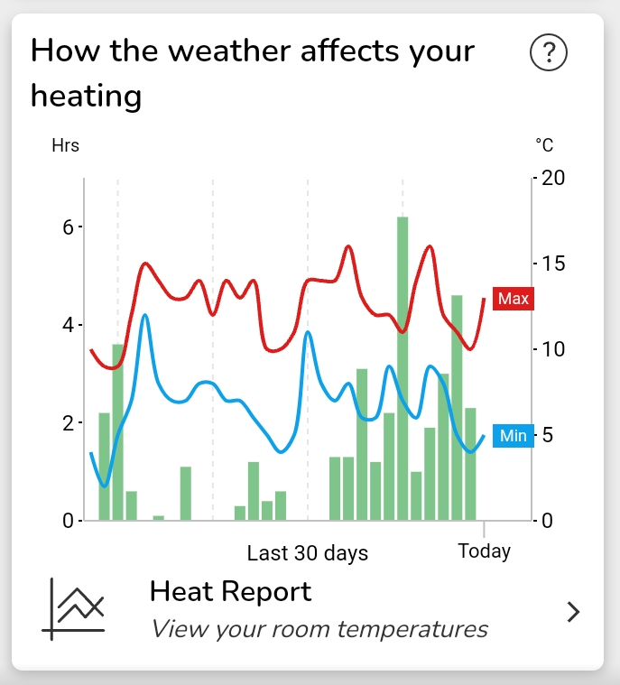

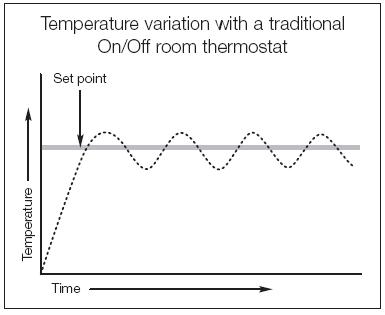

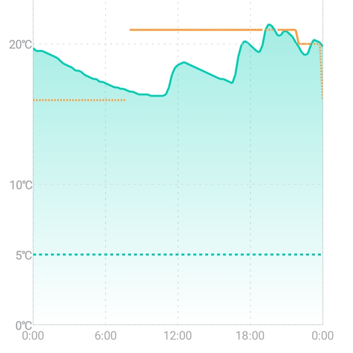

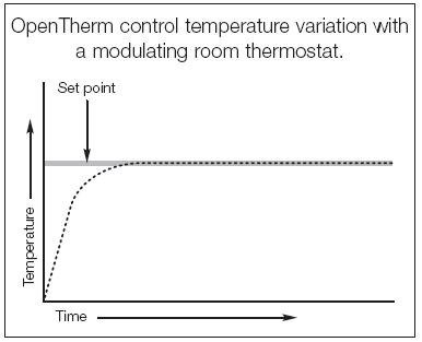

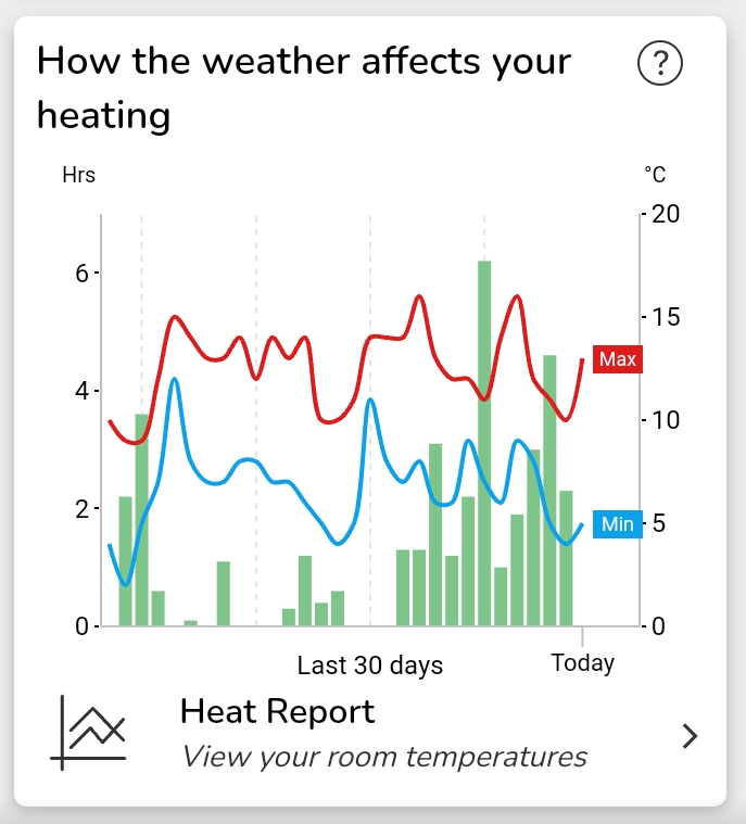

I have a large house, with it seems same boiler, and clearly every time the boiler fires up, it uses energy to heat the water in the boiler, but unless the boiler is outside, that energy is not wasted, it still goes into a room. We are shown graph's like this Temp_variation_on_off.jpg and told how we should aim for this Temp_variation_OpenTherm.jpg but our oil boilers don't have opentherm, so that is not going to happen, I look at the report from the TRV head 1731240874053.png looks pretty, but as to helping not so sure, same with the wall thermostat 1731240985370.png it looks good, but what does it tell me?
So the kingpin in the control is the TRV, it controls each room, and stops any room getting too hot, if the TRV closes, then the boiler will fire up, and within minutes turn off again until water in the boiler has cooled, if we however link the TRV to some hub, we can stop the boiler firing up when not required, so ideal is all linked TRV heads and a hub, but they cost, so we look at near enough engineering.

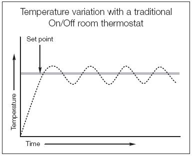

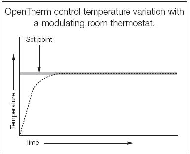

I have a large house, with it seems same boiler, and clearly every time the boiler fires up, it uses energy to heat the water in the boiler, but unless the boiler is outside, that energy is not wasted, it still goes into a room. We are shown graph's like this View attachment 362302 and told how we should aim for this View attachment 362303 but our oil boilers don't have opentherm, so that is not going to happen, I look at the report from the TRV head View attachment 362304 looks pretty, but as to helping not so sure, same with the wall thermostat View attachment 362305 it looks good, but what does it tell me?

I don’t understand why you have such a mismatch of controls, no wonder it’s not working how you want.
Cycling doesn't do the slightest harm to Oil Fired Boilers, they can last up to 35 years without replacing a single item, mine is 19.
The Heatgeek and others reckon that if the cycle time is > 3 minutes then very little effect on boiler efficiency, maybe a percent or two.
The main thing to look out for in a condensing oil boiler is to ensure that the return temperature is not allowed to drop below ~ 40C to avoid corrosion problems as stated above.
