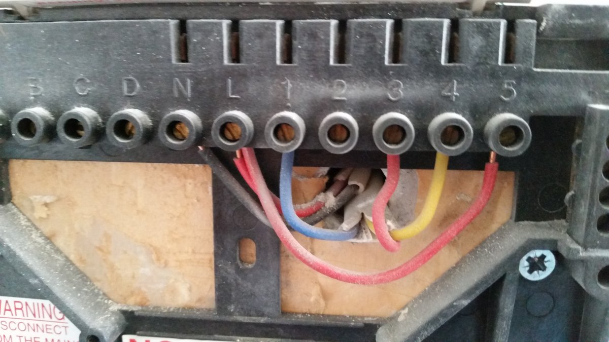

Hi All,
I am looking to change my old wired thermostat and Potterton programmer for the new Wireless Hive 2.
I currently have a conventional boiler with a separate hot water tank.

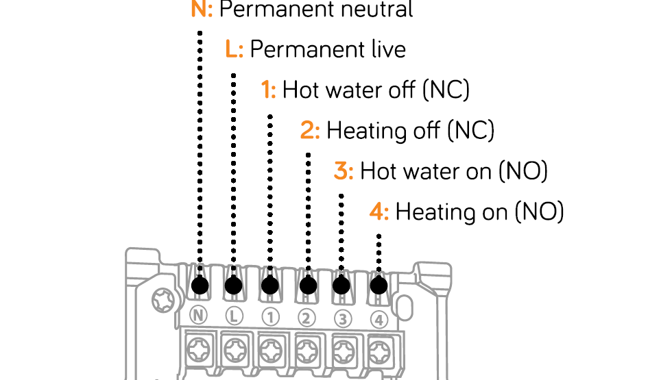

The new receiver that replaces the programmer needs the below wiring:
I currently have the below wiring:
And this is from the current Potterton programmer:
Question is, where do the old wires go to the new receiver (diagram).
I believe on the current wiring, wires 3&4 are connected to the thermostat.
Many thanks
N - N
L - L
1 - 1
2 - 2
3 - 3
4 - 4
Couldn't be simpler really!
After fitting the Hive receiver the old CH Room thermostat wiring will need a slight change, otherwise you will have two room thermostats trying to control the heating.
If you can post pictures to show the thermostat wiring in the wiring centre I'm sure someone will tell you where to connect a link to bypass the old room thermostat.
There currently is no wire in slot 2 and slot 5 looks like a permanent live bridged from L.
My current programmer has 1 - 5 slots and new one only has 1 -4.
You don't need that Potterton short red Live link (in #5) in the new receiver and #2 is still not used.
I thought i could just connect the two wires in the current thermostat together to give it a permanent live.
That would also work, but isn't conventional
