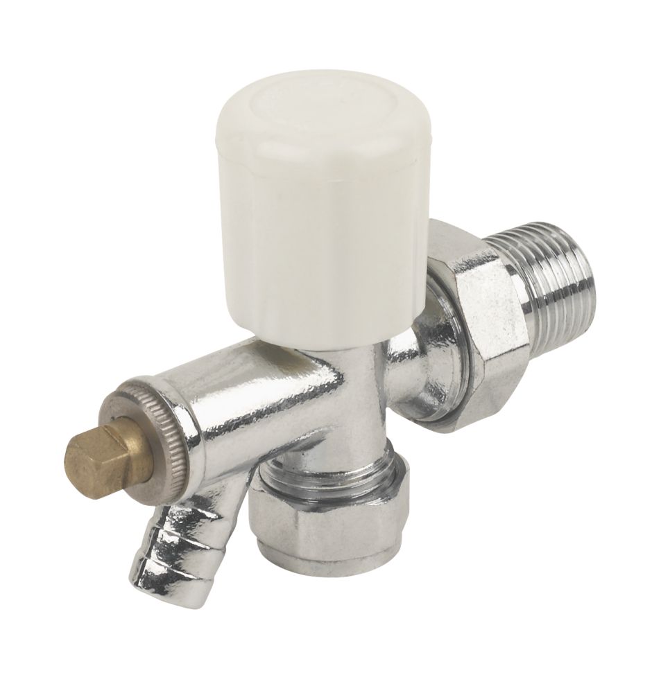

I'm unsure where the system drain is located. All of the downstairs radiators have something like this although the white cap is located in a horizontal position as opposed to vertical and is not a screw cap.

please post a photo of the actual valves on your system
the one you show includes a hose connector on the tail, for a drain. I don't know if that is actually what you've got.
If you can't find any drain cock, you can drain the system by loosening a radiator valve. Very often a 3/4" bsp connector for a garden hose or washing machine hose will fit, which is quite convenient. Once it is drained, you can fit one or more drain cocks for future use.

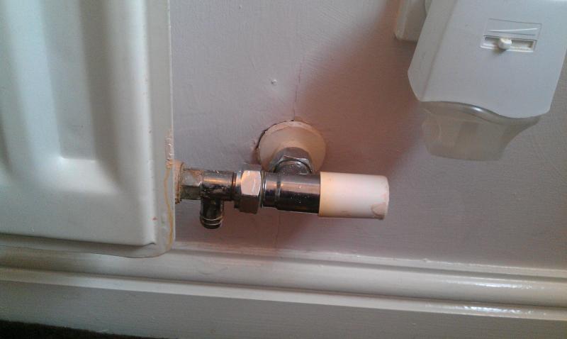

Sorry. I have enclosed a pic now.
All rads on ground floor are similar except the one near fron door does not have a trv at the other end. All other rads have trv control.
House is on two levels with header tank in loft.
The ground floor is concrete so I would all rads on ground floor are at same level.

The bit between the valve and the radiator has a hose connection on it
To used this to drain you need to use a radiator bleed key where the hose connects to undo the screw then put the hose on and open the rad valve.
You will get water coming out until the hose is attached, put down towels and a tub if it fits(old ice cream tubs usually fit) and have your hose ready rolled out to a drain or outside some where.
They are not an ideal drain point given what I have explained above
Sorry for stating the obvious here
So, I can just use any downstairs radiator to drain system?
Or it is a case of drain from one radiator downstairs and see if the others have emptied?
Depending on the pipework configuration you may need to drain from each radiator using the method described above. You might need to open the adjacent valve fully by removing the cap and turning the head anti-clock to fully open the valve. Count the number of turns and make note so you can reset the valve when you refill.
