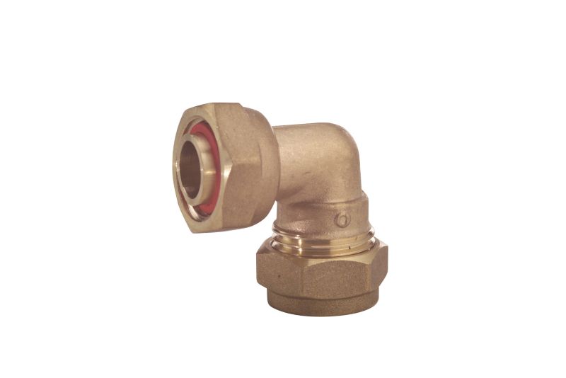

Thanks for the feedback Tony, what I actually mean are the 22mm x 3/4" right angled compression fittings, something like:
5050027123706_001c_v001_zp
Russ :)

I don't know what the connection type is on a duotec, but what you've got in that pic is a bit bodgy . Why don't your phone baxi and see if they can suply you with the correct ones.
Yes you can. I've had it before where you need to run pipework up and down straight off the boiler. Bad design by baxi as the tails are all on elbows.
My solution was to use straight tap conn's. File the short piece off after the lip which holds the nut on so that it is a butt joint and use fibre washers. You can then put tee's on to go either way :D
Make sure you do a good job when filing and you won't have any problems when filling up
HTH Sam
You can get a jig connection kit from baxi. Your local plumbing merchant will be able to order it.
Like this man says your local merchant or spares place can get you the complete correct jig kit which contains all 5 connections (FL, H, G, C, RT) and a spare blow of kit and its not expensive.
I don't know what the connection type is on a duotec, but what you've got in that pic is a bit bodgy.
The Baxi manual just describes the tails as 3/4" male - I've actually fitted the return feed back to the boiler using these tap connectors and so far it's working, but I'm wondering if there's any techie reason why this might fail in the future?
