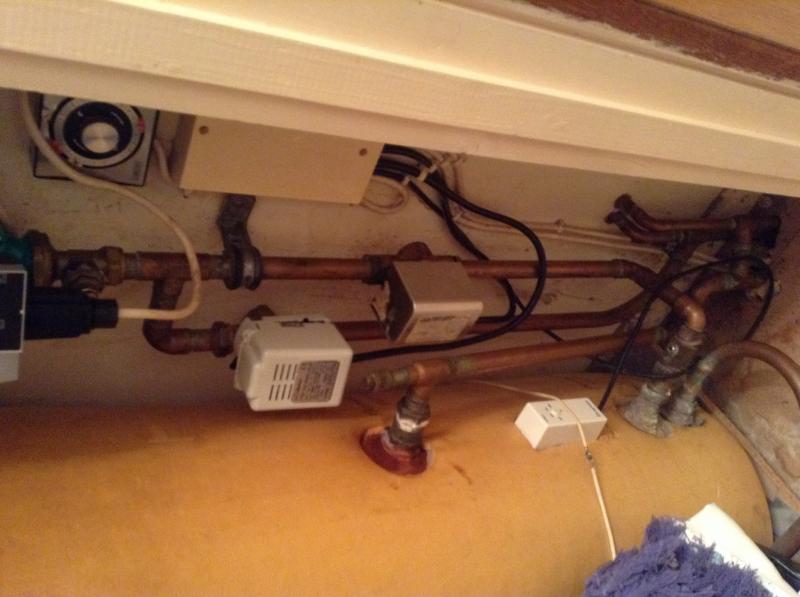

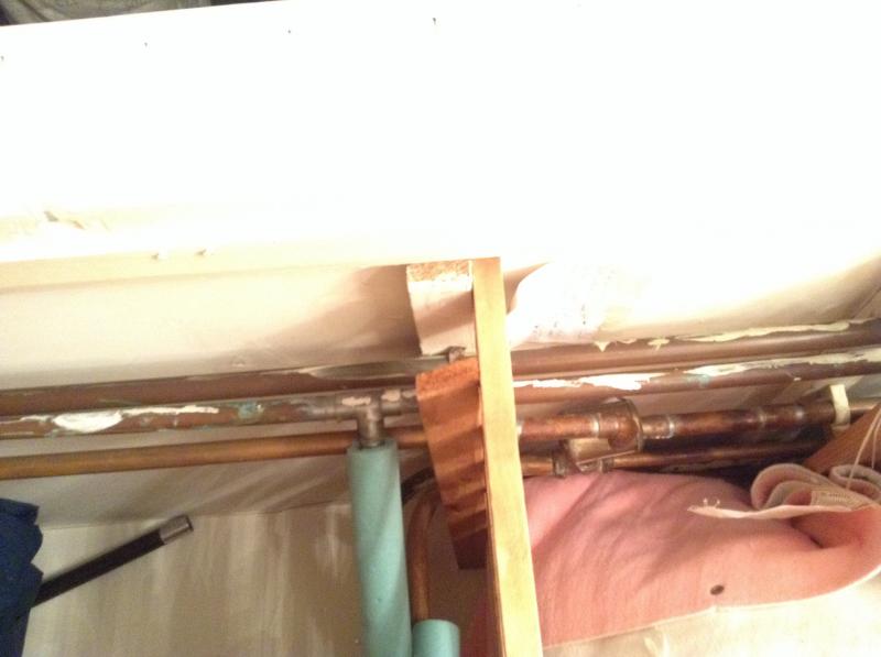

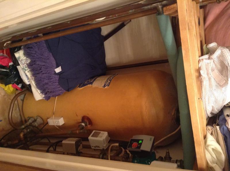

I would be looking at the pipework around the expansion/cold feed connections to the system as well, particularly if you have an air separator fitted. These can block solid with crud, only solution is to cut out affected sections and either clean out manually or replace. Photo of pipework around this area may help if you're unsure.

Thanks I have a separator will have a look at weekend after I've drained here are some photo's
