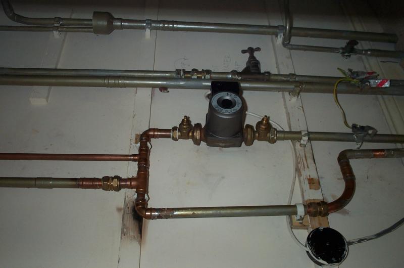

I have a Potterton Prima 60F Central Heating system - simple heating system with 16 rads each with TVR so no room stat. Had problems with air in the system for a number of years. As the system worked OK I just bled a number of radiators weekly to remedy problem.
12 months ago I had to replace the pump and since then the system has ran very noisily after a couple of hours ie loud running water noise round the pipework in the airing cupboard - this is a new noise.
So after discussing on this site was advised to get rid of air problem first as it looked like my pipework arrangement could have been causing air to be sucked into the system via expansion tank. Recommendations included lowering horizontal pipe above pump ie increase static height plus increase its length so the pump would not be pulling directly on the feed/expansion pipe.
Pipework before mods

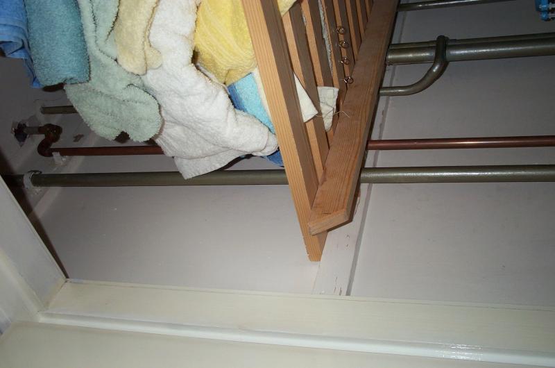

The 2 pictures below show new pipework arrangement. On the picture showing the pipework going into the loft - expansion tank, I decided to create 2 right angle bends enabling me to not change the siting of the tank connector. Could this be the reason why I am still getting air in the system?

try a decent correctly sized pump like a grundfos 15/50 on number 1 or 2.
Just a side note, I'm pretty sure pottertons used to recommend a combined c/f&o/v on profiles, and assume its the same on the prima. Might have been a better option. The amount of air in your system could well be due to a high level of corrosion taking place, even after correcting the c/f&o/v.
I have looked in the manual and they show a sealed configuration and a combined feed and vent. If I were to change to this configuration would that help ie just extend horizontal section of feed pipe close to the ceiling and t into the vent.
With regard to to air in the system if I run the system with the stat off you can hear air gurgling for 5 mins or so and then it settles down and is fairly quiet. On turning the stat up the noise reappears and gradually gets louder

I did not explain myself too well on that post.The overflow has a connection to it inside the tank which is about 4" long and points vertically down. I presume it is fitted to stop bugs/insects getting into the tank. The water level is 4" above the cold feed outlet. I hope that makes sense and many thanks for taking the time to dig through the history
Well it depends really, if the pump is drawing air down the open vent, then yes this should help. If gases are being created in the system due to corrosion then no it won't. Either way, it certainly won't make it any worse.

Is the pump fitted in the flow or the return pipe. Setup should be boiler flow with first tee branch going to vent, within 150mm second tee branch going to feed (usually branch points downwards- feed/ expansion pipe inverts on itself to connect to this tee). Pump is fitted now to pump forward (away from aforementioned tees)
I take it the cylinder and heating flows are made after the pump.
Everything lines up with your recommendations other than second t which points up - as per photograph
