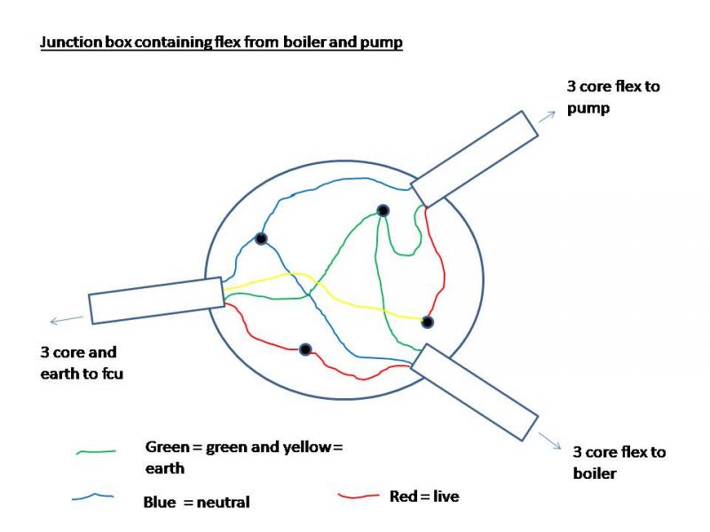

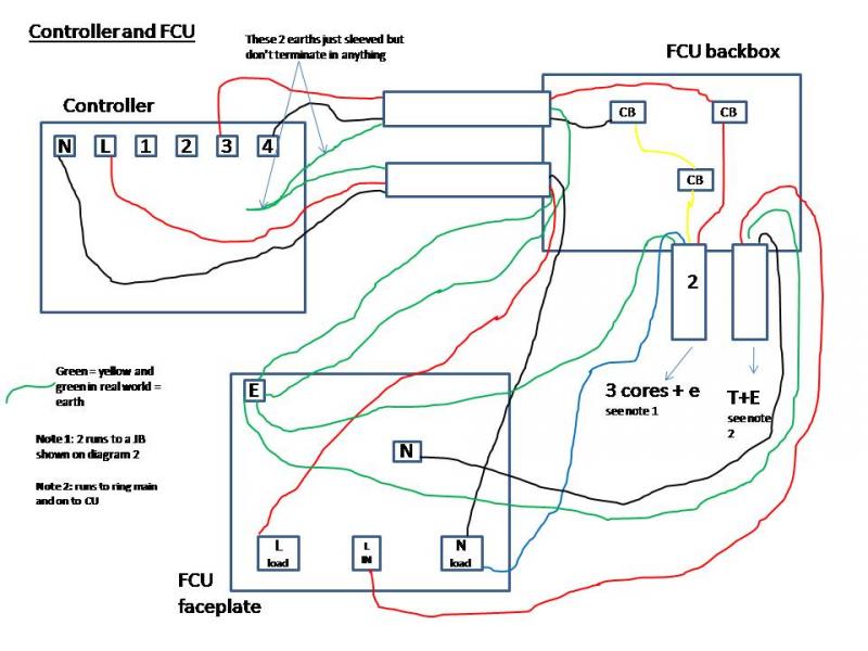

The current set up is as in the following first 2 attached diagrams (bottom of post) So basically it looks like the live feeds from the pump and the boiler is carried in some 3 core and earth cable to an FCU and then onwards to the controller.

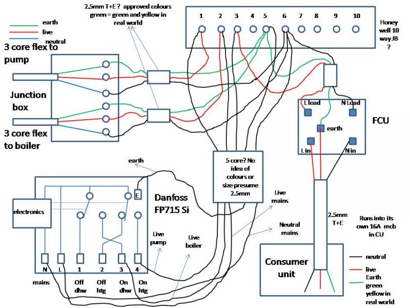

So my question is.... if a professional was starting from scratch how would the cables be run etc. There will need to be a JB at the current location (near the pump and bolier) as the flex from the boiler and the pump is short - presumably as this is under my lounge floor this will then need to be a maintenance free JB. Also I have read about the honeywell 10 way heating control box should one of these be used between FCU and controller ? Are these maintenance free? or are they set into a wall and made accessible etc? There isn't much room where I want to relocate the controller.
The Danfoss is described as a 5 wire installation. My attempt at what I think may be right is in the last diagram - and I am not sure but think that the 5 wire installation may mean I am able to get 5 core cable or something? I don't know about any of the colours in this.
I would be very grateful if anyone could let me know as to what professionals would normally do.

If you have just a gravity system then you can only control the boiler on/off. Not water and heating separately.
So just concern yourself with the controller connxs. Set the contyroller to gravity mode and follow the new for old table that Danfoss provide.

Solid conductors are not necessary on ANY circuit.
Not even wiring under the floor, between sockets, for example.
The only criterea is that the cable is sufficient to carry the max current that the fuse protecting the circuit will allow,
Any colour wire can be used for anything but there is a convention that says that live, neutral and earth must be marked as such (brown, blue and green/yellow) and any conductor that may become live should be sleeved brown.
I have to say that I've never seen that in a central heating wiring centre - except for the ones that I've done!
If you use multi core cable, one of the cores must be an earth conductor.

I wouldnt put a junction box (or wiring centre, as its known in heating systems) under the floor.
I also wouldnt use a honeywell wiring centre.
the push in ones are called smart fit, I dont think there is one for a 'c plan'

This is giving an electrician an open cheque to rewire the whole house! There is NO requirement to bring a house up to the current regulations. Remember the old adage: "If it ain't broke don't fix it!"
Ideally you should convert your system to fully pumped, but if this not affordable or would involve too much re-plumbing, you should consider converting your system to a C Plan. This retains the gravity Hot Water and pumped Heating, but gives proper control over Hot Water times and temperature. You can read about it Here (open the two pdfs shown on the left).
Wiring centres aka junction boxes are essentially maintenance free, but you need to be able to get to them in case you have to change any of the components connected to them.
It would be a good idea to replace the FCU with a simple fused spur (3 amp fuse) and wire everything into a 10 terminal wiring centre, as shown in the Honeywell leaflet, - the junction box for pump and boiler may need to be retained.
