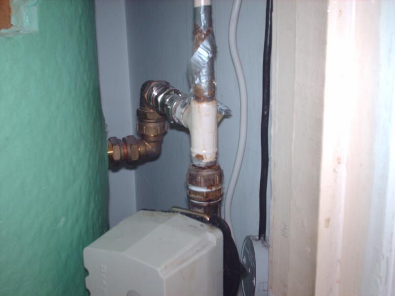

the pump is not fitted on a pipe like that it has a single pipe going in the bottom of it then going out the top, then into the actuator which then goes into an L shaped pipe above the actuator which branches of in 2 different directions
I did not ask about the pump but the valve and actuator. Can you post a picture of the valve/actuator and the pipe work you mention?

Pity the pic is on its side!
Please answer the questions I asked earlier about the valve and cylinder thermostat.
I know you said you replaced the cylinder thermostat, but are you talking about the immersion heater stat, which is in the top of the cylinder.
Looking at the pic the pump is just visible on the left and feeds straight into the motorized valve. It then divides into two after the valve, one pipe going to the hW cylinder and the other, presumably, to the radiators.

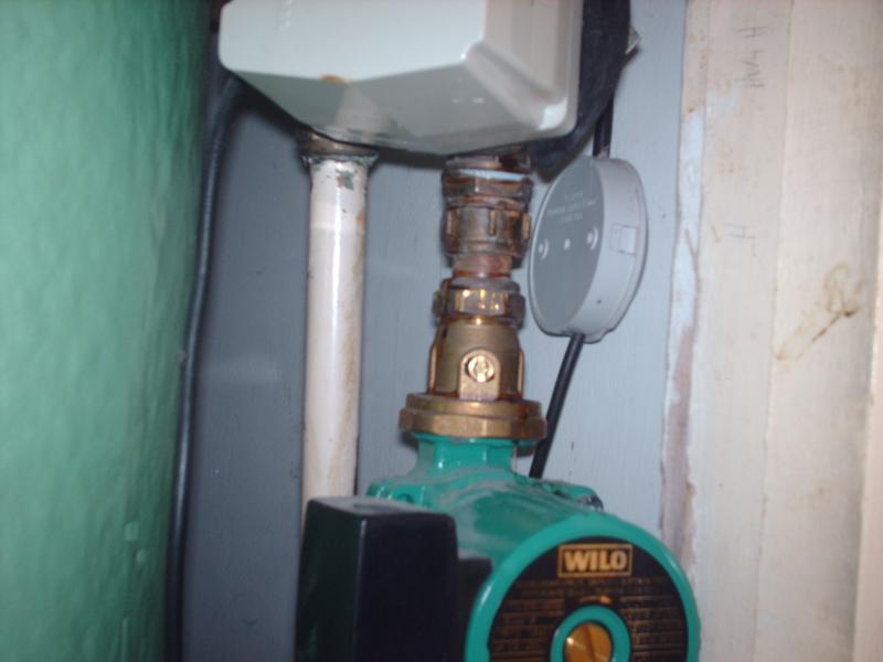

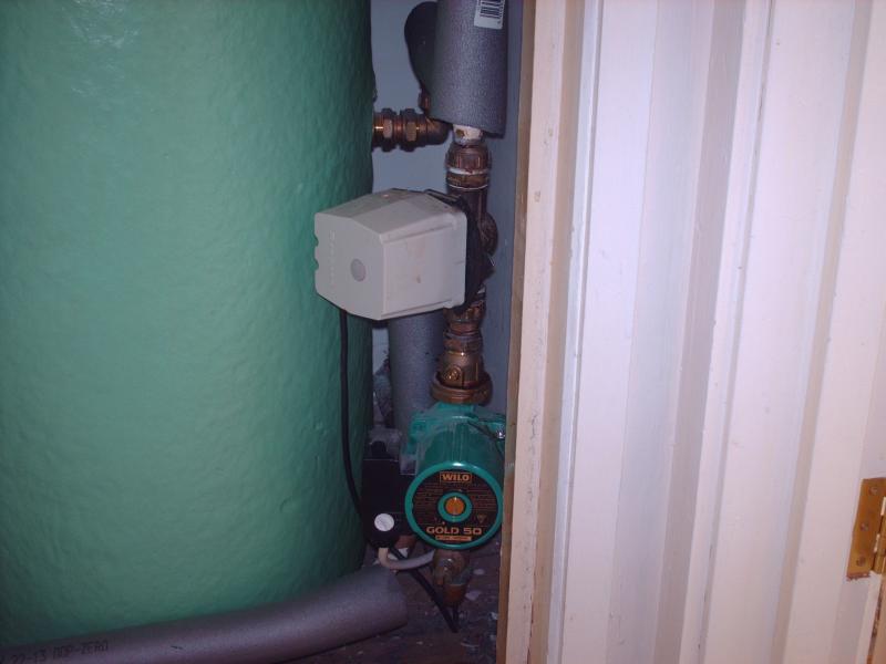

hope this paints a better picture
i have nothing that looks like the one in your picture, what i have is
pump and actuator, on the actuator there is a needle with 3 settings, middle CH/HW, top HW, bottom CH
pipe going into actuator note white pump branches left behind actuator then down and into walls to what i believe will be the radiators
above the actuautor the pipe on the left goes into cylinder and the pipe going up goes to the height of the cylinder then stops, it is closed of with a bleeding valve
the cylinder thermostat has a cable which goes into the relay unit
that cable shares the same port as the cable for the actuautor into the relay unit
there is also a cable from the relay unit to the pump
In the first picture, behind the pump, there is an insulated pipe.
Does this pipe connect to the motorised valve?
no that is the white pipe in the second pic that goes into the walls to what i believe will be the central heating
