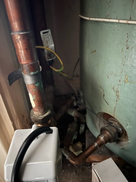

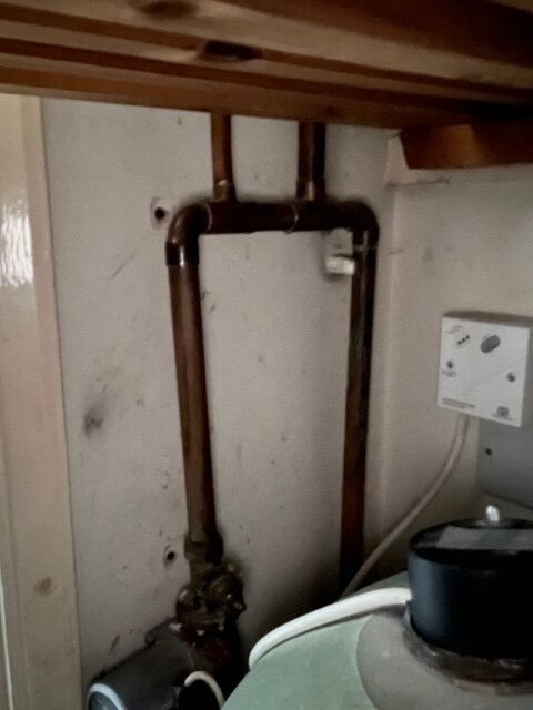

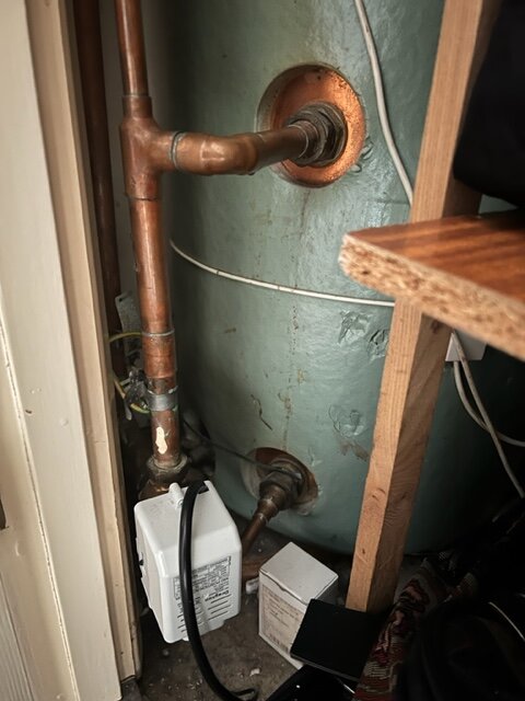

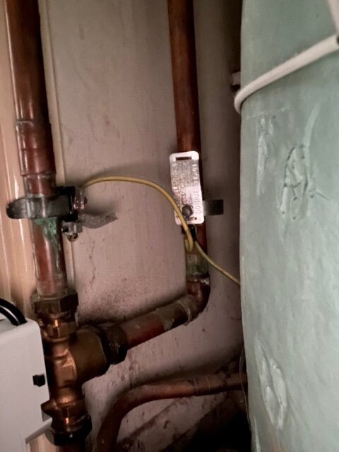

Sounds like the rads are fine when heating only is selected ,but when domestic hot water is called for as well ,the rads don't heat well. Is that so ?
If so ,throttle down the supply to the coil
Exactly that. How do I throttle down the supply to the coil?
Show us pics of pipework into and out of the cylinder ,you may have a gate valve on one of them.
If not ,you would need to fit one.
There's not much space to take pictures but here's what I could do. I'm pretty sure there isnt a gate valve there though.
