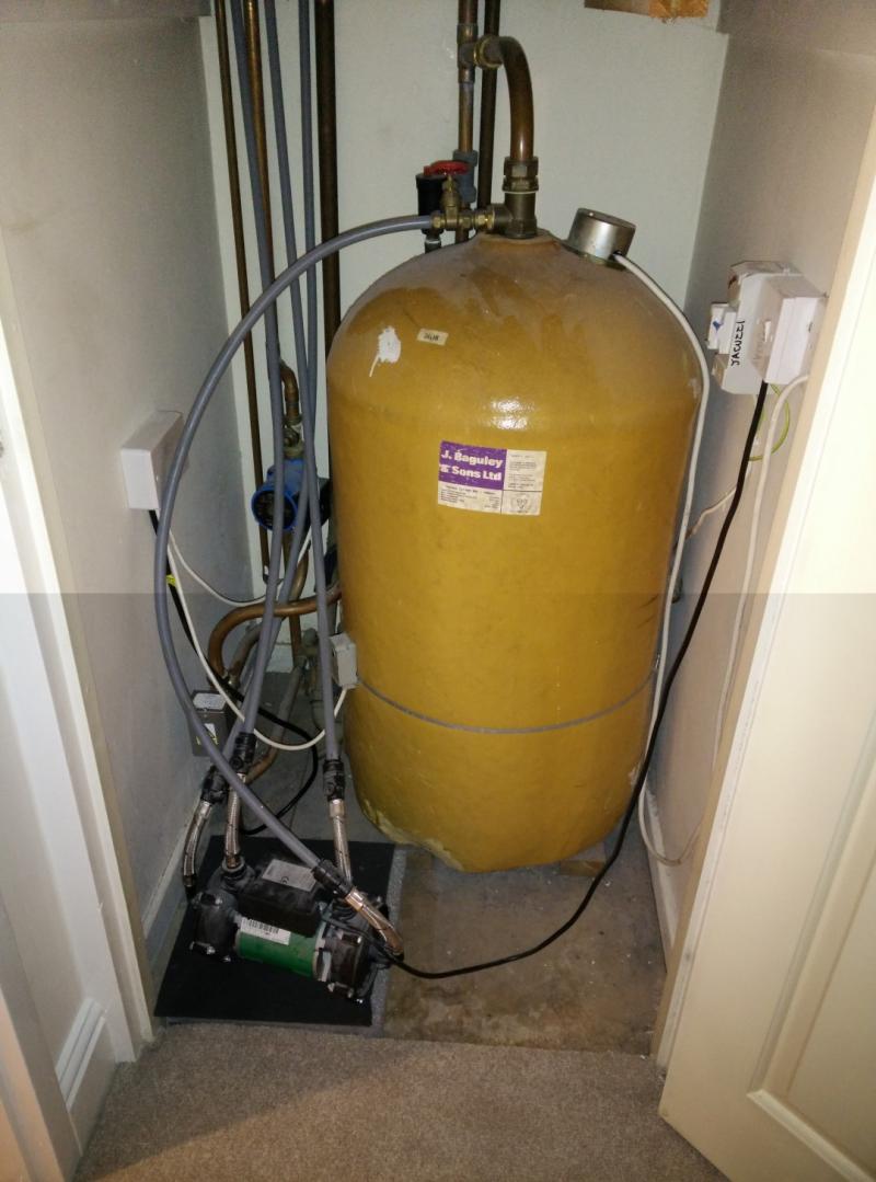

So i had a chance this weekend to take a look at the wiring, this is how it actually looks:
There is no way to bridge Live and the room stat at the junction it seems :(
The only alternative i can think of is that near the junction is the immersion heater switch.
Can I run a line from this? I understand this is on a different ring/fuse - is it a bad idea to mix rings?
