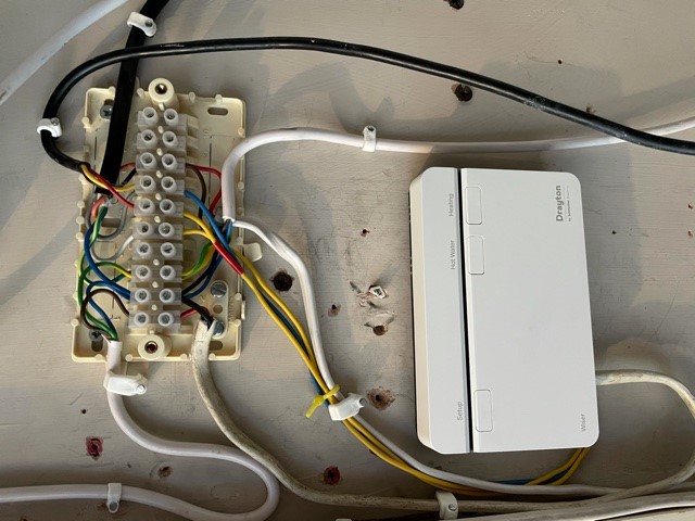

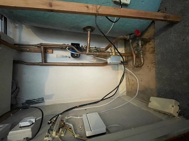

I have a Y Plan central heating system that's been work well until recently however the issue that is occurring is the relays in the controller get stuck in the on position. This causes the heating or the hot water to be constantly on regardless of the thermostat or cylinder stat or schedule.
It seems to affect either the HW or CH or both and doesn't happen straight away, everything works fine for a couple of days and then it occurs. This issue has broken a nest heat link and another cheaper controller, currently a Wiser controller is getting a sticky CH contact - with the wiser by clicking the manual override a few times is currently resetting it.
I've confirmed this with the power off using a multi-meter to check the HW / CH contacts.
I've checked and rechecked the wiring and cannot see the problem. The heating wiring is powered from a fused 3 amp feed.
Any ideas what might be causing this issue?
