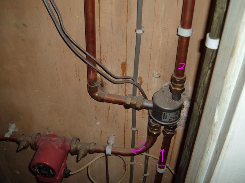

hi guys. complete amateur here!!!
my problem is this!
I have bought my first house (hoorah) but have some central heating and hot water probs. :(
First is that there are no cylinder stat or room stat which in the winter was chuffing expensive!!! there was an old prgrammer which i have replaced.
system is as follows.
Glowworm fuelsaver 2 boiler
horstmann c27 programmer
Honeywell valve 4043 22mm
Grundfos super selectric pump
Myson aerjec 22 de airator
i really dont even know what sort of system it is as reading on the web and what i have dont seem to add up.
The aerator thing seems to be sending water away from the pump according to the diagram on the front
The pump sends water through to the cylinder and also to the valve after the cylinder junction which appears to control the heating.
To valve is wired so that the brown wire is activated by ‘CH on’ on the programmer. The blue is wired into -. Earth is also wired in. the rest are not wired in on the valve, which points at a W plan, except it’s a 2 way motorized valve not a 3 way!!
The pump comes on when the hot water is called for. Which also confuses me as I thought it was a gravity HW system.
Everything I read on the web makes me think that this system is a bit messed up and leaves me stumped about wiring my thermostats in correctly.
What sort of system do you all reckon it is???

Well I give you full marks for good sharp pictures but its a pity that you have not shown what would have helped us more like a picture of the zone valve.
Wiring colours mean nothing because anyone can use any colour.
I would expect that you have a system which heats the hot water only on a pumped basis and if the valve opens then provides heating as well.
Thats quite good but runs the boiler all the time even when the water has got hot.
To add proper controls you will need to add a second two port valve and a cylinder stat.
In many ways it would be better for you to buy an ACL controls pack and start afresh with all new bits and wire it up yourself with the instructions.
Tony
Just beaten by Tony but here goes.
Your system setup is commonly found and is typical of a cheap lash up that basically works but has several shortfalls.
Currently there is no control of the stored hot water temperature other than by turning down the boiler thermostat (to prevent scalding water). The pump and boiler will run continuously during a programmed on time since there is no cylinder stat fitted.
The pump will run for both hot water and heating. The motorised valve opens for heating only. The original timeclock will have been setup in a such a way to prevent heating operation without the hot water on simulteaneously. This ensures the pump/boiler runs. The gate valve (technically should be a lockshield valve ie non adjustable by the user) balances the flow between the cylinder circuit and the radiator circuit.
Ignore the arrows on the aerjec - they point to the recommended setup, however from memory (and without checking the van library) there are alternative ways of connecting the device up.
The pump wiring box is underneath the pump - this is bad practice since leaks would constitute a hazard.
You need to check whether the boiler requires pump overun (some fuelsavers do) by looking at the boiler wiring connection. If it only has a L,N,E then it doesn't have pump overun.
In which case you could turn the system into S plan, ie add another zone valve for the hot water. Thermostats would be added for both hot water and room temperature. The timeclock may need reconfiguring to provide full control.
There may be sufficient room to fit the zone valve where the current gatevalve is. You will have a problem fitting in the lockshield valve. This would mean that while the hot water zone valve is open the radiator circuit will not have the required water flow and will cool down to some extent. Although not ideal it may be acceptable (and is commonly found).
Otherwise you are faced with significant pipework changes.
Check Honeywell site for S plan details but its the easiest setup.

im gonna have to resurrect this one from the dead im afraid!
I FINALLY got this lot sorted out. room stat, tank stat, second valve in place of the stopcock.
Now i have a new problem!! :evil: the boiler goes out after the timer goes off. seems like there's a boiling sound from within the boiler (funnily enough!) then a loud click and it goes off. seems like a safety cut off.
the only thing that has changed within the water system is the new valve. i'm thinking that pressure is building up until the boiler switches off. its only when both valves are closed!
from the previous pictures the Aerjec seems to be plumbed in incorrectly.
the water flows as per the picture, 1 or 2 is the cold water feed / vent and vice versa. looking on the aerjec website this setup is not one of the ones which work.
would the aerjec be the only expansion pipe on my system? is the problem likely to be what my puny brain thinks it is? how can i remedy it? at present i have my dhw valve manually open and the problem has gone!
HELP PLEASE!!
Cheers
jon
just an airlock mate, turn both zone valves to manual then switch system on. leave running for a little while to clear air. after that switch system off close valves to auto setting then try again. :eek:
