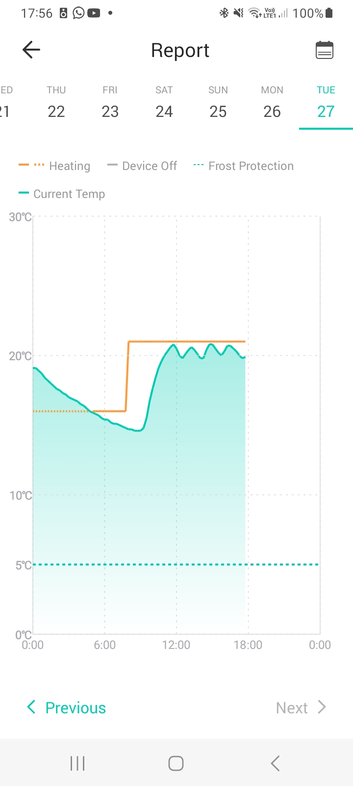

If you want to reduce the heating bills, the programmable TRV heads is likely the best option. I can select when and to what temperature rooms are heated. I have done it on the cheap, with 5 x eQ-3, 3 x Energenie, and one Kasa (TP-Link) TRV heads. Better of course if connected to the main thermostat, but it does reduce cost when each room is only heated when required.
My system is far from perfect, my boiler is oil, so on/off it does not modulate, and my hall cools too slowly when the main thermostat is, but if I look at the Kasa report for today 1709056711453.jpeg it is doing a reasonable job at keeping my living room to temperature set.
