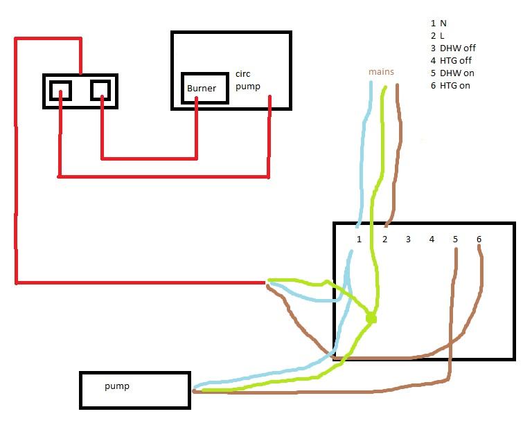

hi i have a danfoss fp715si programmer which controles hw or ch
when i have ch on the motorised valve opens but boiler doesnt fire unless you also hit the hw on.
any1 know much about the wiring for these
What type of system do you have?
Sound slke the timer has been set up for gravity hot water, is that the case with your system?
hi i have a circulating pump so i assume its a pumped system. the programmer is set to pumped. i think it a wiring fault i have live going to dhw on and htg on but nothing going to htg off or dhw off.
also i dont have a room stat
Do you have a motorised valve like this one in the system?
If so it's a common fault for the microswitch inside the top of this valve to become faulty and not switch on the boiler when Heating-Only is required.
