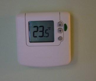

Hi.
I know very little about central heating systems. My problem is the radiators are all stuck on full blast.
I am using a Honeywell thermostat, I think it's a DT90E.
The thermostat is set to 20. It shows room temp at the moment to be 26.5. There is no 'flame' symbol on the display, so the thermostat is apparently not asking for more heat.
The system also has a complex controller - a Horstmann ChannelPlus H37XL Series 2. I have selected the two channels called "Heating" and set both to "off". Still the rads are at full temperature, almost too hot to touch.
Does anyone know what the problem could be? And what can I do?
Thanks.
I'm not a plumber, but you could try switching the hot water off too. Then if the radiators gradually cool, it might be that a motorised valve is stuck. these are easily replaceable.

I've taken the batteries out of the thermostat. What effect should this have, if the system were operating correctly?
Also, I seem to remember that the Honeywell should reset itself, if you hold in the up/down buttons together. Is that right? Mine does not respond in any way if I try that.
Streuth! The temperature is still going up. Just put batteries back in the thermostat and it's 27.5 in the room.
Is this dangerous?
How can I disable the whole system?

Sounds to me like the motorised valve for the heating is jammed open so constantly pushing heat round the rads.

I still have to get to the bottom of the initial problem - why isn't the thermostat switching the rads off when the room temperature is reached?

The thermostat is still giving a room temperature above the point it would want to turn on the heat - don't know if that matters?
