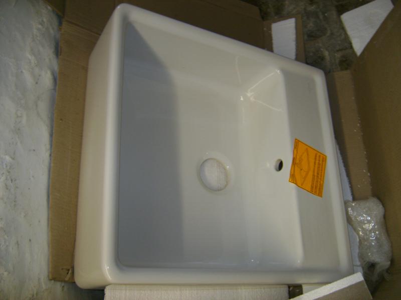

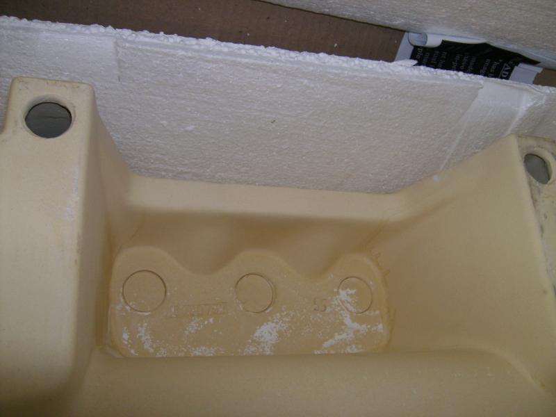

i have just purchased a ceramic sink, the tap holes are semi drilled, can anyone advise me on the safest way to drill out the holes without damaging the sink?
The Belfast sink doesn't usually have tap holes. The taps normally come up through a timber draining board at the back, or from bib taps in the wall. Have you got a photo of it?
dog - your sink is known as a Ledge Sink but they're usually sold (and known as Belfast Sinks) - 'Belfasts' come in numerous styles and sizes.
Anyway, your holes ... follow the instructions BUT don't give it too much wellie & use a smallish hammer (maybe a pin hammer) or a punch/hammer combo. The purpose is only to strike the centre of the ceramic plug so fracturing the break line ... this can be done with confidence that no damage will occur (obviously take care not to hit the glazed surface, on the opposite side, with the hammer pein (back of hammer). The waste hole is done in the same way, however sometimes the underside (unglaxed) of the waste hole can be left with a rough surface (difficult therefore to create an effective seal with the chrome/brass waste) ... this roughness can be smoothed away flat with a carborundum stone (I use a scythe/sickle sharpening stone) or even an old angle-grinder disc (manual, not in the grinder!!!!).

Thanks for the advice guys, but still a bit nervous about tapping the tap holes through, would it be safer to drill them out with a hand drill
dog - 1000's have been tapped-out without mishap ... take a deep breath and go for it. You're more likely to damage it using any type of drill.
Thanks guys, tapped the hole through after takng a deep breath, taps fit a treat.
