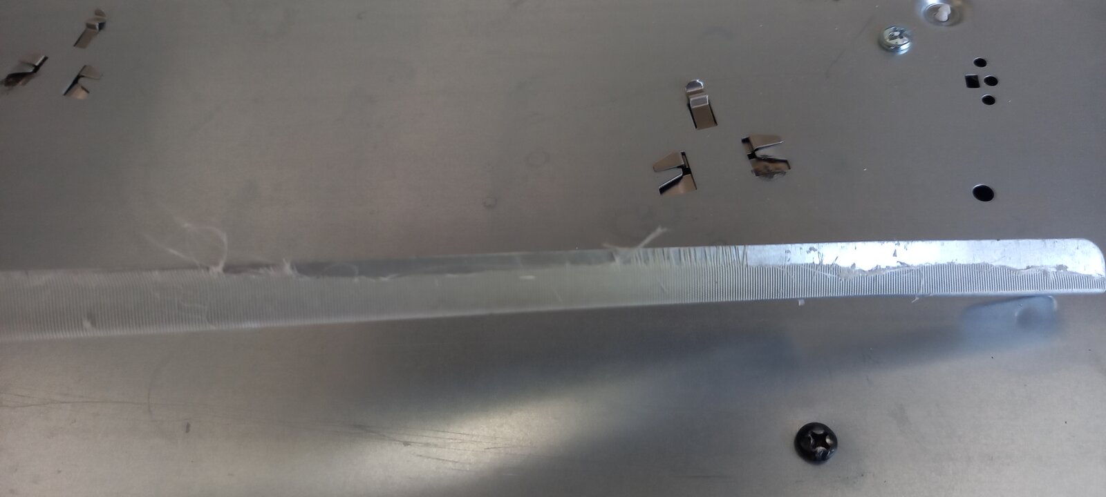

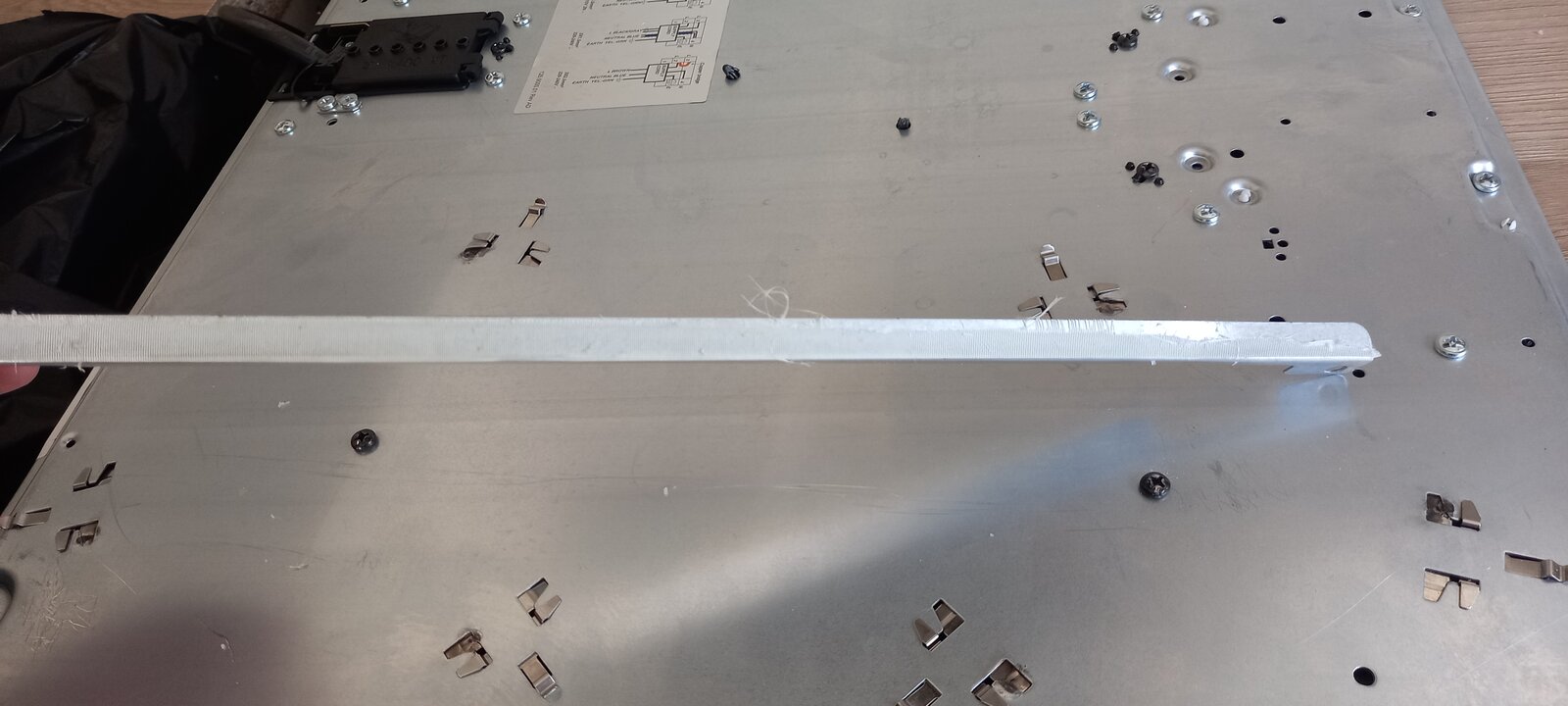

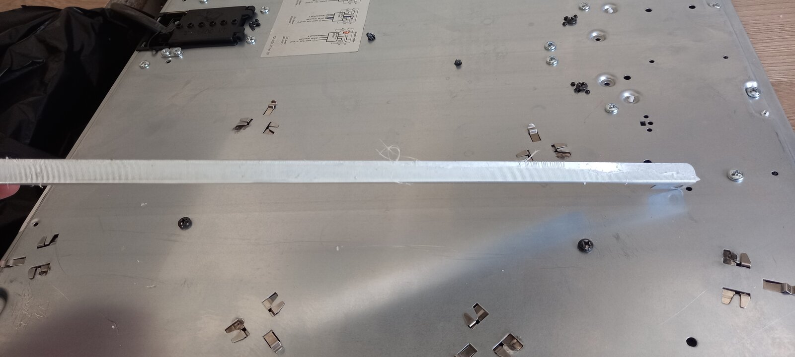

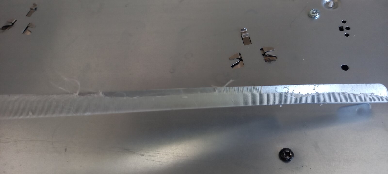

Also, slightly difficult to explain but along the sides of the unit, underneath, are thin metal pieces that run almost from front to back and are somewhat bowed or diagonal. Part of these long thin pieces are lined with some thin white fabric stuff than looks like thin silk lace. Some of this has now been shredded up in the process of cutting the sealant to remove the unit. Is this fabric stuff important?

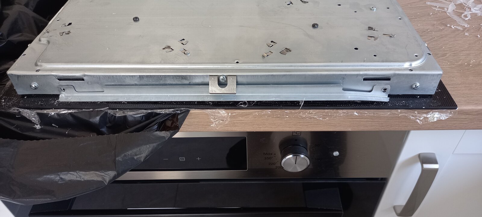

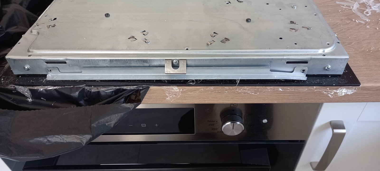

Thanks for the feedback. Here is a picture of that side metal piece I'm talking about. Here it is in place with the screws removed. One part of it is in contact with the underneath of the black glass, the rest is bowed away. On the top side it has this strip of thin fabric. I'm not sure what the purpose of it is but it has been shredded a bit in removing the silicone. Do you think this matters?

No I don't think you have caused any problem that will prevent it being installed properly.
