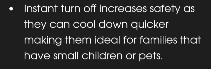

I came across Ceramic Electric Radiators. What are they like cost running wise compared to electric oil filled (fluid filled) rads? Buying prices are fairly similar.
There is also panel heaters and convection fan heaters which are cheap to buy but expensive to run, correct me if wrong.
If they are the same power input, the operating costs will be exactly the same.
That applies to all resistive electric heating.
The only difference is some types (convectors, fan heaters, radiant) provide heat instantly and stop providing that heat when off.
Others heat up various materials (oil, ceramic plates, bricks) and take longer for heat to be provided, but stay hot for a while after switching off.
In every case, the heat provided and the electricity used is identical.
There are plenty of vendors claiming their heaters have magical properties and cost much less to operate and provide more heat than anything else.
They are all 100% lies.

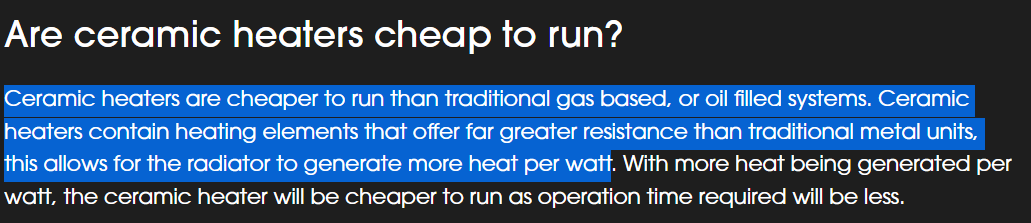

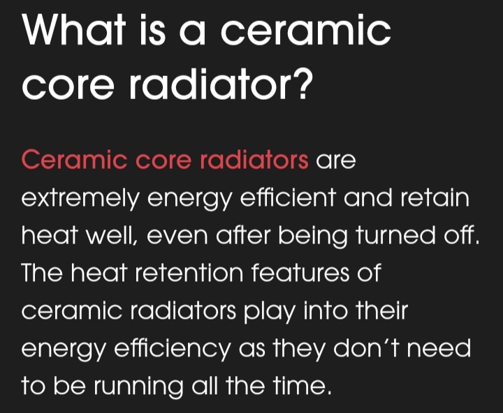

What do you read into this:
Do panel heaters use a lot of electricity?
Panel heaters are less efficient than electric radiators because convected heat is inherently less efficient than radiated heat. This means that you'll need to use more power to heat your room with panel heaters than you would with energy efficient electric radiators.
A fundamental deficit of understanding, based on a mostly unrelated fact.
In some situations, radiant heat is more useful as it heats objects rather than the air. Those dreadful patio heaters being one example - they can heat people and objects in front of them. Outdoors a convector heater which heats the air would be useless, as all of the heat would be carried away by the air.
Indoors it's irrelevant, as generally people want the air heated, and it won't be lost as it's usual for people to have doors and windows closed when the heating is on.
Radiant / IR heaters exist for indoor use, ideal for people who want to be roasted by radiant heat while sitting in an icebox.
There is still no efficiency difference, it's just how the heat is provided.
