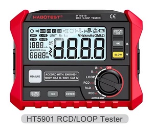

The first hurdle is you need test equipment,
these are the cheapest loop impedance tester and RCD tester (red) and insulation tester (blue) I can find, at around £70 and £35 plus in Wales for first £2000 worth of work, the fee is £100 plus vat, so unless you already testers, not really worth buying testers for one job, why would you want to pay £200 to do a job the landlord should do?
