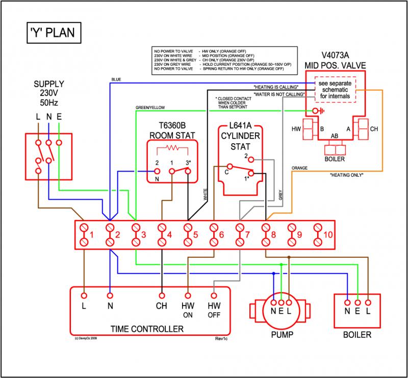

Time to check the wiring! In particular the live feeds to the MPV.
Disconnect the orange , grey and white MPV wires and check the terminals they normally connect to.
Switch CH and HW on
Orange terminal should be Live (this is the HW on)
White terminal should be Live (This is the CH on)
Grey terminal should be Off
This is to check that the supplies that normally activate the MPV are correct before the MPV moves and engages micro switches

CH & HW set to "ON" on the programmer.
CH & HW termostats turned up to max.
White, Grey & Orange wires disconnected.
White = Off
Orange = Live 240
Grey = Off
You need to trace back that white terminal as with CH on it should be live.
The white wire terminal should be the switched live from the Room Thermostat.
I suspect the present white wire terminal is not the switched room stat. it may even be to the HW off terminal from the programmer.
