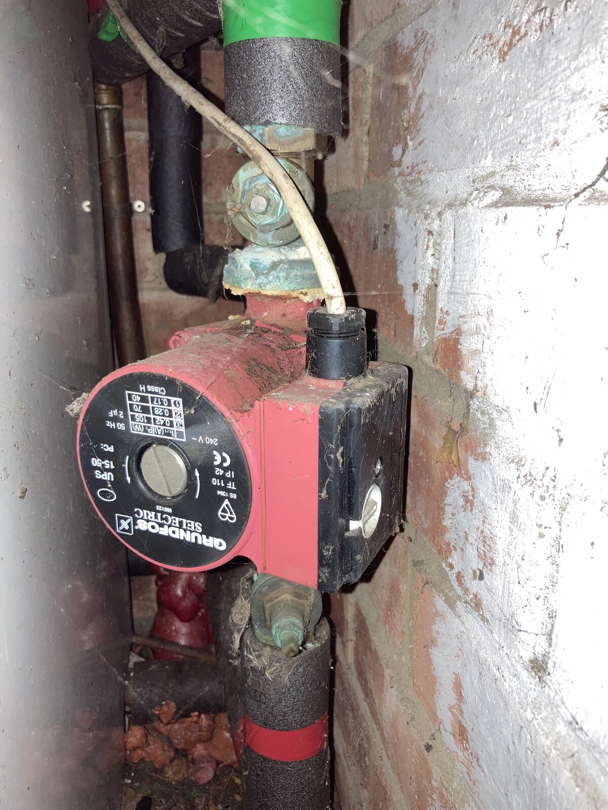

Motorised valve issue,show us pics of motorised valve
( Small box on pipework with electric cable going into it , usually close to the pump)
Thank you very much, see picture attached
Not the sort of thing that can be sorted on here ,but should be easily diagnosed when the system is in front of a competent engineer
Thanks will definitely will be contacting a professional, but input from Terryplumb is extremely helpful to have some sort of idea what is going on and to contact the right professional as we had been going to contact an electrician about dodgy wiring but if seems like a heating engineer would be more sensible if the valve is at fault.
Ahh right! I’ve looked up what the motorised valve should look like and have searched around and can’t find one on any of the pipes. We’ll have another hunt around in daylight (it’s out in a garage). Thank you again, at least we know to contact the correct professional!

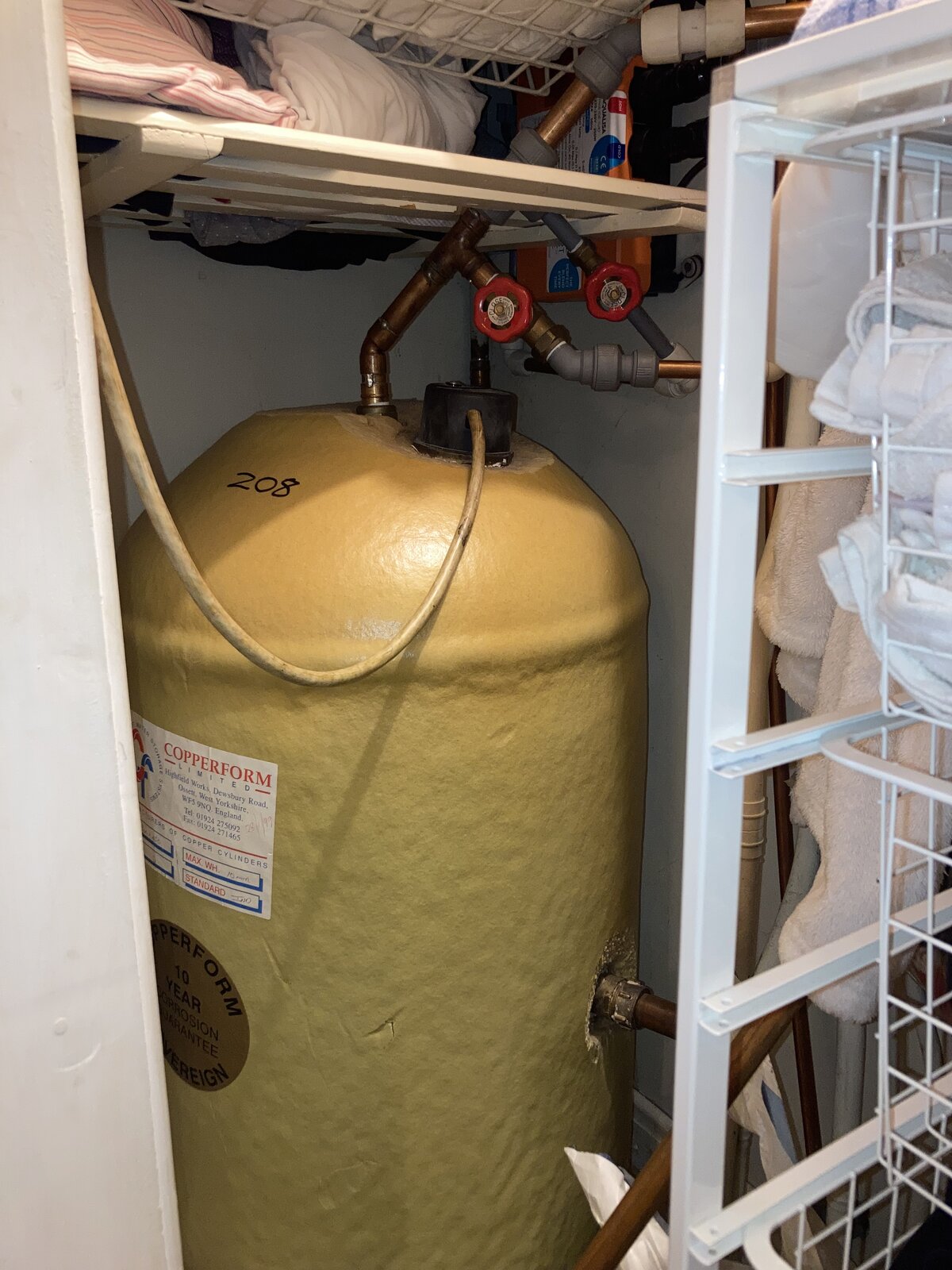

It’s often in the hot water cylinder/airing cupboard.
Thank you. We’ve just had a good look in the airing cupboard where the hot water cylinder is and can’t find it, and nowhere to be seen near the boiler either. Is it possible we don’t have one? I hope it’s not buried in a wall or ceiling cavity somewhere!!
It’s possible. Can you take a photo of the cylinder cupboard?
