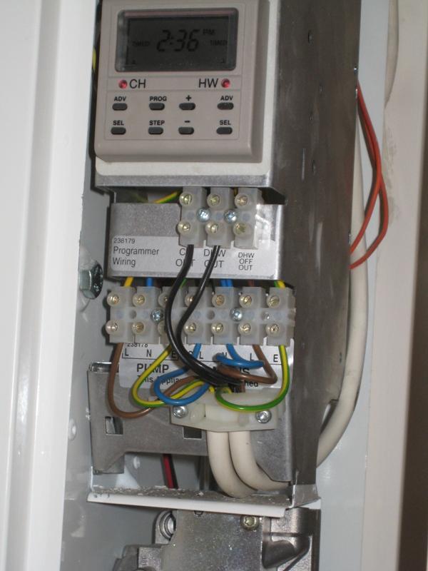

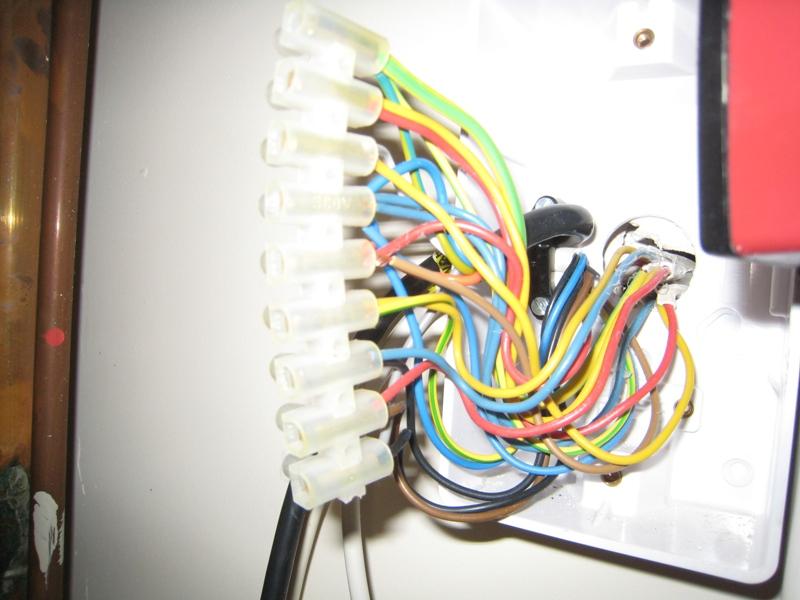

Not of much help, but I've attached a couple of photos. The first shows the airing cupboard connections - black cable is 3-port valve, middle white cable pump and bottom cable HW stat. The second pic shows the connections to the rest of the house (boiler,roomstat etc). Nothing's labelled which is why I'm having such a problem working it out!

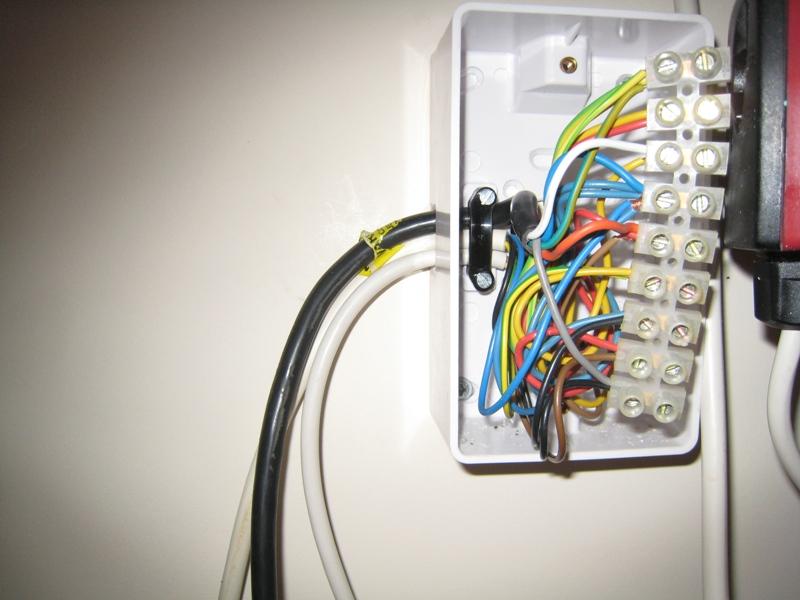

Just a quick update.
The wiring diagram for the 3-port valve shows a connection going from the boiler "no hot water" terminal to the junction point of the orange wire. It says this is needed for CH only, although I can't see why.
However, this is not connected on my system (see picture below). AFAIK this has never been connected, but is it possible the previous valve didn't need such a connection, but the new Drayton valve does?

Check the following:
1. The CH Out terminal of the built in timer connects to room stat Live
2. Room stat Switched live connects to valve white
3. The DHW Out terminal connect to cylinder stat Common
4. Cylinder stat Call connects to valve orange and boiler Sw L
5. Cylinder stat Sat and DHW OFF Out connects to valve grey
no it goes to the grey wire Chris not the orange and needs to be connected,yours is not and is the reason you can not have CH on on its own

I'm pretty sure, yes. The valve moves to the correct position, but the boiler locks out immediately.
So the bottom line is that without the DHW off connection there's no way it can work properly.
I can't see why (or how) the plumber would have removed this, so I wonder whether the original installation was a bit of a bodge job (it was a new build but I guess that doesn't necessarily menay anything!), and when the plumber replaced the valve and wired it correctly in the wiring centre the bodge was removed!
It always appeared to work before, but I wonder whether it was bodged so whenever the CH was on, the HW was as well. That's all I can think of, really, as we probably wouldn't have noticed this.
If I could re-instate this bodge so the HW's always on when the CH is that would do for me. Running an extra cable from the boiler to the airing cupboard so it would all work perfectly would be a real PITA and something I really don't want to do!
Chris
hi chris
it probable it has been a bodge from the start and you always had to have hot water on with central heating
difference now is the plumber who changed the valve has bodged it up even more and has wired it so the boiler is getting "backfed" via the pump live connection and detecting this as a pump wiring fault and going into lockout (he's probably connected the pump, the roomstat return, and the boiler pump connection together)
its hard to see from your photos where the pump core colours are connected can you elaborate? the pump live should be connected to one cable only and that will be none of the valve connections
also where do the two flexs going to the boiler connect to?another connection box? as they must join on to the threecore mains cables coming into the wiring centre somehow
