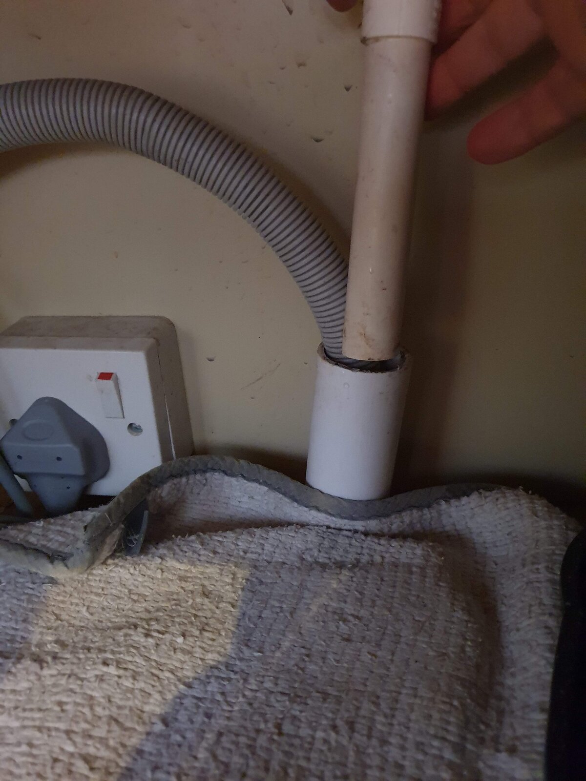

Dishwasher fitter has put the outlet from the machine into the main outlet pipe also used by the central heating, dislodging the boilers outlet pipe. Seems to be a standard 22mm plastic pipe and seems a push fit connector with some more pipe would work although I'm not sure both would fit.
Perhaps some rubber tubing and a jubilee clip would work. Any suggestions?
It is supposed to be a loose fit .Will the waste pipe not lift up..
The fitter shouldn't be touching anything to do with the boiler. I'd be having a word with him about that.
Just get a self cutting outlet kit and attach the drain hose to that.
th
They won't both fit in your your upstand. I'd say your installer is at fault.
A slightly bodgy solution would be https://www.ebay.co.uk/p/14009752780
Madrab's solution is more elegant.
