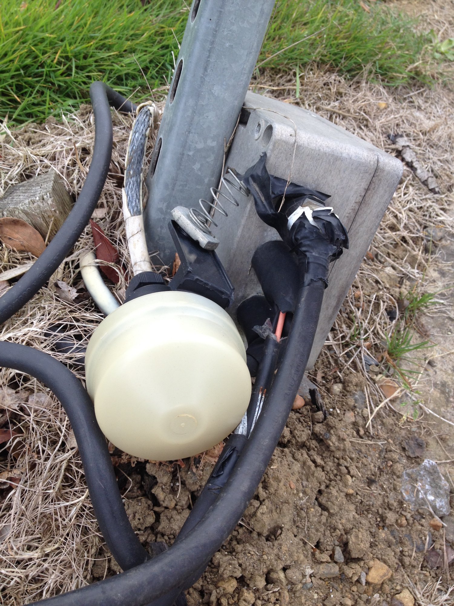

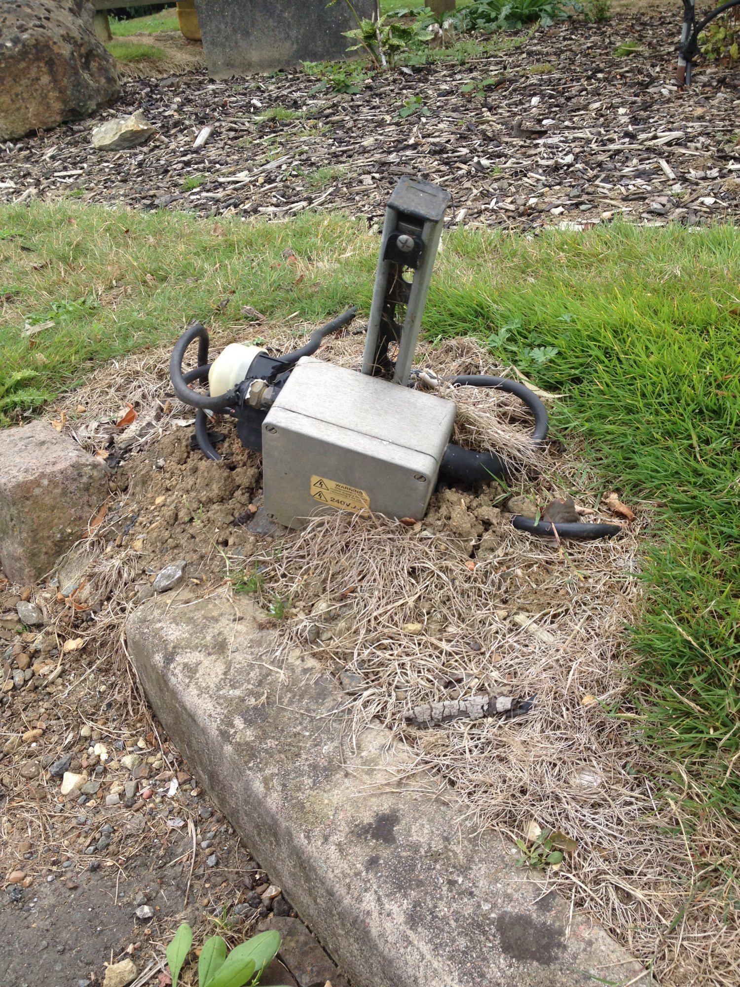

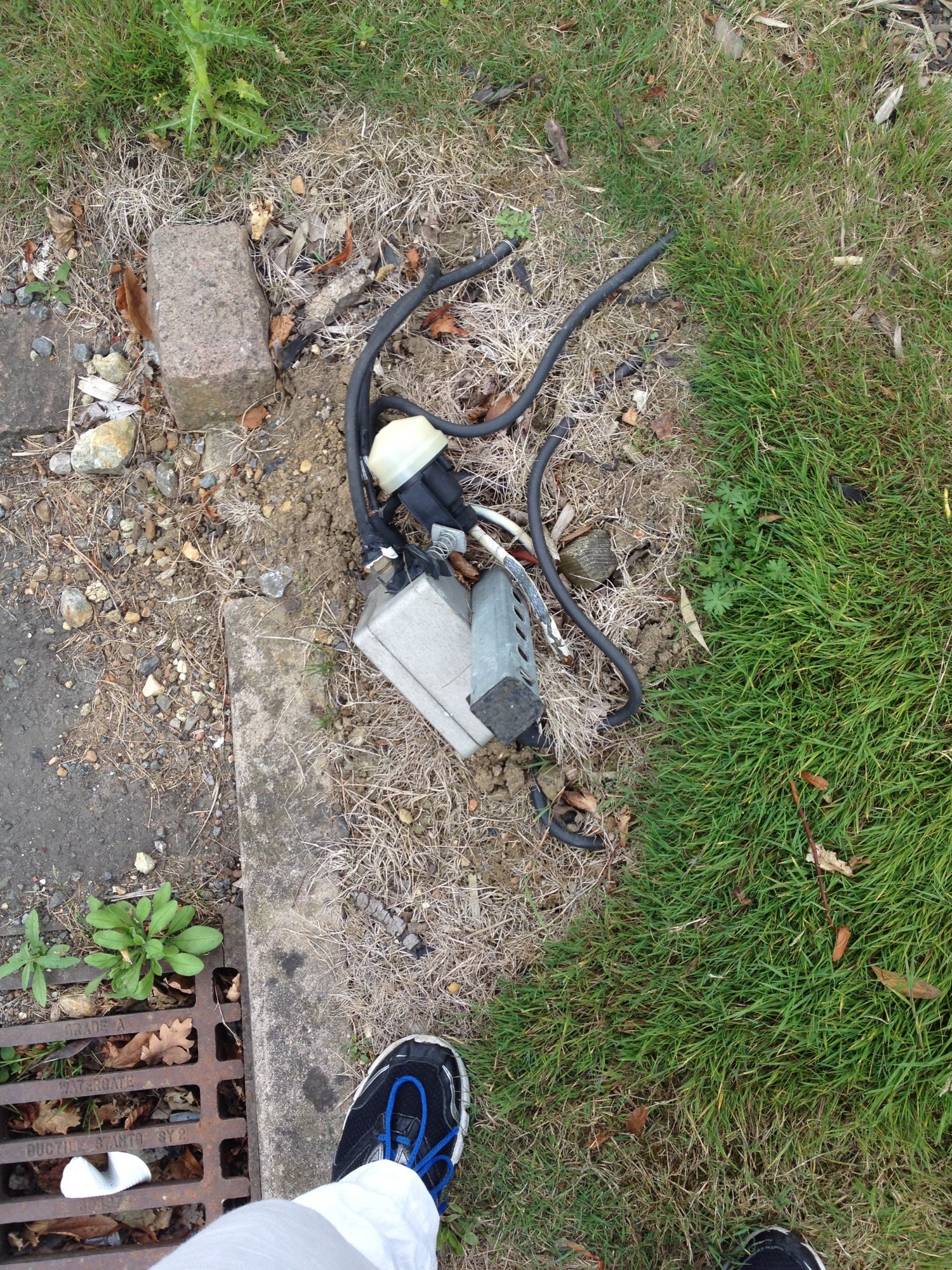

At the health club I go to (the same one with the odd looking IP CAM), outside the main entrance what backs on to a main road, there is this electrical mess.
I am wondering if it is still live and being used to turn on the surrounding bollard/sign lights at dusk, or whether it has been left there from a old installation and is in fact dead. Been like it for a while IIRC, Maybe I will bring my non-contact voltage detector next time?

Good idea flameport, but I really hope it's dead with the state that it is in.
I suspect it was a very neat job once.
It amazes me how things get damaged like that, and more importantly, get left like that.
Have recently been involved in a similar job, where an intact installation suddenly gets yanked about by a groundworker, breaking the plastic enclosure and pulling the SWA out of the gland. Next thing I know, ground block paved, and an armoured cable now too short to reach it's broken enclosure.
I wouldn't mind betting the installation in your pic is live.

The presence of some PVC tape suggests that someone has already become aware of at least part of the problem, but has not made any serious attempt to fix it properly.

It's surely been hit by a car to cause that. We could probably debate whether mounting it like that so close to a car park was a good idea regarding suitability for the likely conditions. Being hit could have been forseen given it only needs one driver to drive over the grass!
Whoever repairs it should bring the pole up to eye level at least as a marker for future reversing drivers!
You can see the broken plastic bracket where the photocell was originally.
we do pubs and see stuff like that all the time, we even put cages over the lights and often see them run over, as well as people kicking them for fun, or just the gardeners bashing them about with there mowers
