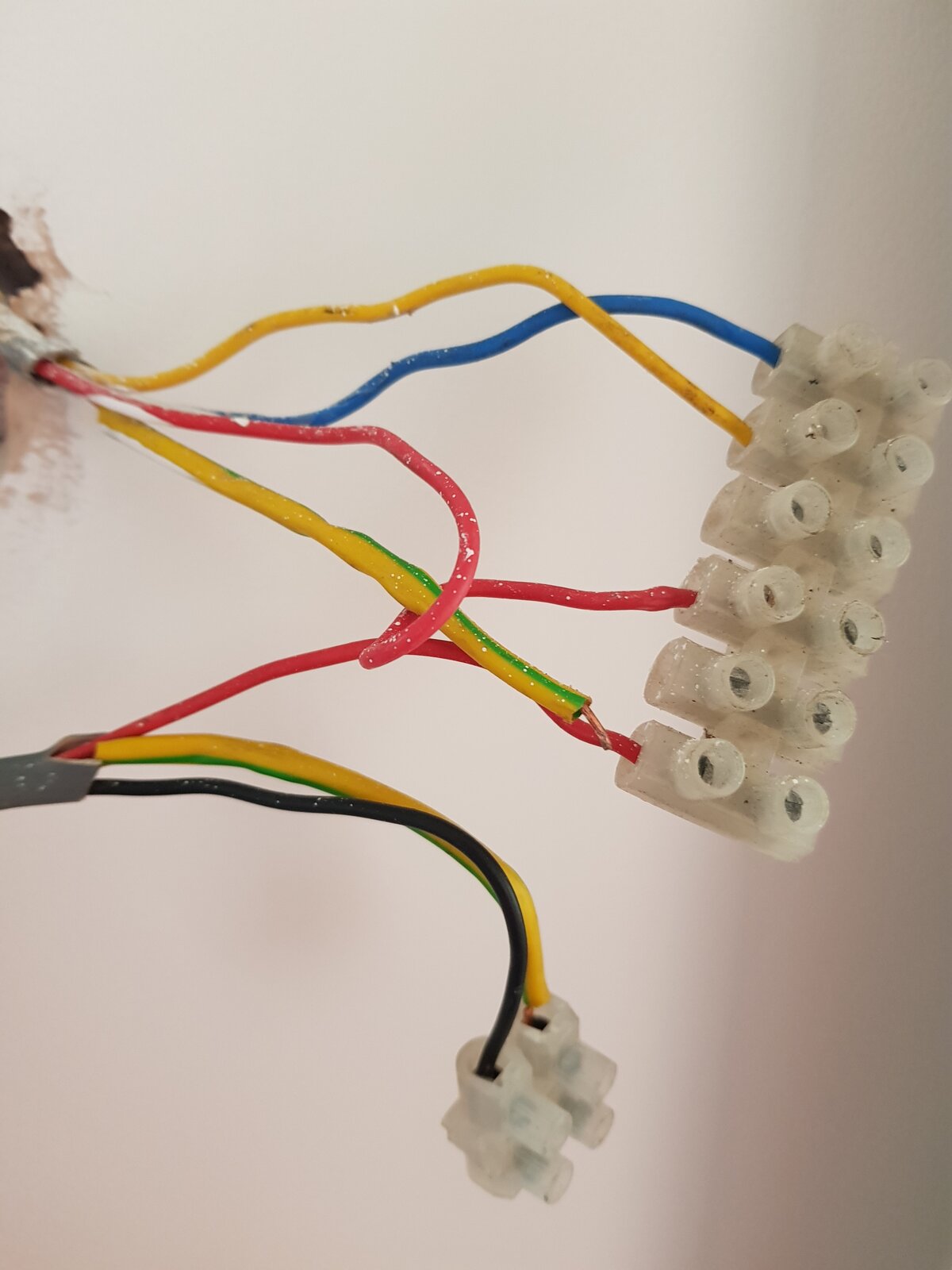

Hello, I've taken the 2 gang switch off and I took a picture of the wiring but I can't believe it but the picture has vanished and I'm a little stumped. Could some one please advise on the wiring for the 3 gang one way light switch?
I have 2 cables to connect to it, one 3 core from a single light - red black earth.
The second cable is 4 core for the hall light and outside light - red yellow blue earth.
These lights are not controlled by any other switches, just these.
Any help appreciated.

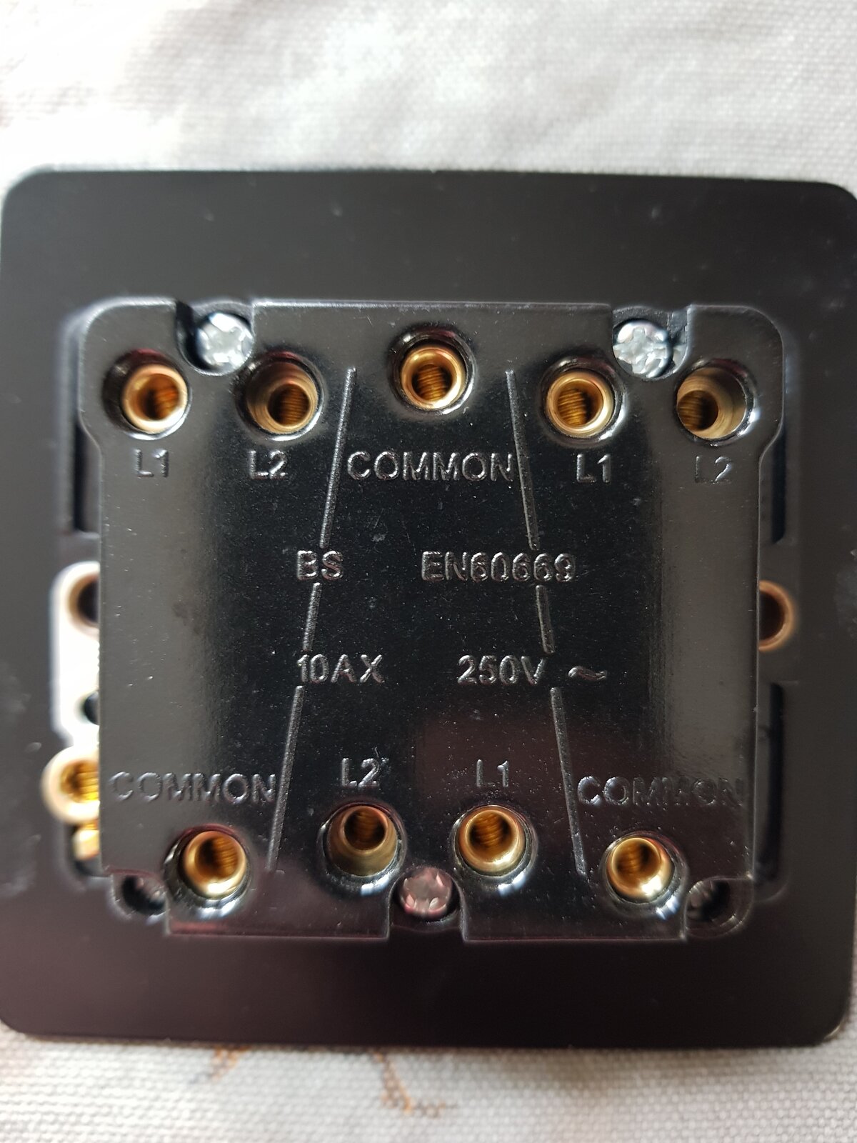

Show us a picture of the cables at the switch position ,and a pic of the back of the new 3 gang switch ( clearly showing the terminal identifications).

On your original 2 gang switch ,was there a short piece of wire joining across the two gangs ?
Can you safely work on live circuit with your meter to establish voltages present at the red ,blue ,yellow conductors of the 3 core and earth ? One of them should be permanent live.
Hello, yes there was a joining piece of wire, and the red seems to be the perm live on the 4 core cable.
Referencing your pic of switch from left to right..
Put red into common on far left gang ,and a short bridge wire with it ,connect the other end of bridge to common terminal on middle gang.
Put yellow into L1 of left gang and blue into L1 of middle gang.
The far right gang will be for your twin and earth cable ( cupboard light ??). Put red into common and black into L1 on far right gang.
All earth conductors to be sheathed yellow/ green sleeving ,and connected together into the switch plates earth terminal .
Before doing any of the above isolate the supply and prove all conductors dead .
