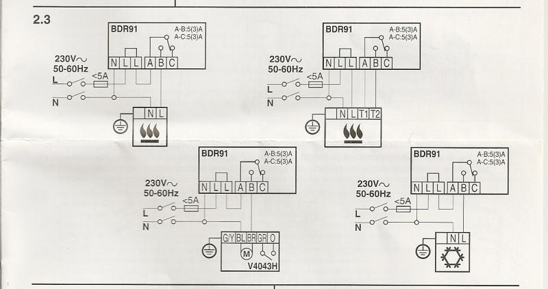

I have "phoned a friend" who said that
1) Brown live goes to first L
2) Then a 1mm wire loop needs to go from L to L
3) Then a 1mm wire loop from second L to A
4) Then the black switch goes to B
I dont understand about the strange link from A to C as shown in the diagram below (which hopefully I have attached but it doesnt seem straight forward to me to load it)

That's not correct.
At the moment, the brown wire is fed from the CH ON terminal of the Drayton timer. So it is only live when the heating is ON. The connection to the relay L terminal must come from a permanent Live supply.
The correct wiring is:
L - Permanent Live
N - Permanent Neutral
A - Timer CH ON
B - Boiler
I don't understand about the strange link from A to C as shown in the diagram below (which hopefully I have attached but it doesn't seem straight forward to me to load it)
That's a two-way switch. It means that A connects either to B or to C. B is used for heating applications; C for cooling. So you can ignore C.
