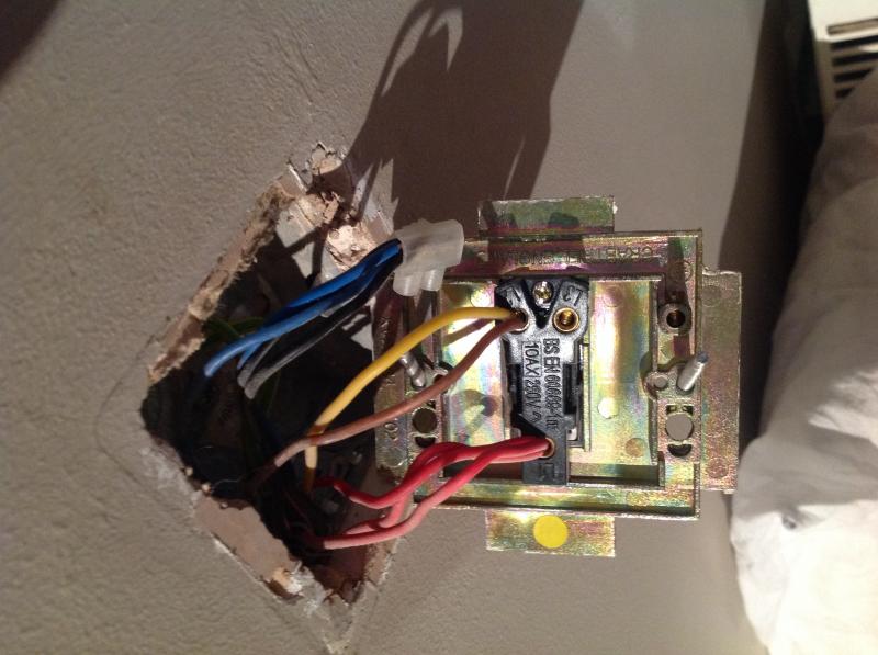

I have a light on a one gang, one way switch which controls 5 halogen spots in the ceiling. I would like to add a wall light which can be independently controlled from a new two gang switch.
Let's assume I am OK with running cable through the stud wall and fitting the wall light, my concern is how to wire up the new two gang switch (not purchased it yet).
The existing one gang switch it is wired up like this:
L1: 3 x red wires
L2: 1 x brown and 1 x yellow wire
L3: empty
Also 2 x black and 2 x blue wires connected in a terminal block.
(See picture below).
Please can someone guide me as to how I should connect the wires that will power the new wall light?
Thanks in advance
Assuming you haven't run a new cable between the switch and the wall light;
Put all the reds into any of the two common terminals of the new switch. Ensure there is a short length of red or brown wire linking both of these common terminals.
Put the existing brown and yellow in one of the L1 terminals.
Put the new brown in the remaining L1.
Connect the new blue to the neutral block (the block with the existing blue and black wires).
Connect earth to the earth terminals. If switch is metal ensure faceplate is properly earthed.

That existing metal faceplate is not earthed.
You need an earth wire linking the faceplate to the back box, where the other earth wires are.
Or, connect all the earth wires to the metal faceplate, with a link from the faceplate to the back box.
Either way, make sure every wire gets securely connected, as they can slip out.

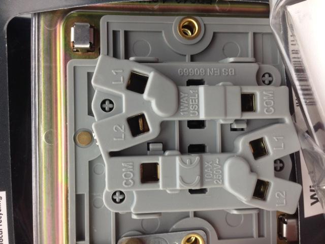

So I have just bought a 2 gang switch and it has a pair of L2 terminals also.
Can I simply pretend they aren't there and wire up as per sparkwright's post using only the COM and L1?
