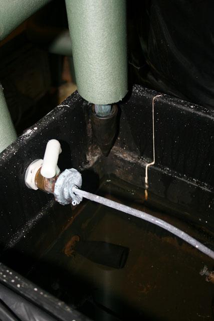

good evening 1 n all. can anyone please advise where to place "bungs" and what the "bungs" actually are? any other help or suggestions would be much appreciated. hoss55
It is unlikely that plugging the feed & vent would stop you getting very wet, as this method when you open one connection on a system, unfortunately you will have to open up three, thereby breaking the vacuum that is vital to stop the water pouring out, so either use a freezer kit or drain down I would advise the latter ;)
If you are asking about bungs and where to put them i dont advise you do it.....
Just drain down enough until the water level is below your 3 port....last one i did like that was a bucket and half of water.....
That was 2 days ago.....
You should give it a go, you may find yourself pleasantly surprised!, unless the valve is higher than all the rads on the top floor I bung 2ports and three ports and never failed me yet.
I appreciate its hard to show it but trust me these bungs are holding this valve swap
Some systems have plenty of gate valves (red wheel-headed valves) fitted on the pipework leading to the motorised valve.
The other day, I changed a motorised valve by turning off a couple of gate valves, and one of the pump valves. Then undid the compression nuts securing the mot. valve, and only a small amount of water came out into a strategically placed bucket.
You may be lucky, see if you have valves on the pipes leading to the mot. valve.
thanks to everyone for all advise and suggestions. valve replaced and all working correctly. as a bonus i didnt get wet either!.only took 45 mins. (2 valves close to defective one.) only drained. 1 1/2 buckets off
