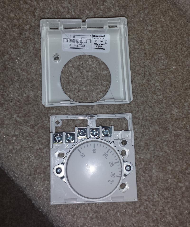

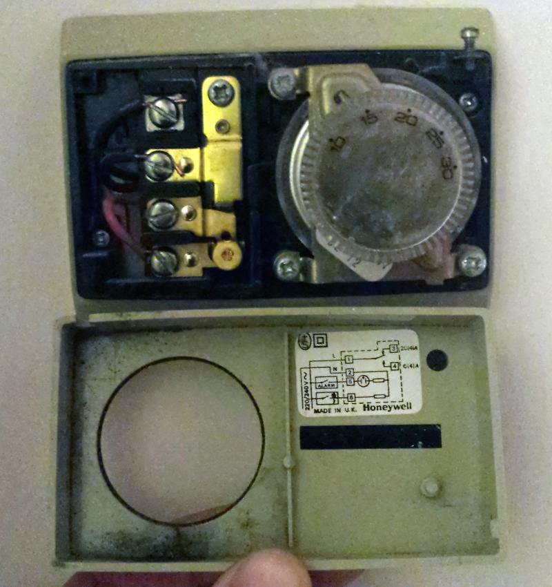

Hi all,
I'm about to replace a faulty (old) thermostat in hallway.
Thought it would be straightforward switch over, but wiring diagrams seem different.
I just wondered whether someone could confirm the wiring based on the original wiring diagram.
See pictures
Old thermostat
new thermo
I'm thinking from the old one, the top wire is 1 on the new, the second is neutral (3 on new), and the old bottom wire is 2 on the new.
Any info appreciated.
thanks,
sam[/img]
No.
Second wire/neutral on old should go to 2 on new.
Old bottom wire is 3 on new.
