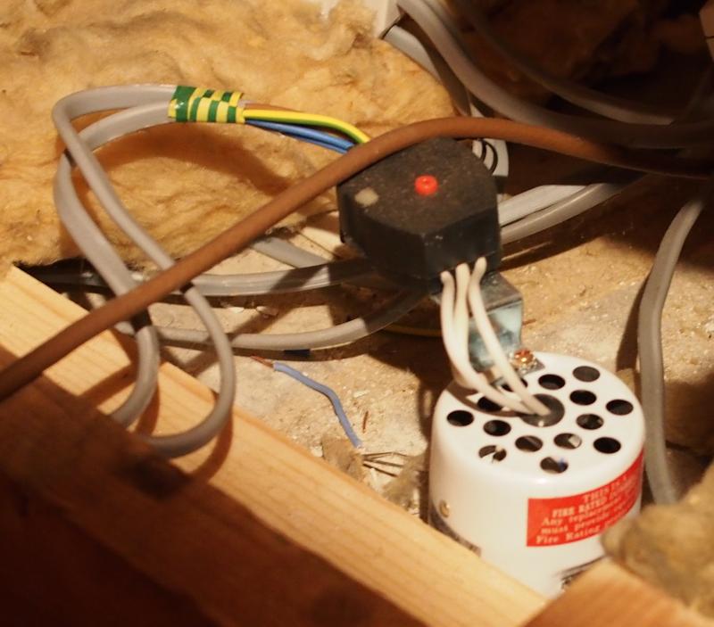

I'm trying to change the bulb in a sealed bathroom downlight - see //www.diynot.com/network/dixmy/albums/22444
The bezel rotates with much difficulty and grating. However I still cannot get inside the unit. I've turned it both clockwise and anti-clockwise. It appears to be limited in how far it will turn - perhaps a quarter turn.
Based on what I've read on the net, I suspect the bezel needs turning anti-clockwise at which point it should just pop off. I've also tried gently pulling but it doesn't want to come apart.
Can anyone tell me what I need to do to just change the bulb. Thanks in advance.

It looks like a 230V GU10 lamp,
But yuou still need to separate the front bezel from the lamp housing to get at the lamp.
Its usually a small turn, ir a prise with a screwdriver. Usually you should not need to remove the whole fitting from the ceiling.
PS That's horrible wiring. The whole of the cables should be INSIDE the termination box. The brown and blue wires should not be seen. If the lamp's box is too small, then a larger terminal box should be used.
And there is no strain relief on the cables.
Thanks ericmark and Taylortwocities for your help. All sorted now. In the end it was an easy job. I simply grabbed both sides of the bezel between thumb and forefingers and pulled down on one side. The bezel then easily came away from the light casing. No turning was needed.
As for the state of the wiring, I'm renting this house and plan to move soon so would like to leave it well alone. In its current state, given it is in the loft, is there any danger that the landlord should be informed about?
Its probably not dangerous per se if left undisturbed, but it doesn't conform to Wiring regulations for the reasons I outlined.
