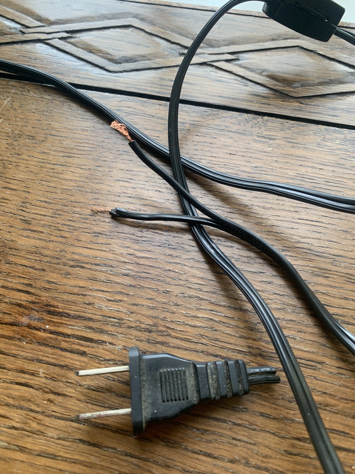

Hi everyone.
I recently bought an art nouveau style lamp from an auction . I saw it had a two pin plug with flat prongs and assumed that I could just remove it and replace with a standard uk plug . I cut the end off and then realised that it’s only got two wires in the lead and neither is coloured . After cutting the plug off I realised there are some adapters available but still not sure if one is available for this . Please can anyone advise me
If there are no metal parts that need earthing, i.e. it’s Class 2 double insulated, and the conductors and fittings are suitable in size and condition, it should be fine. The cores will be for live and neutral and should really be coloured brown and blue (or red and black, if older). It is the copper wire that conducts the electricity not the colour of the insulation. So treat one as live and one as neutral when wiring the plug.
It would helpful to post a pic to a general idea of the condition of the lamp and wiring though.

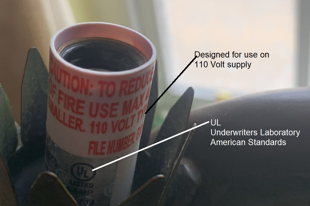

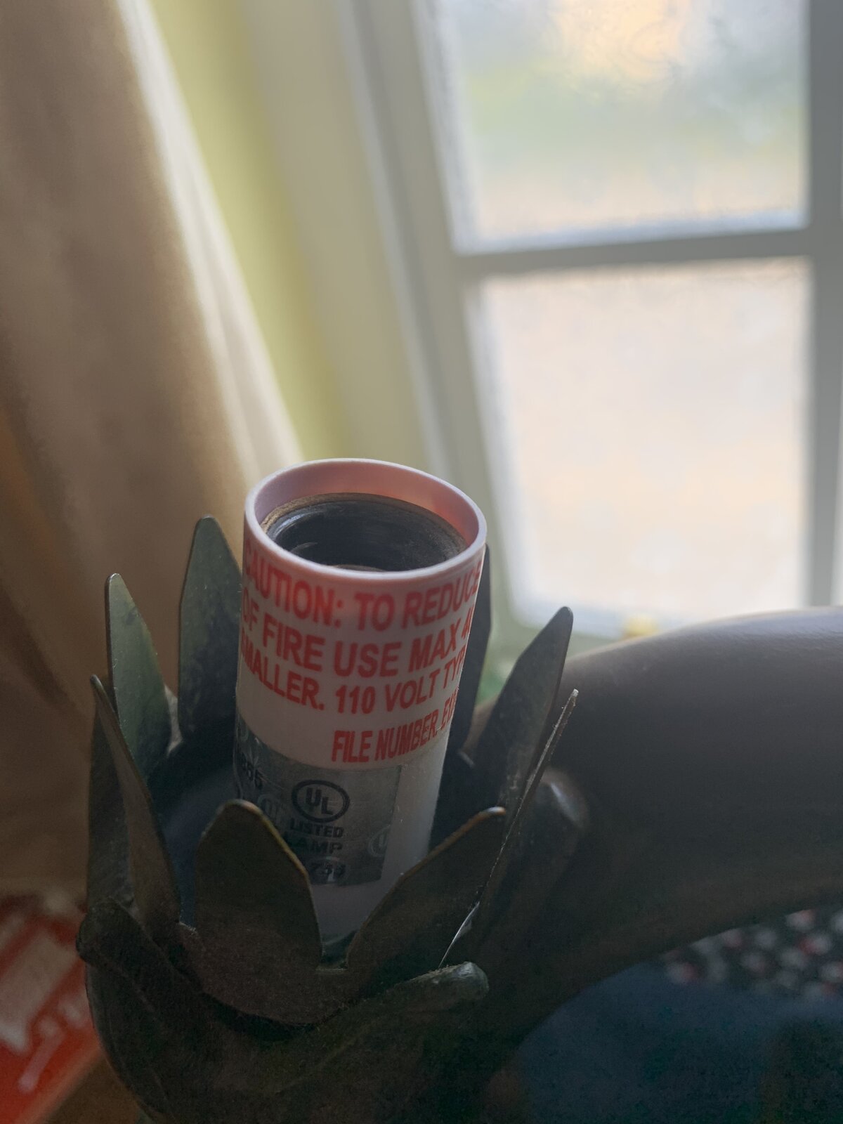

Thanks everyone . Here’s the pictures

If that is a screw in lamp bulb, then you must make sure that the live wire goes to the centre pin of the lamp holder, neutral to the threaded outer.
Hi Allisonkb,
As we've seen the pictures now, it isn't suitable for use in the UK unless you rewire and change the lampholders.
