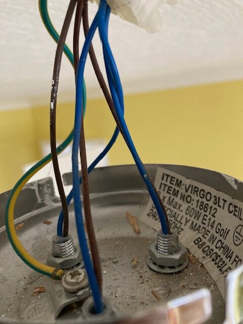

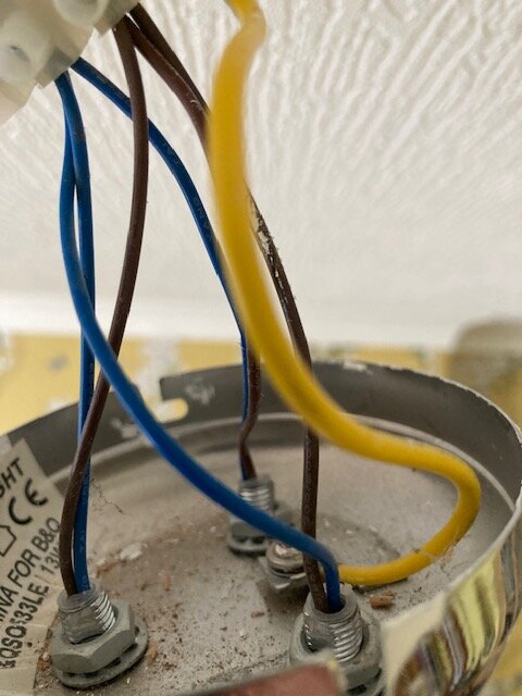

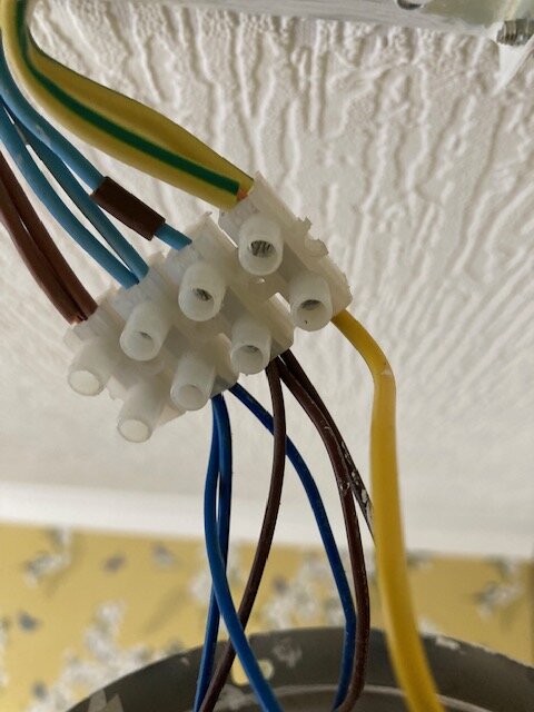

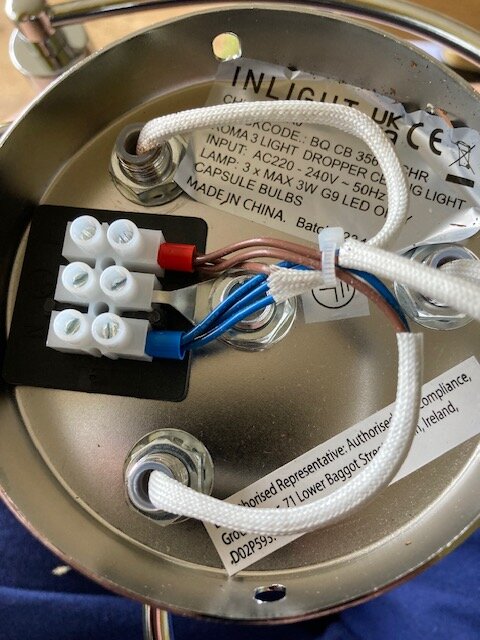

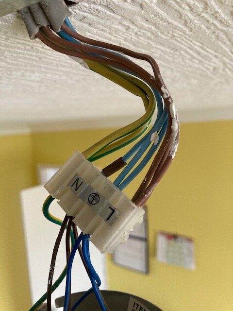

I'm replacing an old B and Q light fitting with a new one from the same source, but I'm slightly stumped.
There are two light switches in the room, one at each door, so presumably this makes the wiring slightly more complicated. So could someone please explain to me how I transfer the cables from the old fitting into the new fitting, thanks.
First four pics are the current wiring arrangement of the old fitting, and the last pic shows the connection block on the new fitting.
Thanks in advance, further pics to follow if needed.

Your old light is looped at the fitting. Your new light only has connections for switched live, neutral and earth.
So you need to keep the 3 browns connected by a wago or choc block
Your new fitting, is simply lacking in one terminal, for those joining those two red wire on the left, of your second photo. One solution would be to simply cut that one connect off the strip of 4, or transfer the entire strip of 4 to your new fitting.
Well, the previous people haven't used the "correct" terminals but that doesn't make much difference.
New light brown to SL
New light blue to N
New light earth to E
And personally, I wouldn't try and get three earths and two neutrals into that cheapo connector block thats fixed close to the edge, while holding it close to the ceiling and being constrained by the length of the cables from the ceiling (which admittedly in your case in not too bad)
I'd fit three pigtails to the fitting on the ground, then I'd just connect them to the existing connector block (or some wagos replacing it), a bit of care is needed to dress it nicely into the base (don't just jam it up and hope for best) Offer it up to the ceiling and dress the cables and blocks so they they lie flat and don't fowl the centre fixing, If you need to separate the four blocks then do so.
That doesn't really have an impact here. The "normal" way to implement "two way switching" only impacts the wiring at the switches.
Your fitting has a normal "loop-in" wiring setup. The only thing that is a little confusing is that the label stuck on the terminal block bears no relation to what the terminals are being used for.
The brown wires coming from the ceiling are the permanent live (aka "loop"). They connect to each other but not to the wires from the light fitting.
The unmarked blue wires coming from the ceiling are the neutrals. They connect to the neutral wires from your light fitting.
The blue wire marked with a bit of brown sleeving is the switched live, it connects to the live wire from the light fitting.
And the green/yellow wires are the earths.
In all honesty, it took me a while to work out what you meant by “pigtails”. Having done so, a plan is starting to take shape, thanks to you guys. I’ll cannibalise the wires from the old light fitting to the existing block to make those pigtails , and as you suggest connect them from the rather lightweight terminals on the new fitting to the existing block or a new one.
If there’s anything wrong with that strategy please let me know.
