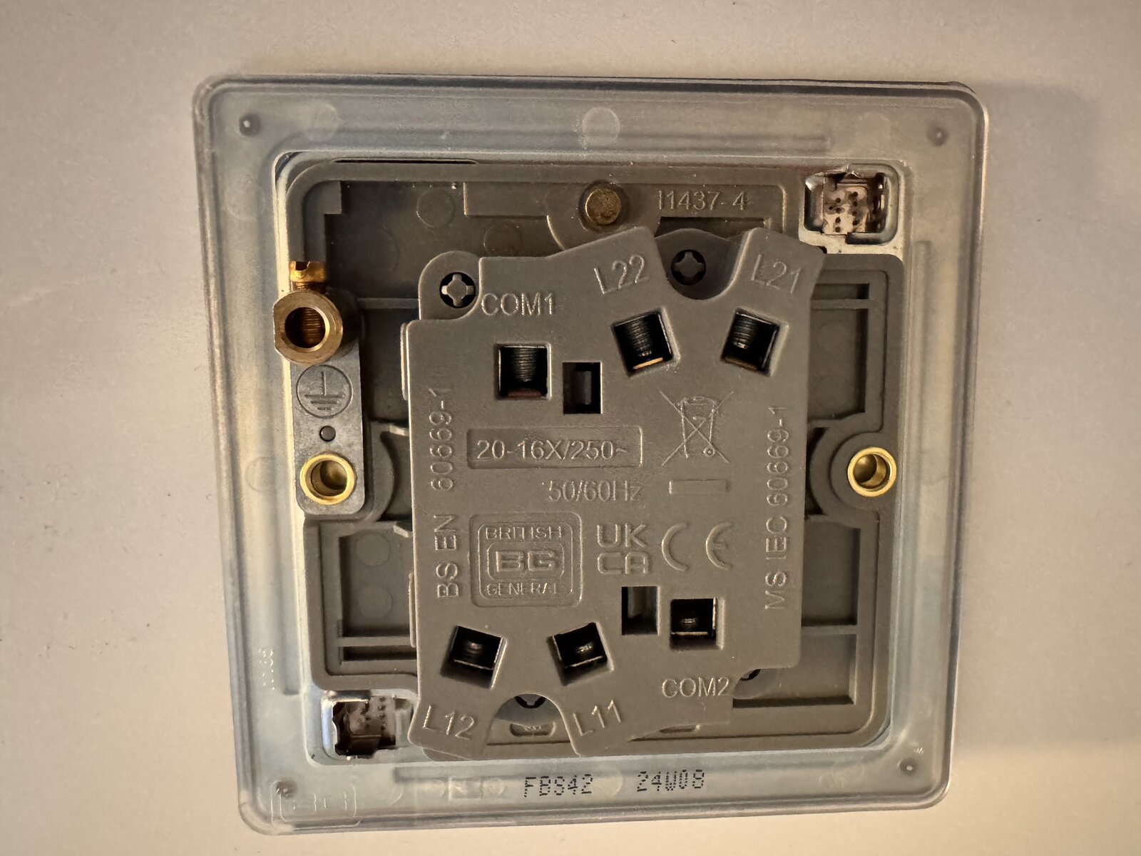

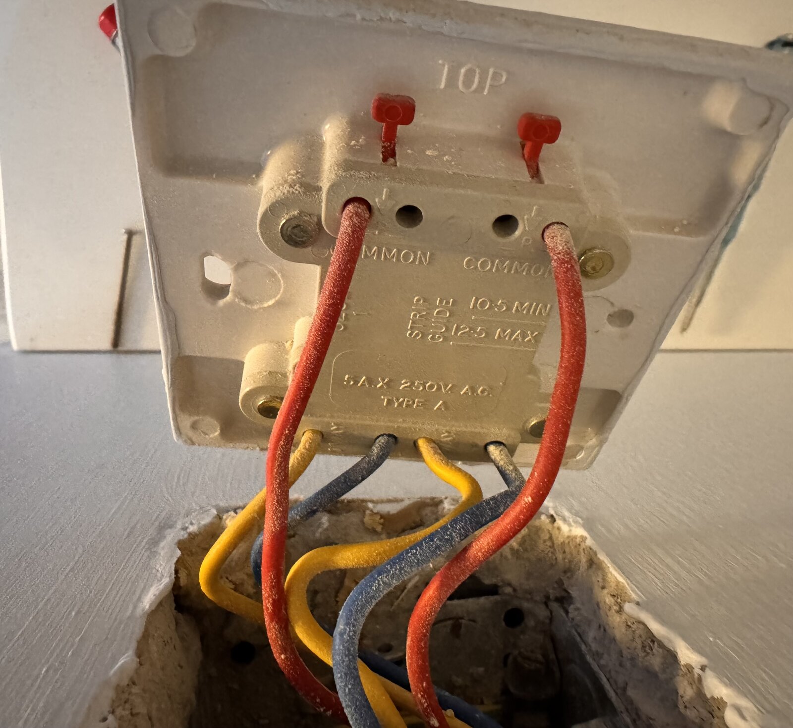

I’m trying to change this old Crabtree 2 way switch to this newer 2 way, and I’m confused with the wiring. I have the same switch upstairs on the landing too. The old switch has 2 commons at the top, and at the bottom it just say 1 way for both sides where the blue and yellow wires are?
What would be the correct wiring for the new switch please?
