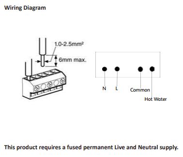

I am a novice with regards to central heating systems but have managed to change like for like parts on my system in the past..... However, I'm a little stuck with my latest task. I'm looking to replace my cyclinder thermostat which is a Drayton HTS3 for an electronic dual cylinder thermostat. (Model DDS1). I was hoping it would be a like for like with regards to the wiring......
My current Drayton has just 3 connections being live, neutral and common.
When I wire into the new DDS1 thermostat with the same 3 wires being live, neutral and common I have a problem. Basically it seems to constantly call for heating from the boiler and will not switch off.... I don't know how to make it only call for heat when requested from the timer.
I'm not sure if this thermostat is compatible or if it is simply my lack of knowledge now showing and I'm missing something obvious.
(The new thermostat has extra ports being NC and NO which the Drayton does not)
To help further, my current heating setup consists of a 3-port valve, and a tado smart room thermostat and hot water timer downstairs.
Any help would be massively appreciated. Thanks.

As above, you do not have a neutral at your old stat; you have 3 live wires, and the stat connects com to either no or nc (normally open / normally closed), depending on whether the cylinder is cold or hot.
Your new stat requires these connections, and also requires a permanent live and neutral. So you will either need to run an extra cable, or replace the existing cable with (at least) 6 core (l,n,com,no,nc,earth) flex.

But I am a bit puzzled, because the wiring diagram I found for the DDS1 is as below:
But doesn't match your description:
The new thermostat has extra ports being NC and NO which the Drayton does not.

Common or Com, the third wire will be a switched live supplied from your time controls.
Then if the new thermostat requires a permanent Live and Neutral, as per echoes post above, this will need to be added by connecting the L & N to the same fused spur supplying the boiler and the rest of the heating system.

Thanks for all the help and advice. I now have a better understanding so will taken a look at the existing wiring. I think I might just need to add a permanent live and neutral to my existing wires..... just need to figure where from!?
It seems with my lack of inderstanding that I had incorrectly thought that two of the three existing wires were a permanent live and neutral which is how I wires them into the new thermostat. I think this now explains why it was constantly calling for heat!!
