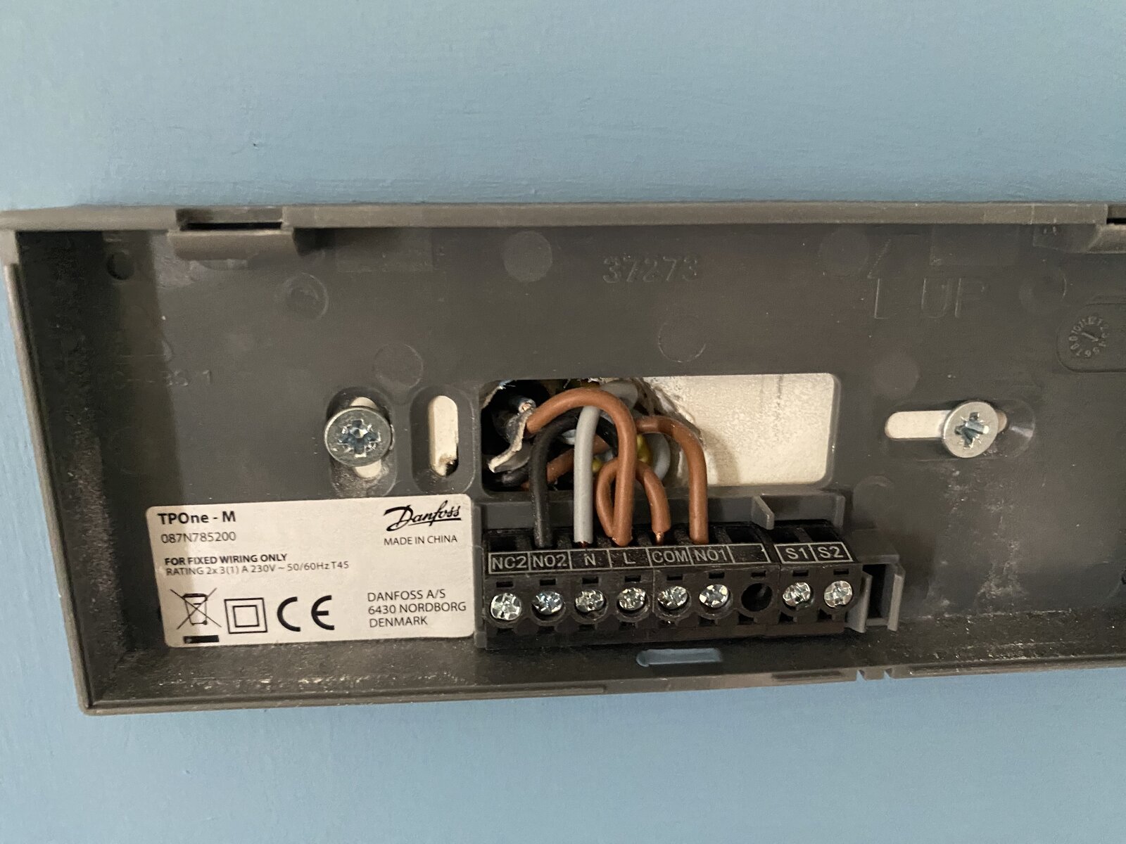

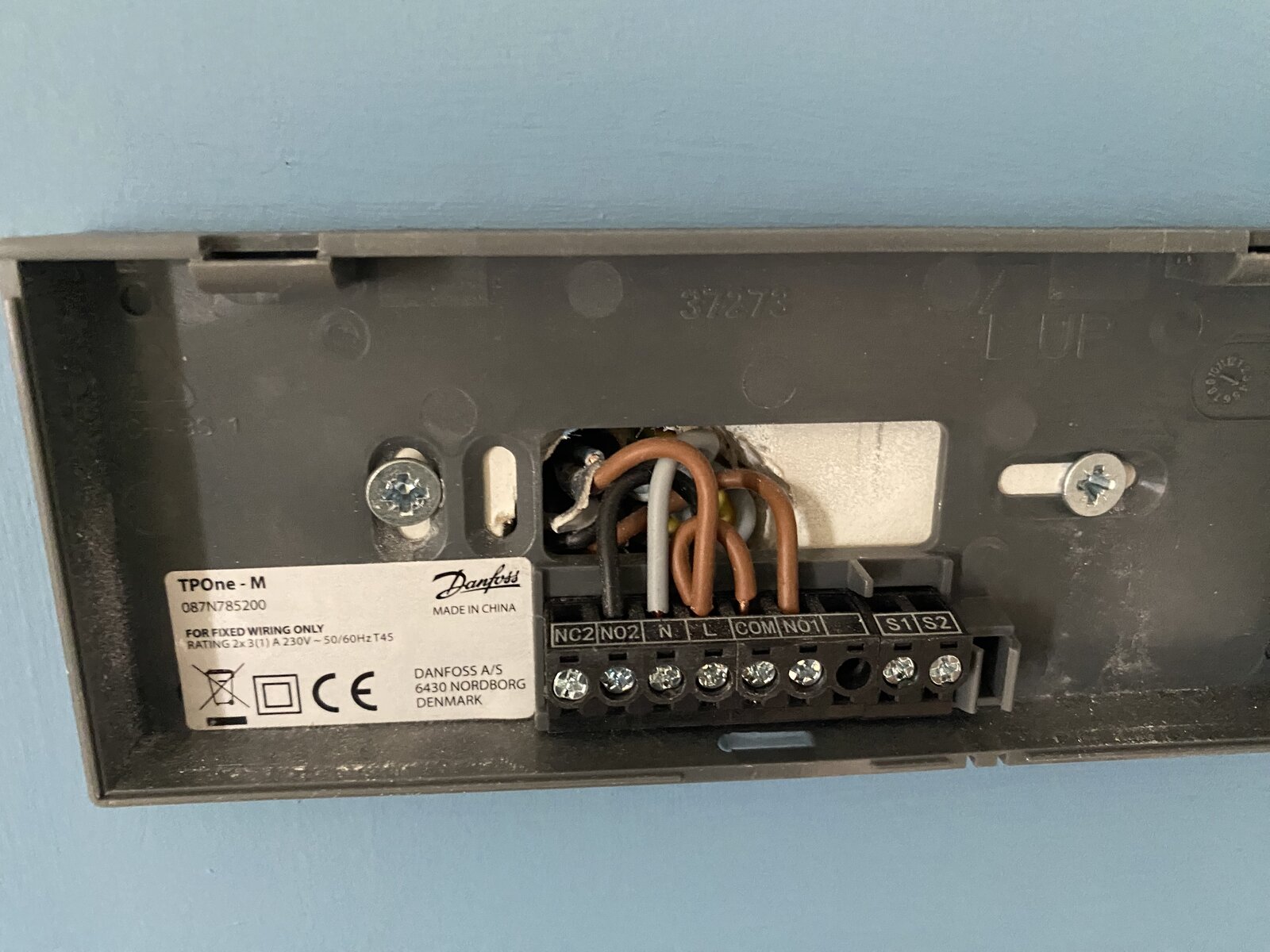

Hi can some one help with wirering combination to nest plz.
Hi,
Danfoss to Nest:
L to L
N to N
Link L to 2 and 2 to 5
NO1 to 3
NO2 to 6
