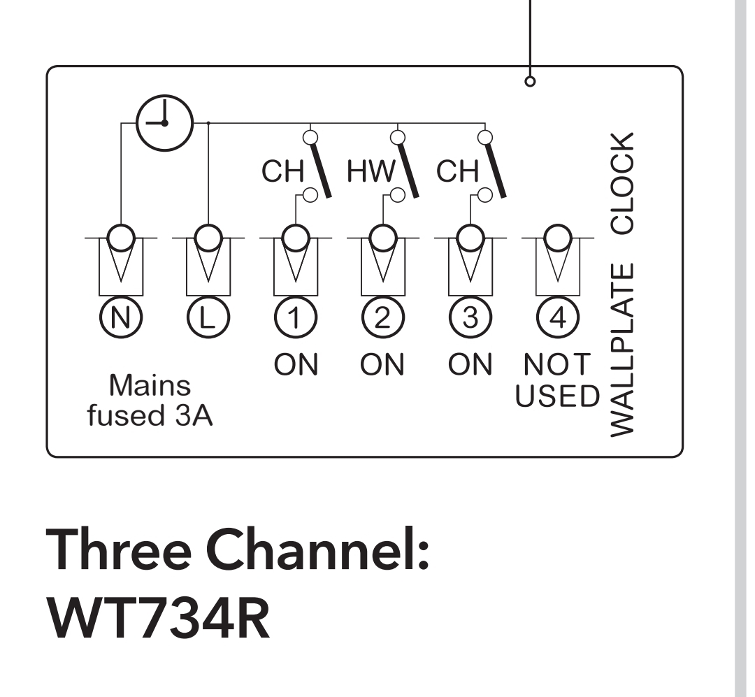

Ok so our set up is
TP9000 in the Hallway and the TP5000 almost back to back with it in the living room.
So wiring wise I think I'm ok with the TP9000 and replacing the plate to the included wiser one.
I have had a look at the wiring and have Live, Neutral and a wire on 3 and 4 for the heating a water.
Which I will need to change for the new plate and the wiser.

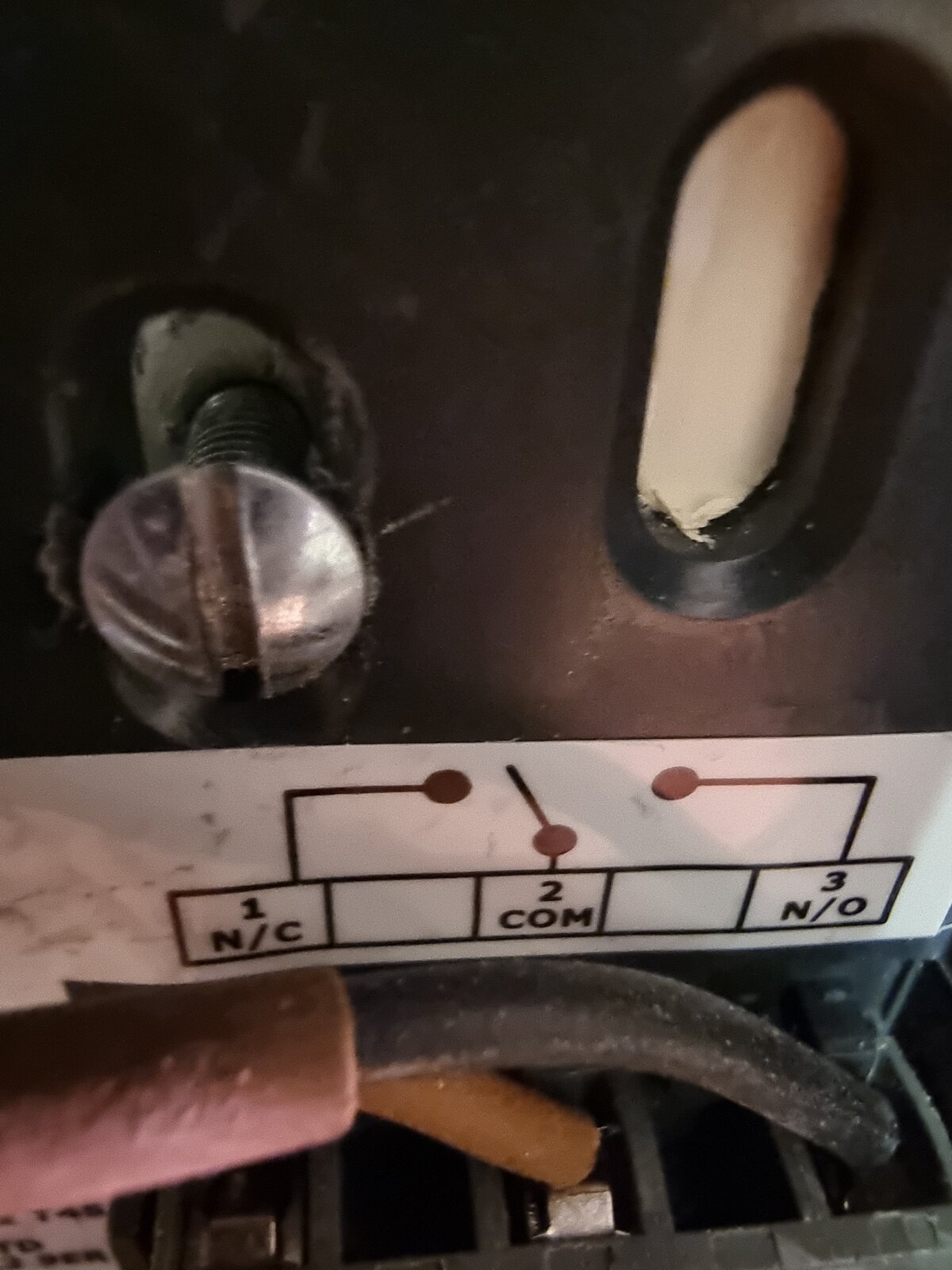

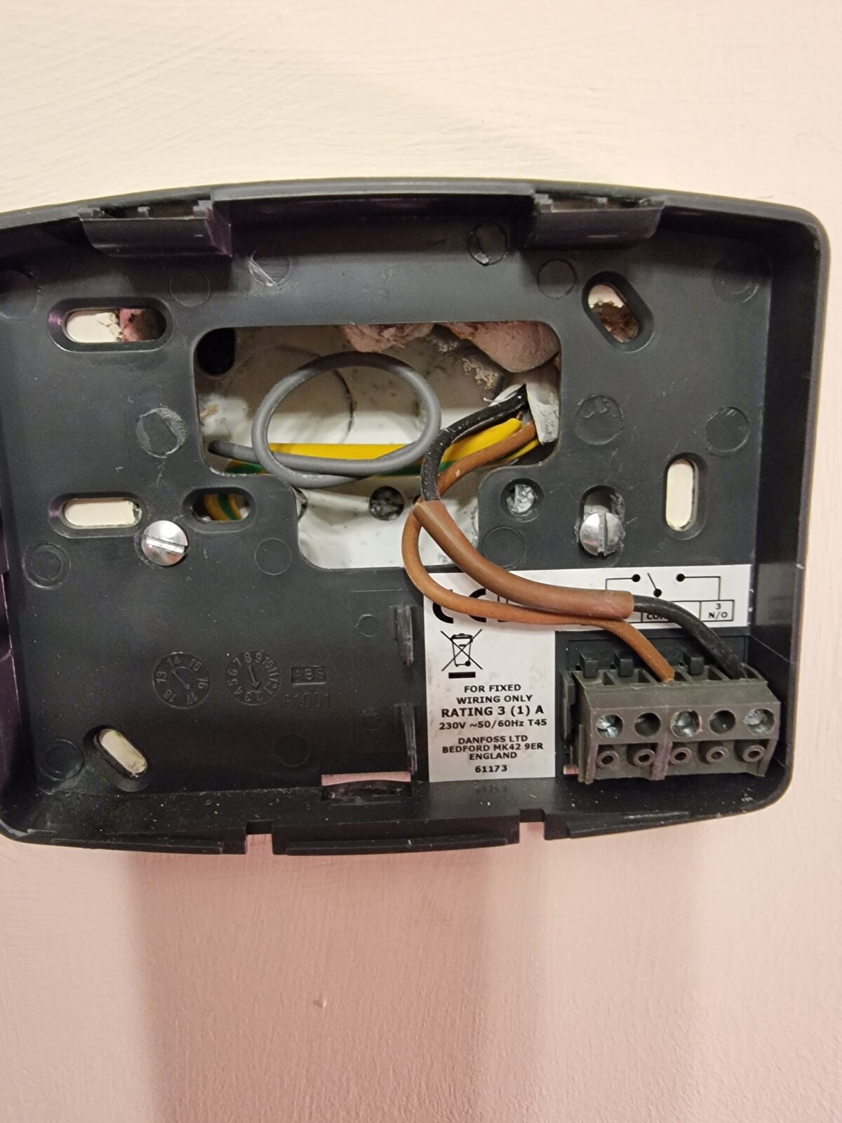

My main query is the TP5000.
I've not had this off as yet, but assume it will be a 2 wire affair with possibly another L and N.
I think I will need to extend the wiring for this from the existing wires to reach the Hallway Plate so it can be wired in to the Wiser Plate
My questions are -
of the wires in the TP5000, which will I need to extend ?
If there is a L and N also do I need to use these too or will the L and N in the TP9000 be sufficient to close the Living room circuit or is the L and N purely to power the TP5000, so will not be needed and can be terminated behind the living room wall plate.
