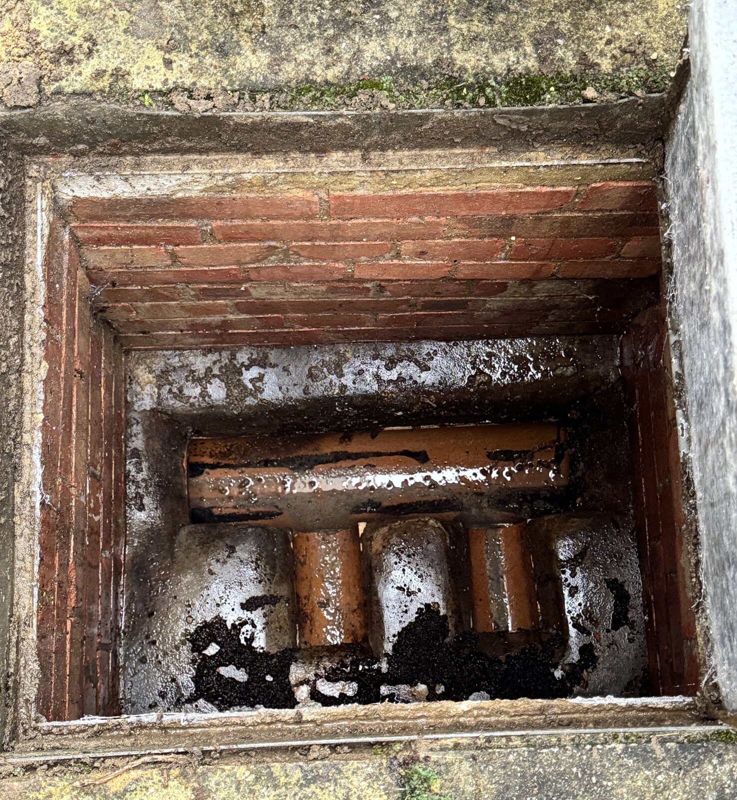

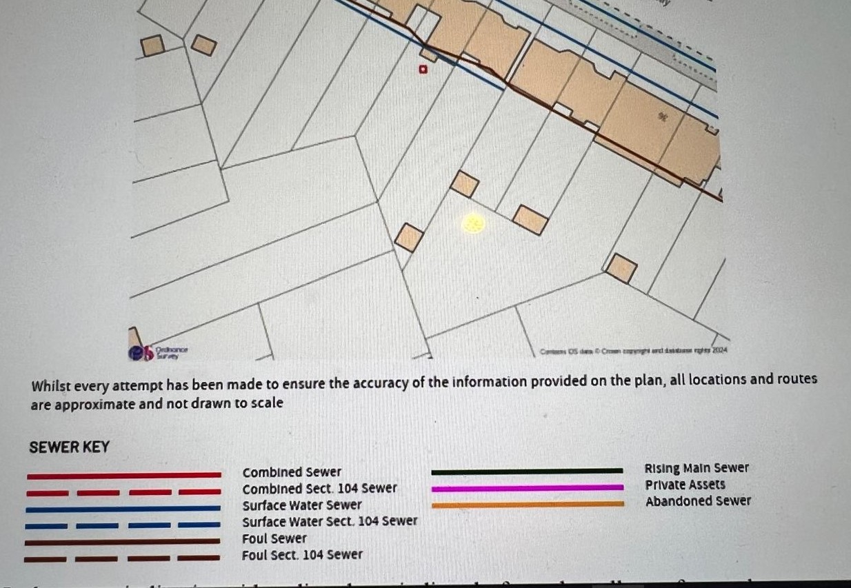

They are looking to do a double side and rear extension. On the drainage survey (attached my house has the red square), it is showing both a foul sewer and surface water sewer running through my property with a manhole currently behind the garage to the side of the property (where the two lines meet). The buyers have spoken to an architect and drainage specialist (both of which have not been site, only looked at the drawing attached) and said that owing the "change of direction of the foul sewer", Thames Water may or may not approve moving the sewer and if they do Thames Water will insist on using their own approved builders and then the cost will be prohibitive - at least £60-70K. I have checked with another builder who came on site and checked the manhole (see pic) - his opinion was that there is no change of direction on my land/property and therefore the diagram is likely to be incorrect and to move the drain to the patio area would be max. £8-10k - he's worked a lot in the area and moving a manhole is common - he's not yet heard of a single time that Thames water have denied an application. The buyer unfortunately, doesn't believe my builder and doesn't have any definitive evidence to show that he can move the drain to the patio. If he can not do the side extension, he is not interested in the property and therefore, will pull out which is obviously hugely frustrating.

Is it a private sewer or joined to your neighbours?
Thames water have a department that you would need to talk to and we find them to be helpful but you’ll need detailed drawings of the extension, the sewers complete with dimensions.
Need to speak to Thames Water, they're the only People who can give a definitive answer. They have rules and regulations around building over/near to Sewers and other assets, it would be too risky to try and second guess what they may want.
Without being on site to plot directions and depth of any sewers, it is impossible to say what exactly would need doing and the cost. There are many factors also to take into account, if the sewer needs moving, will it be possible to get the required/sufficient fall over the diversion route, are any third party properties going to be affected, etc, etc.

There should be sufficient fall and no other third party properties are affected.
The photo shows that the foul sewer is in a straight line. The diagram is therefore incorrect. I’ll speak to Thames Water to how this can be redressed. Hopefully that will be enough to give the buyer comfort.

How do you know that without knowing the inverts above and below the run of drains through your property? The manhole will need to be moved to outside of the footprint of whatever extension is built, that's likely to involve digging up the neighbours gardens to enable that and they may need additional manholes in their property's too. The cost is a red herring but it could be quite impractical. The map is not very helpful, it might be more helpful if you sketch out exactly what is going on.
Hi,
I’m no expert but this is what the builder has told me. They can redirect the drain on our site.

I spoke to Thames Water and they didn't seem to think it would be an issue.
Have gone back to the buyer.
