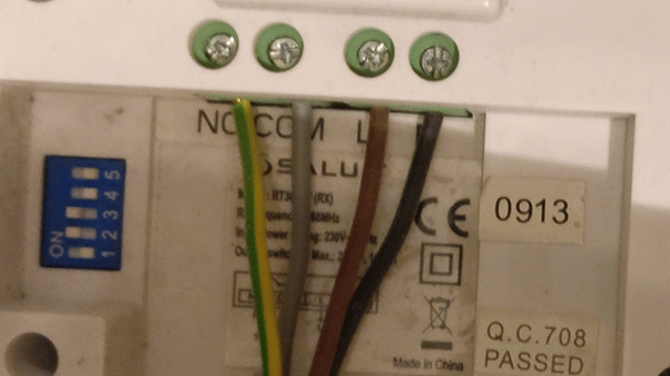

Just need to confirm that this will work before I buy...
I have one cable coming out of my Baxi Platinum Combi 28 HE boiler into a Salus RT500RF receiver. I want to install Hive so is it just a case of L to L, N to N, Earth to Earth and COM to No1 on the Hive? I would imagine that I would need to leave the boiler in a permanently ON state on the manual timer?

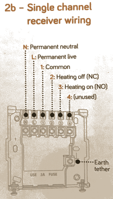

No you have got it wrong, what you are calling the earth is because you are going by wiring colour , never do that on heating wiring , it means absolutely nothing
L to L
N to N
Grey wire in Com to 1 on hive
what you call earth to 3 on hive
you dont have or need an earth

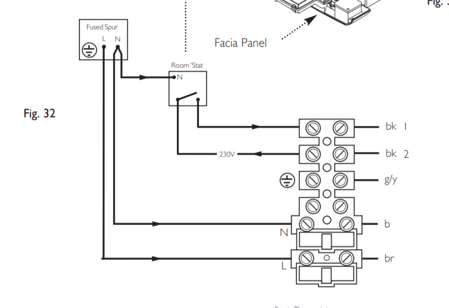

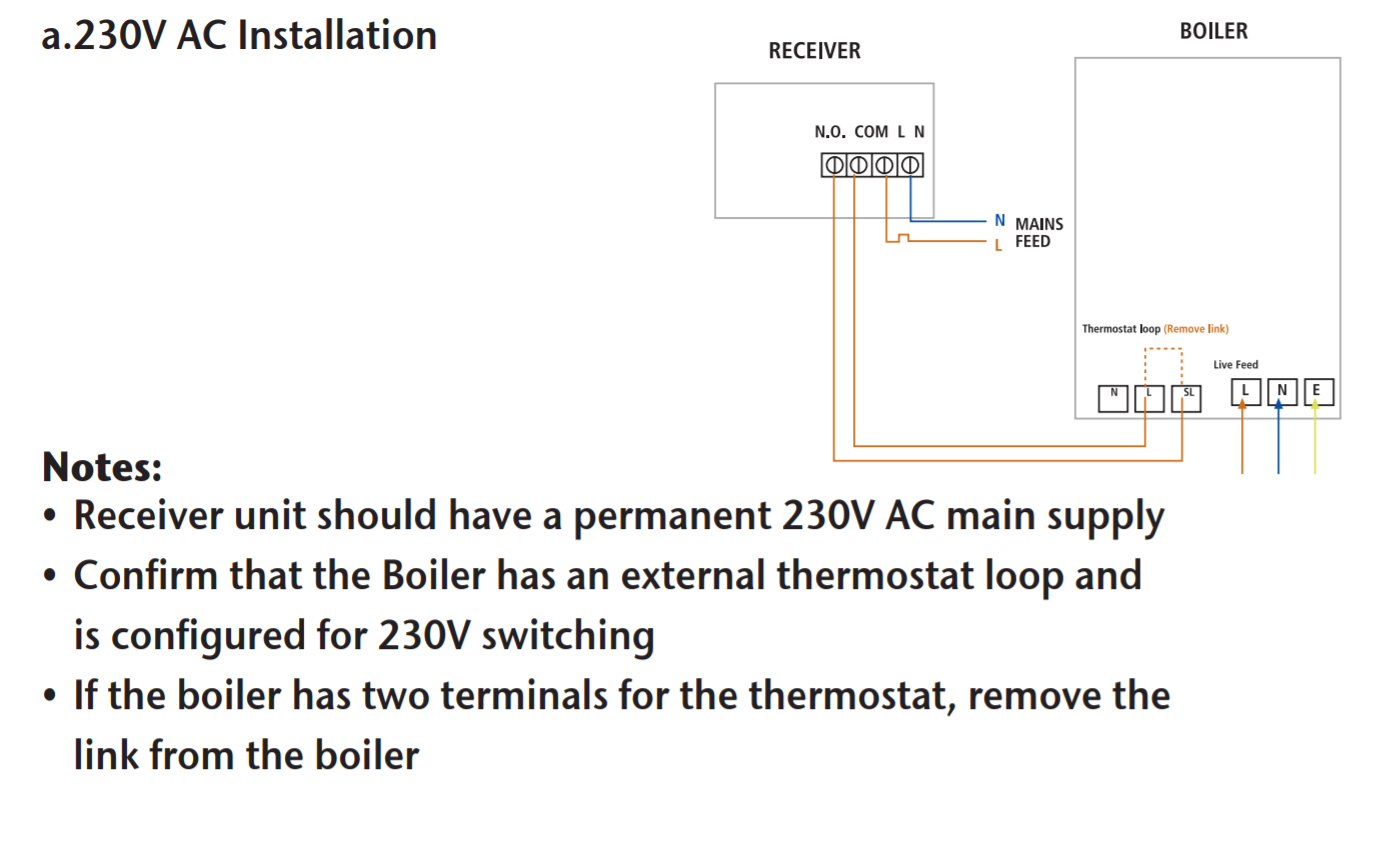

OP - your understanding is not correct at all. I'd seriously advise getting a professional in. However, use the following information as you will (I'm not familiar with either the boiler or the stat, so am relying on the manuals I've googled):
Boiler:
https://www.baxi.co.uk/our-boilers/...hash=9DFCE6C1D45832C8E7919E71C262846D1F622214
Allows 230V connection.
Stat:
https://salus-controls.com/files/RT500RF-Manual-006.pdf
So hive to stat connections are as follows:
Hive -> RT500RF
3 -> NO
1 -> COM
L -> L
N -> N
Thanks guys, I did think the earth was not an earth as all the other pics I've googled don't match up to mine. I will trace the cabling back to the boiler and confirm before using the connections stated above
