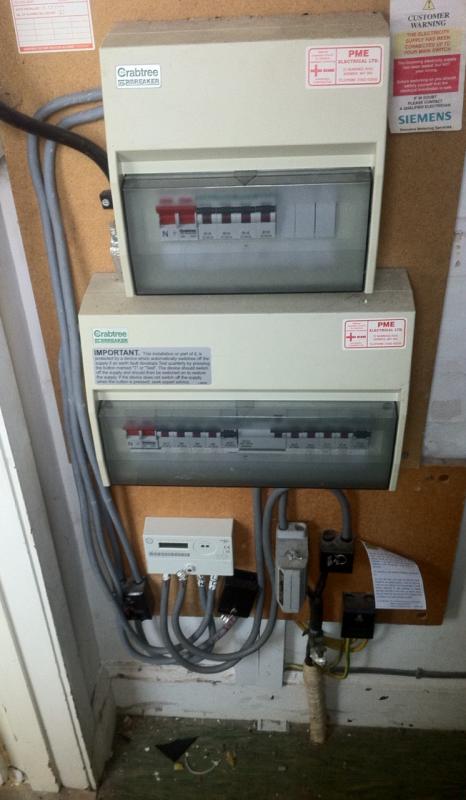

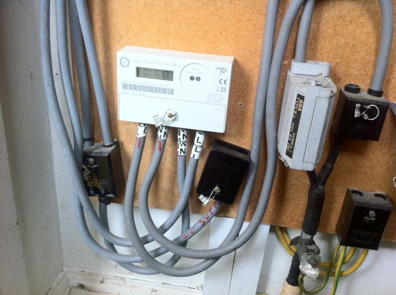

Far as I can see, Npower need to come back and fit a phase block in the tails to connect that tail on it's own to.
I don't blame the two electricians being reluctant to do this, particularly as isolation requires the meter or cut out seals to be broken.
The top board is now for 24 hr heating, and also any other 24 hr circuit you care to add.
The top board was always intended to be made 24 hr to cater for your new heaters.
It's common for older houses to have more than one consumer unit anyway, where additions have been made etc, so it's no different really.

Your top consumer unit is an off peak consumer unit, and the bottom consumer unit a 24 hour unit. If both consumer units had been connected your panel heaters would only work at night which is not what you required. To use your panel heaters at any time they would have to be input through the 24 hour consumer unit or you would have to change the top consumer unit for another 24 hour unit.
Its all rubbish.
If they had connected the top CU up to the Live supply, it would have done what you wanted. Was very easy for them to do.
I'm sure someone here will come up with a creative reply to highlight his lack of knowledge.
You asked for us to change the meter to a single rate meter so you could use your panel heaters at any time. The meter provides a 24 hour supply but the consumer units would govern the time the heaters are available. You have explained what you required to the engineer from Lowri Beck and the engineer has connected the tails as best serves your requirements.
Your electrician needs to wire the panel heaters to the bottom consumer unit.
