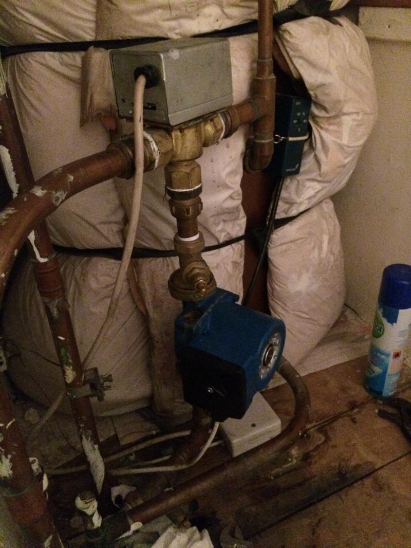

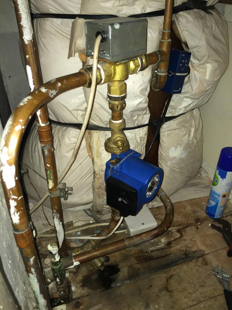

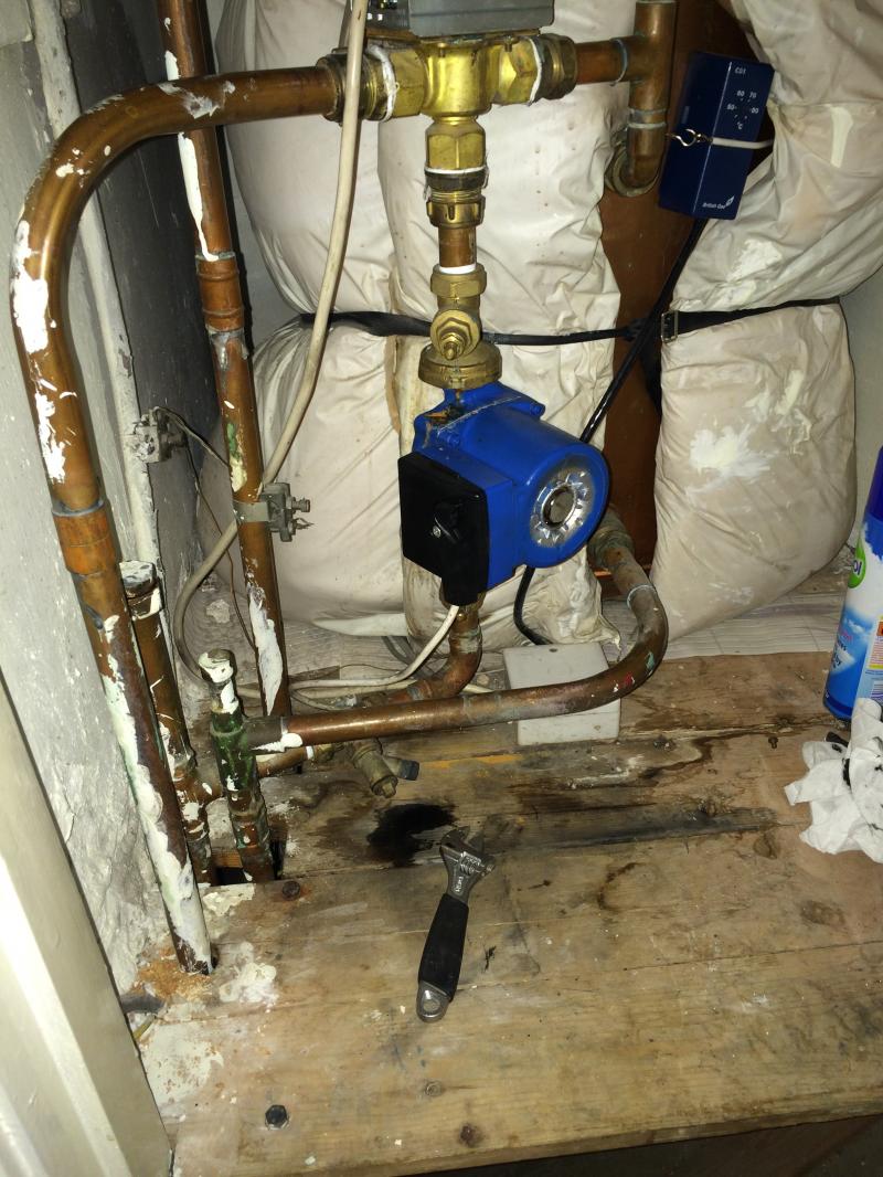

Currently my divertor valve looks like 3/4", pic below. Excuse the cruddy mark on the pump, had a faulty valve which was leaking, and a broken drain valve and now fixed
You are quite correct. The V4044c1098 is a 3/4" valve, so the Y Plan equivalent is the V4073A1054.

No bump but the top cover is loose and just lifts off. When on auto, the heating didn't work, only hot water.
New valve arrived today, just waiting for Honeywell programmer to come and I can get this all fitted. Need to re-run cabling as well, as power came from downstairs with danfoss 3020p next to it, and looked all messy. To make life easier, I'll put a new wiring centre box in with a new power supply and move the programmer upstairs, and just run 4-core from junction box down to back boiler
Thanks again for help
Should have updated sooner, but new valve in and all wired up. System is working great. I added a lock shield gate valve in the return from cylinder to help balance system
