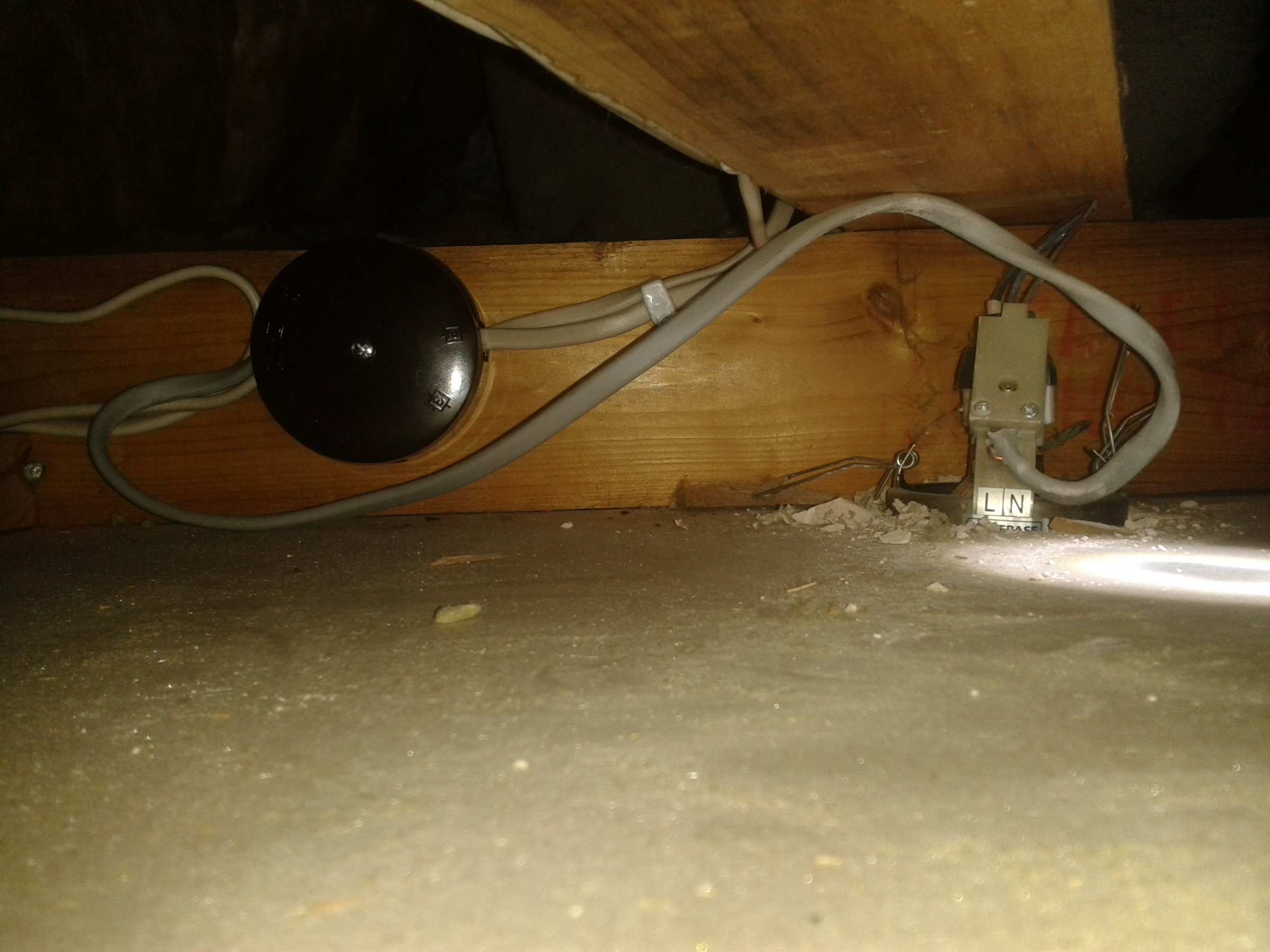

Hi guys,
I want to change the existing Halogen light fitting back to a conventional Ceiling rose so that i can fit a conventional light fitting.
the other rooms on the same floor/lighting circuit use a mix of halogen fittings or ceiling rose's in the respective rooms
installing the actual ceiling rose is not a problem but im not sure about what changes i will need to make to the wiring and junction box.

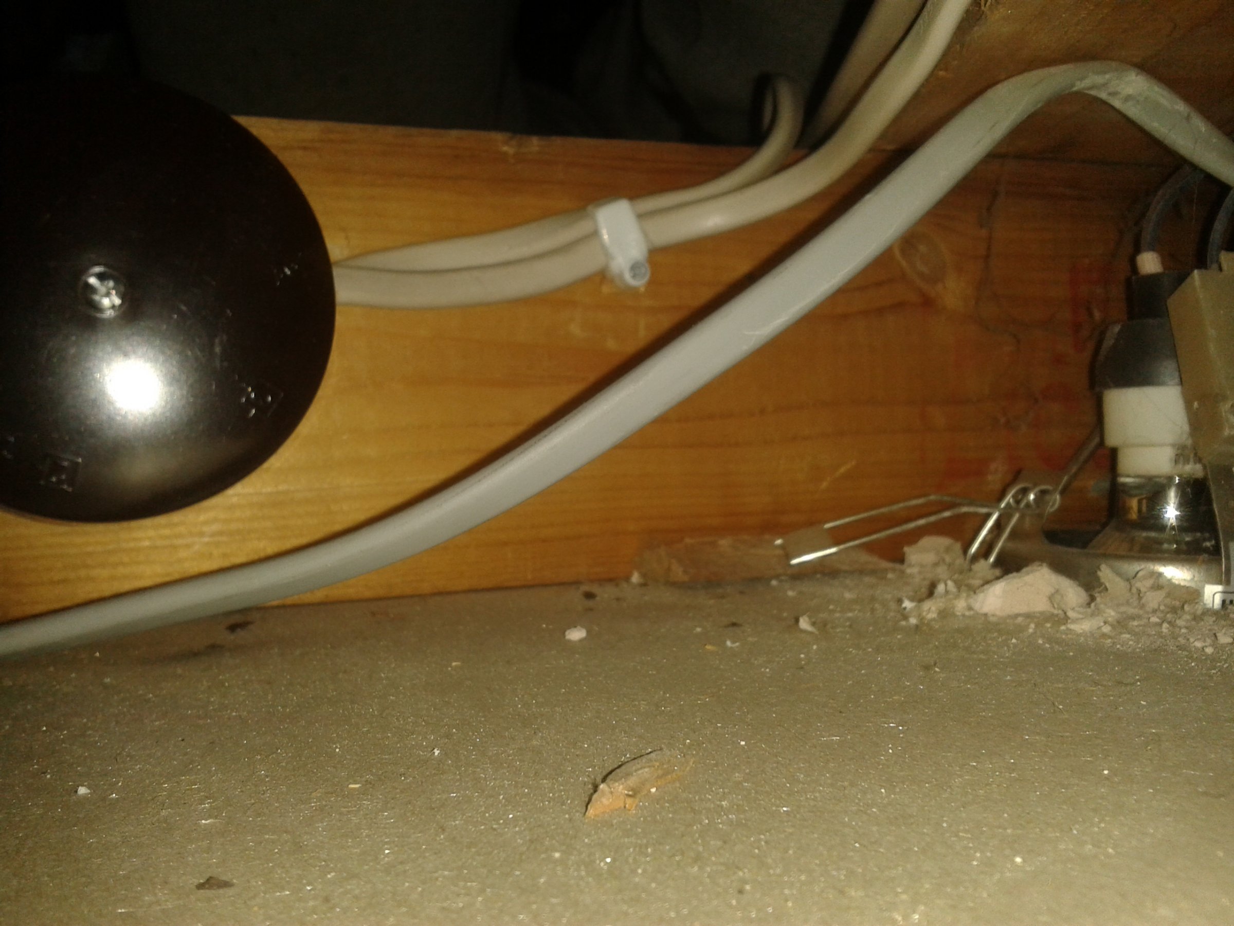

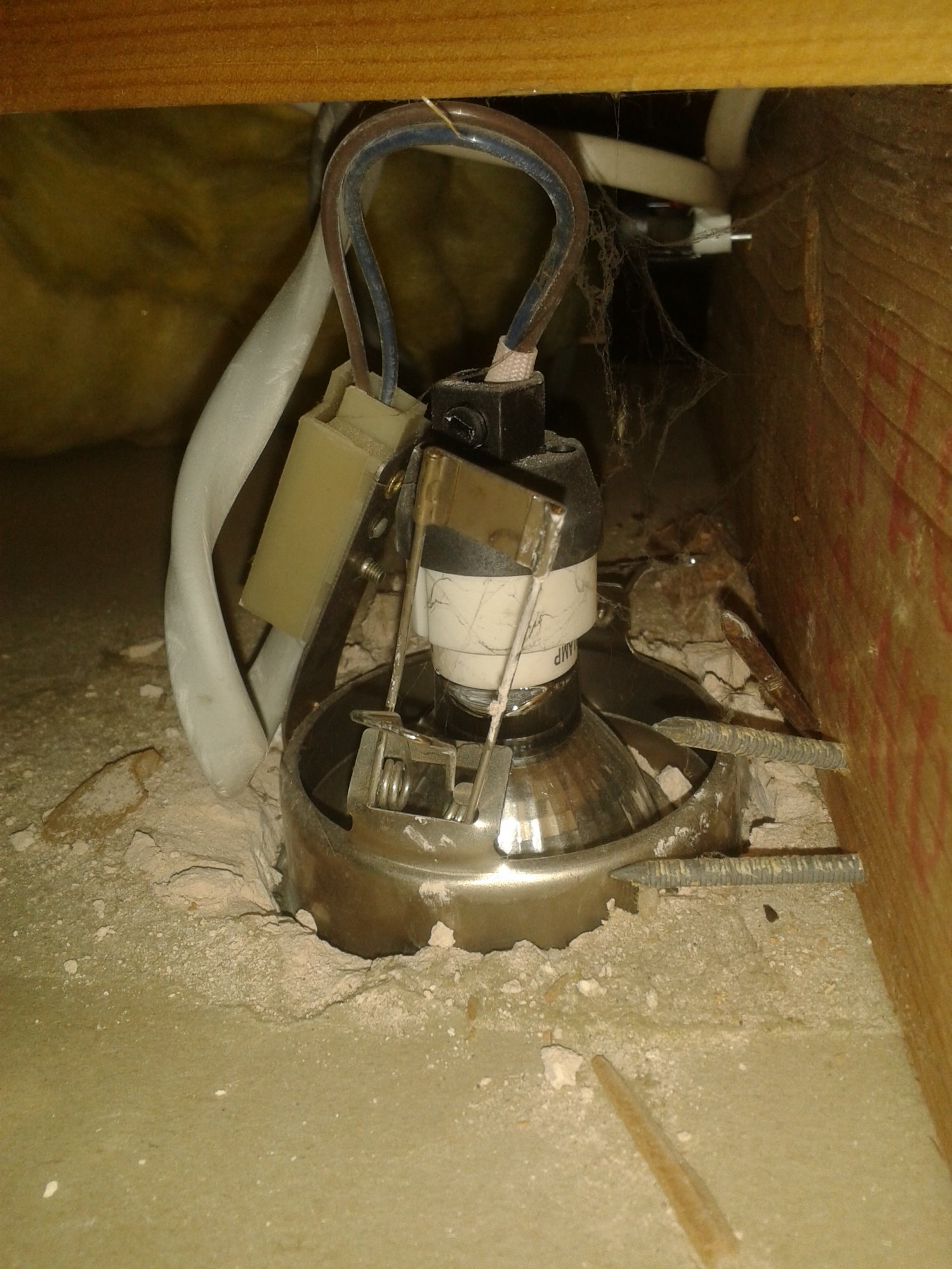

The current wiring is set up for the halogen light as per the attached pictures:
my questions are:
1. Do i need to change the wiring in order to install a ceiling rose and then fit the conventional light fitting?
2. what are the details of the wiring changes that i need to make?
Rob
The grey cable attached to the halogen fitting should have all you require, you will need to test that the earth/CPC is continuous and has an earth path back the board.
Other than that you could tidy things up a bit by replacing the junction box with a maintenance free one.
The wiring to the ceiling rose would be Red or Brown to live, Black or Blue to neutral and earth/CPC to the earth terminal of rose.
The CPC should be sleeved with a green and yellow sleeve.
Check that the existing lamp has not caused any scorching to the cable, if so clean it back to where it is undamaged, if the cable is not long enough you can replace it for new.
That's assuming there is only one downlight as per the picture, but I feel that might be unlikely?
If there's more than one downlight, you will need to find the first junction box in the circuit (likely closest to the switch) and then if you remove the two cables that go to the nearest fitting and the next fitting, replace with one length to the rose position, and as PBoD said, replace with a MF junction box

It should be straight forward, you will have some remedial work to do to ceiling, the important things to look for is any scorching on cable from halogen lamp and that you have continuity of the CPC/Earth. And as advised previously, swapping over the standard junction box for an MF one would be an improvement. As it is likely you have the switch live to deal with at the junction, a Hager/Ashley J804 would be recommended.
