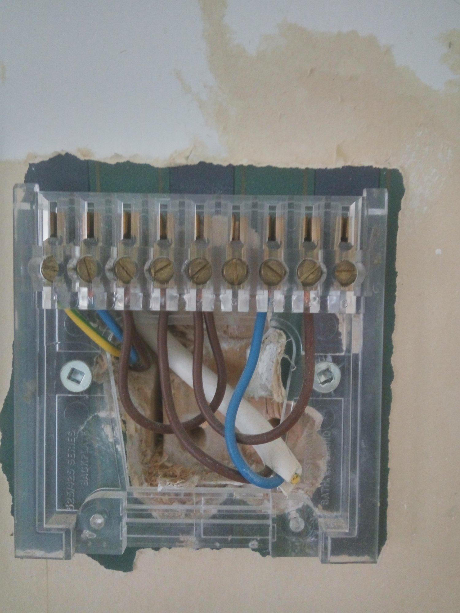

That’s very helpful as I am looking at replacing my good old 425 Tiara for a modern Hive system.
I DO have a room stat so further advice on this would be appreciated.
(I have a Worcester Bosch Greenstar 30CDi Conventional, pumped CH with room stat and gravity HW with cyldr stat. My room stat has 3 wires going in to it.)

Anyway lecture over :) and back to your question. To help, I will need to know the make and model of your room thermostat, and what terminal each of the three wires goes to. Unfortunately there are lots of thermostats with different wiring configurations and the colours of the wires used would have been at the discretion of the initial installer.
43FDBD11-0C51-4D62-A24D-9C53DDDCA4AC.jpeg 23A2AAF1-9358-471F-BE08-6B903B1EB227.jpeg 0BD1282B-AC21-4B2B-A08D-9922FA8A30C6.jpeg 38CC6FC5-9C44-4B9F-8905-319AD38BCABE.jpeg My apologies for the hijack, I wasn’t aware of that, I stand corrected and apologies to Austin.
Thanks for allowing me to continue, here are pics of my room stat, (the yellow goes live when there’s a call for heat) I’d appreciate guidance on this.
Also, see the photo (4th) of the backplate wiring of my 425 Tiara, you’ll see I have no wire in terminal 6 (CH Off) everything works fine and has done for years but could this pose a problem when installing a Hive?

The wiring at the Tiara will be pretty much as I described earlier to Austin, with one additional connection, because your system has a 3 port motorised valve. This type of system doesn't need a 'Central Heating off' connection and I would have been worried if there was one!
The Lives and Neutrals are a straightforward swap like for like
The Brown wire in Tiara terminal (1) 'Hot water on' goes to Hive terminal (3) 'Hot water on'
The Black wire in Tiara terminal (3) 'Hot water off' goes to Hive terminal (1) 'Hot water off'
The Grey wire in Tiara terminal (4) 'Central Heating on' goes to Hive terminal (4) 'Central Heating on'
You can disregard the links, the Hive has these made internally. Remove them and discard them.
For the existing thermostat wiring, you have three choices as follows:
1 Remove the thermostat and put the cable in a junction box:
Connect the Live (Red) and Switched Live (Yellow) wires together
Isolate the Blue neutral wire separately
2. If you can trace the cable from the thermostat to its other end, you may be able to remove the cable completely and insert a wire link between the terminals that the Red and Yellow wires originated from.
3. Alternatively, simply leave the thermostat as it is, and move the yellow wire from terminal 3 and put it in terminal 1 with the red.
And whilst you are at it, put some earth sleeving on those bare earth wires.
Thanks loads, that’s confirmed what I thought, oh and I’ll get some earth sleeving done right away.
