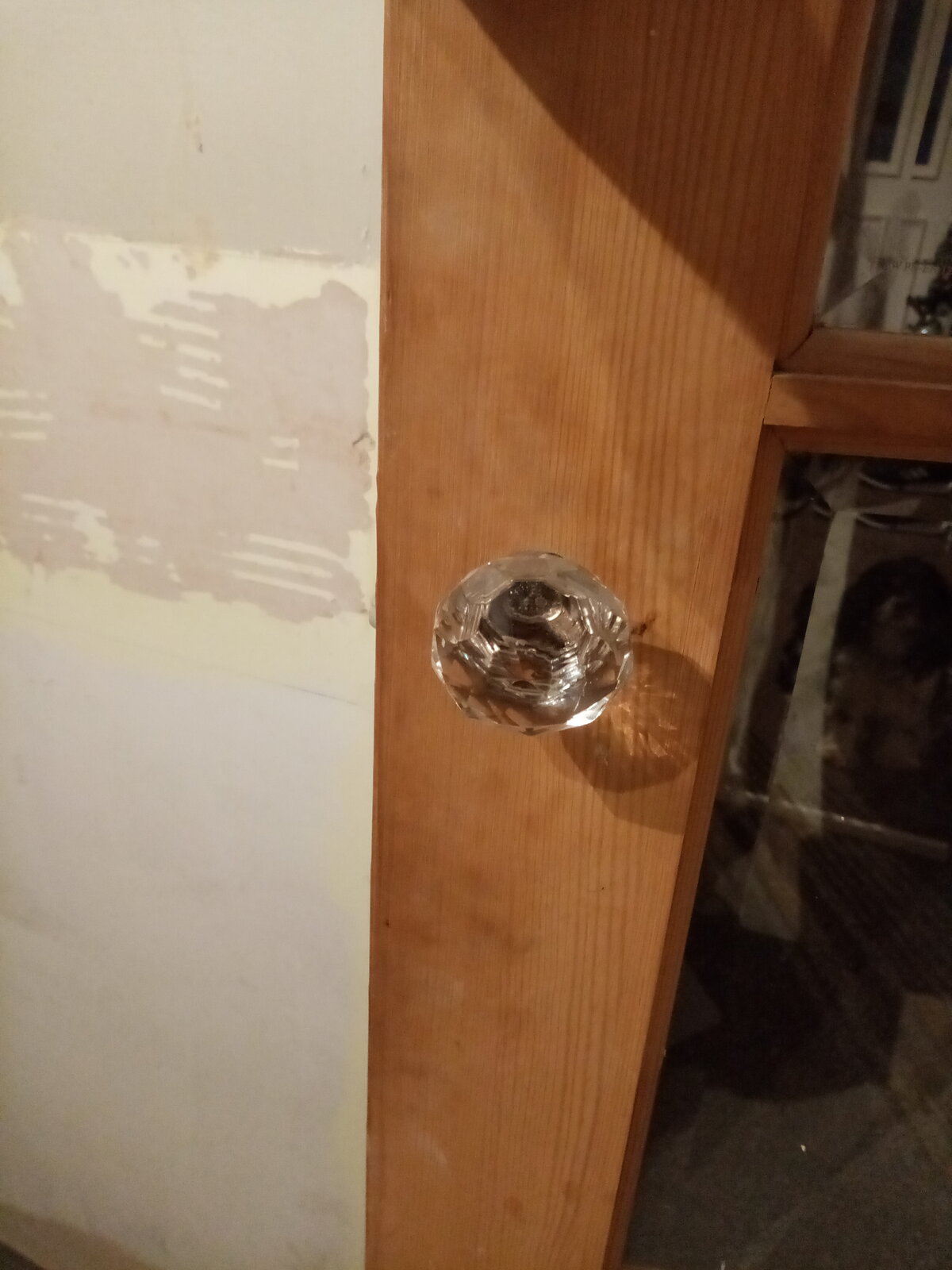

Are all internal door handles simply a strsight swap? I hVs these old, awful handles that i wsnt ti xhsnge for the modern style lever handle
Is it a strsifht swap ir are the door cutouts diffrrent?
The screw hole spacing can vary considerably on door handles but on yours you should be able to fit handles of your choice without any problems.
I assume there is a follower bar that is turned by those knobs, rather than a roller Bales type catch?
John :)
The popular tubular latch sizes for internal doors is 64 and 76mm......thats from the door edge to the centre of the follower bar hole.
