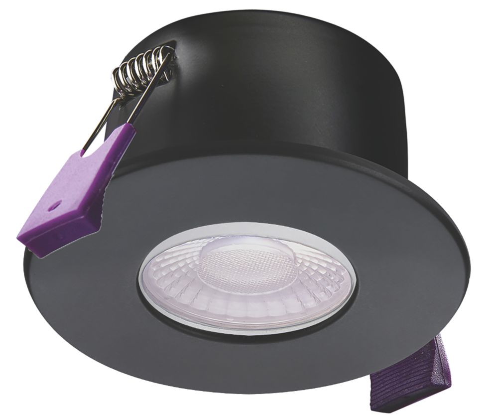

Pull the whole unit out - it is likely held in by two big springs.
Fingernails under black rim, curl hands so middle joints on fingers (which it turns out I have no idea what they are called) push against ceiling and pull with joints pushing against ceiling (this is all to minimise loading on plasterboard by the springs). When you get about a one cm gap, put your fingers under black rim and slowly pull again.
So you have an idea of what you are pulling out, it could/should look like this:
Show us a photo of it pulled out (also showing the cable) and we may be able to suggest a better/easier replacement that has replaceable bulb. .

It's becoming increasingly common - as I said, seemingly daft/ridiculous to me! ... a bit like a car with .non-replaceable' wheels/tyres !

Thanks for all your help, everyone. It turns out I am indeed very ... disappointed.
