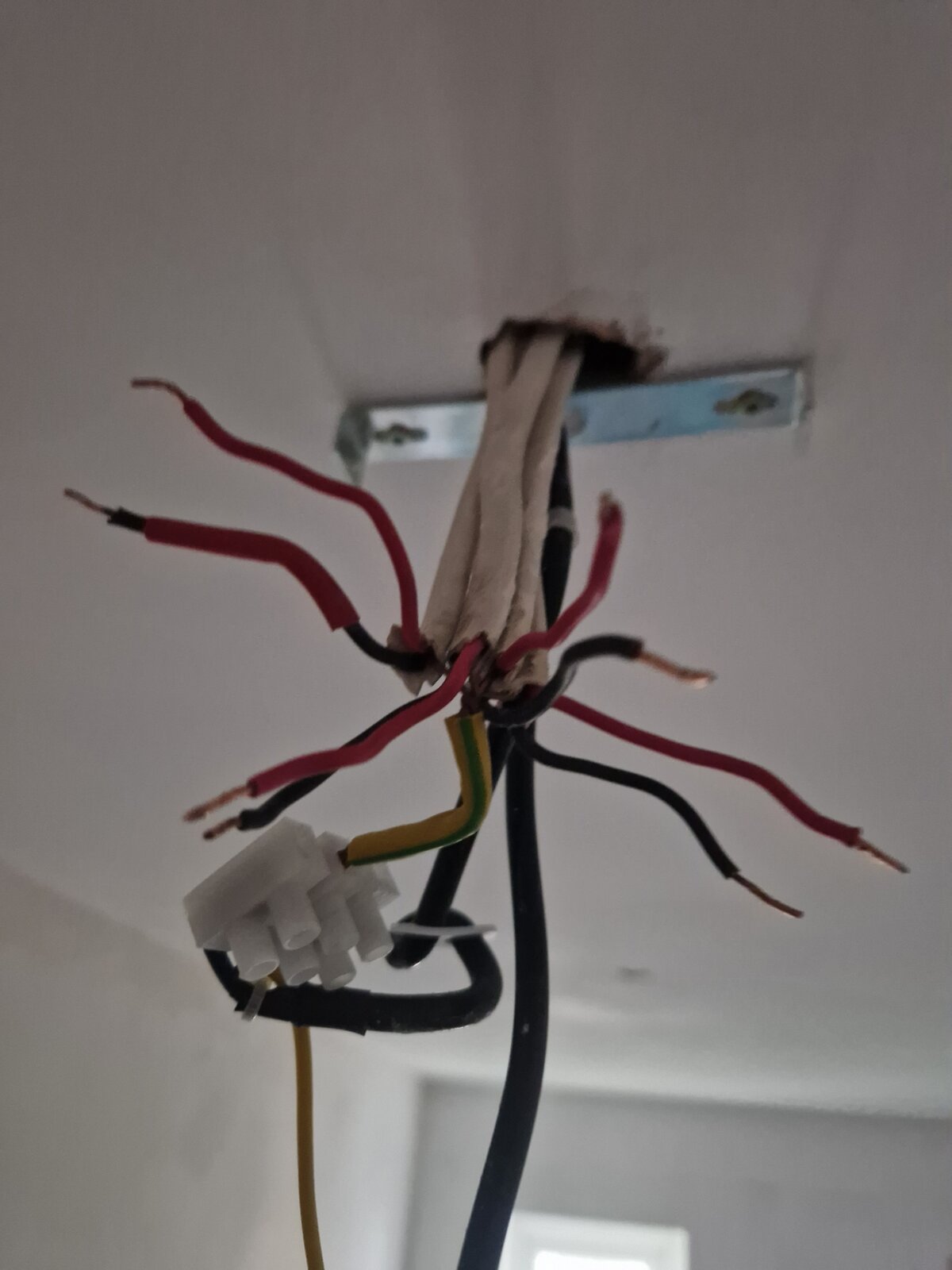

I'm changing a light pendant, one of two in the hallway controlled by a 3 way light switch, however the new one only has live, earth and neutral connections. I have three pairs of black and red, one black with a red sleeve and need help as to how to wire this new fitting. Thanks in advance.

Shuffles from side to side looking at feet! I didn't take any before photos. Can I identify the wires required with my non-comtact voltage pen?
Then the black ones are likely neutrals and need to be connected together (including the blue from the light) and the black with red sleeve is the switch line that needs to go with the light‘s brown.
Yes you are right @RandomGrinch. I've just remembered that it was the plasterers that removed the old fittings hence no photo of how they were wired.
So all the red wires should be wired in live of the new fitting including the switched live? So that's 5 wires into one live terminal? Then all the blacks wired to neutral terminal on the new fitting?
No. Clue, you said
"I know three red wires were wired up to the loop connection in the old pendant."
No, only the switched live connects to the live of the new fitting.
The four other reds should be connected together in a separate connector.

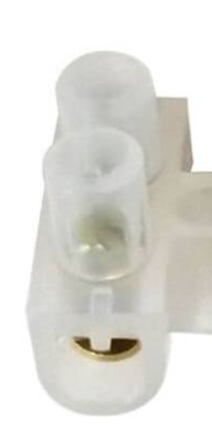

Thank you for your clear explanation @RandomGrinch. Could I use a connector block for the lives and just screw two in each side?

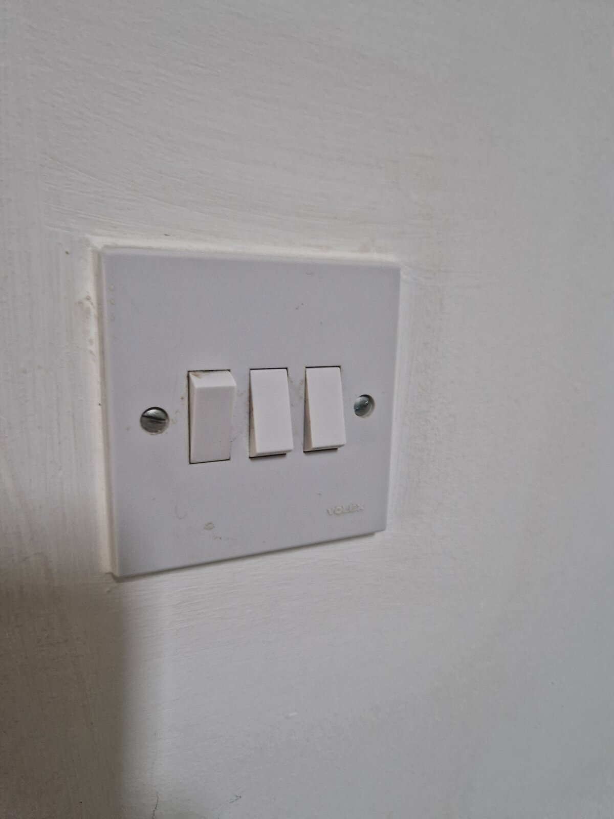

I've just tried wiring it with switch live in light fitting live, all the blacks in neutral of light fitting and the reds wired into the connector block, two each side, and it's not working.
Are there any other light switches controlling this switch?
Do the other lights on that circuit still work?
Can you temporarily connect up the old pendant and see if that works?
The first switch on the 3 gang light switch still returns the landing light on.
The landing light is probably on a different (upstairs) circuit.
