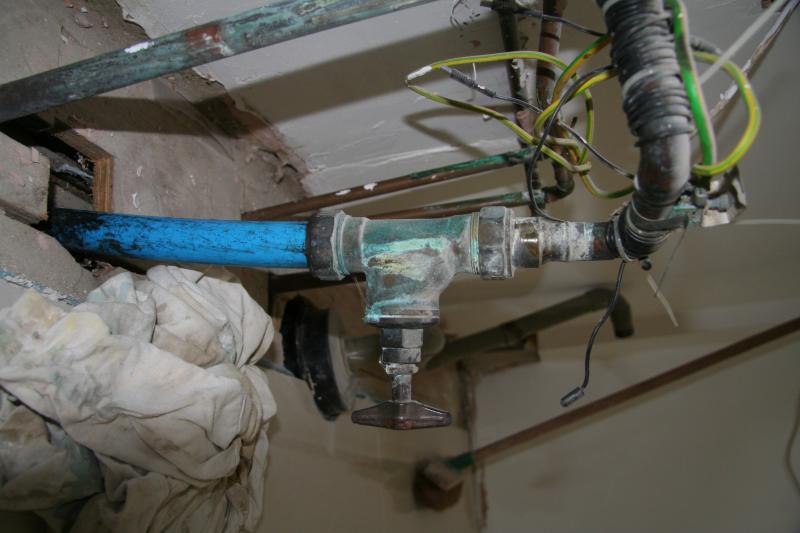

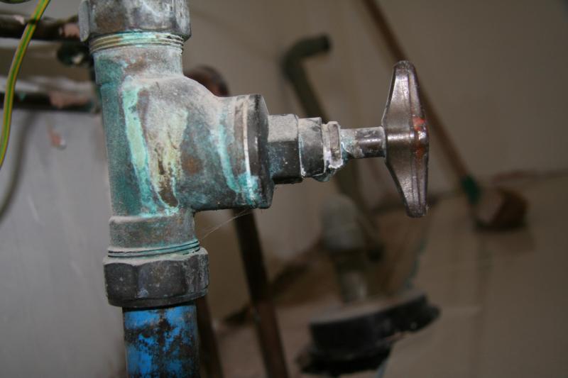

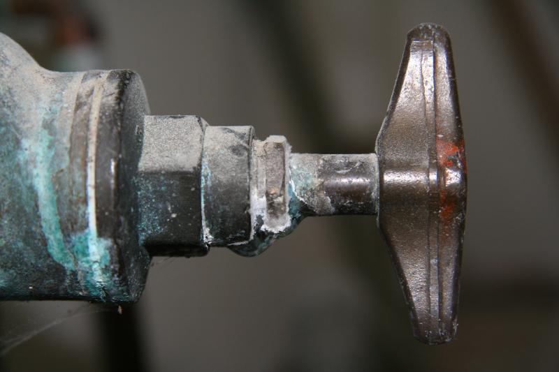

I've taken some pictures which hopefully might help.
You can clearly see a water drop on the bottom of the spindle.
Also, it's pretty glued up with limescale. If I didn't have to replace, that would be fantastic. Are there user servicable parts inside the stop cock?

If the blue pipe is running upwards, it looks to me like most of the leak is from the upper compression joint (unless it is dripping from the joint above). Undo it, clean all surfaces with wire wool or green kitchen scouring pad, put PTFE tape round the olive, and reassemble. PTFE tape is very good at making compression joints watertight. Some professionals don't use :rolleyes: it because they claim their joints never leak...
If you scour all the copper pipes bright, you will easily see the marks of any remaining leaks in a week or so.
Thanks John
Yes, the blue pipe is running upwards - sorry - should have rotated the photo.
But I don't think that any of the marks on the main body are new - ie I think that the top compression joint is ok - I think it's only the spindle that is leaking.
Cheers
Steve
If the gland nut doesn't respond to nipping up , unscrew it, twist a length of PTFE tap into a round 'string' and pack that around the shaft under the nut.
I've done this a few times with some success, what exactly does the PTFE do? :confused:
The gland nut squeezes the gland packing against the valve spindle in the same way a compression joint squeezes an olive onto a pipe.
The problems often start when you close a valve for the first time in years. As you wind the spindle down,all the bits of limescale and other crud stuck to it tear chunks out of the soft packing in the gland, so it leaks when you turn it back on. The PTFE replaces the lost packing material, so there's still something for the gland nut to squeeze onto the spindle.
Traditional packing materials included hemp and tallow, and asbestos fibres in graphite grease :eek:
A piece of butchers string coated in candle wax works well too.
Setting the gland is often a compromise between achieving a perfect seal, and still being able to turn the valve spindle. I often err on the tight side for a rarely used valve, as I'm prepared to slacken off the gland nut a tad if I need to operate the valve.
