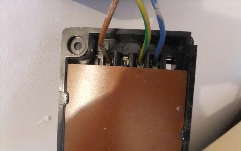

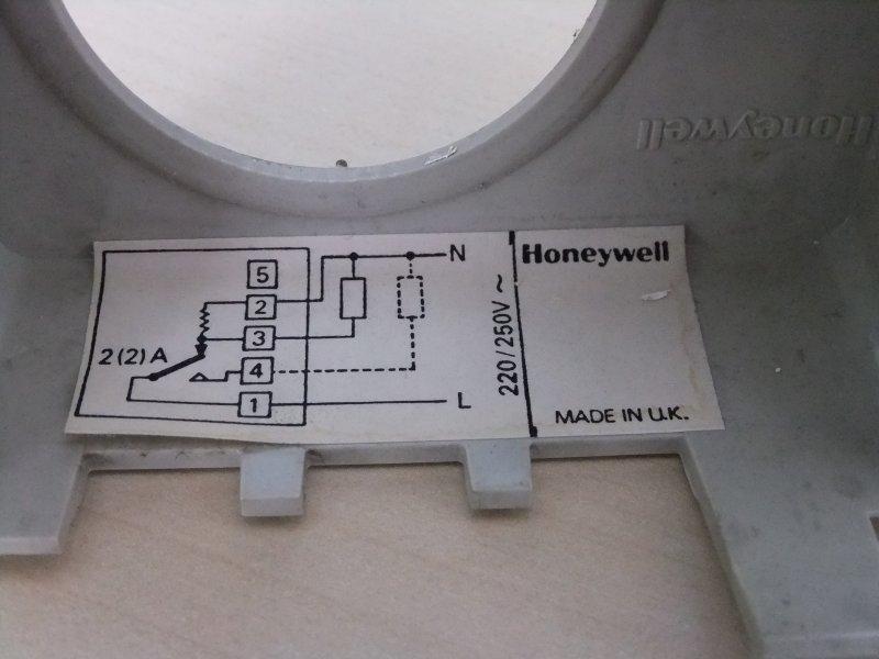

Hi wanting to change an old Honeywell room thermostat to a Salus RT300 and would like to check I have the wiring change over correct before I go ahead .
The old Honeywell is 3 wire the Salus is 2 wire.
1 goes to Live on Salus
2 terminate as not needed
3 to SL on Salus
Alan
Looks like someone used the earth core on a flex for a switched live on the Honeywell and didn't bother to sleeve it as a "live"
I also see that the Salus RT300 has an earth parking terminal.
That is not a straight switchover as the earth core needs re-wiring to the earth terminal at the other end of the cable and neutral needs re-wiring at the other end as a switched live. Then sleeve the neutral core both ends with a brown "live" sleeve. At the Salus you then use the correct colour codes with brown to L and the brown sleeved blue core to SL
Just doing what you are saying will work but the conductors will all be wrongly identified and that is just wrong when it can be wired properly.
cant i just mark the cables correctly, as no earth is needed if i'm reading the instructions correctly.
no Earth connection is required for the correct and safe operation of the RT300, but a parking terminal is provided to connect
an Earth wire if one is present
I am aware no earth is required the terminal is just to "park" one if it's in the cable .
The point is when some-one else follows on from your work and sees a yellow green conductor they might think it is an earth and get shocked if they touch it because it is currently being used as a live conductor.
Why not do the job properly? - It really is simple to do.
NO.
A Circuit Protective Conductor (clue's in the name) shall be run to all points of the installation.
Do it properly.
