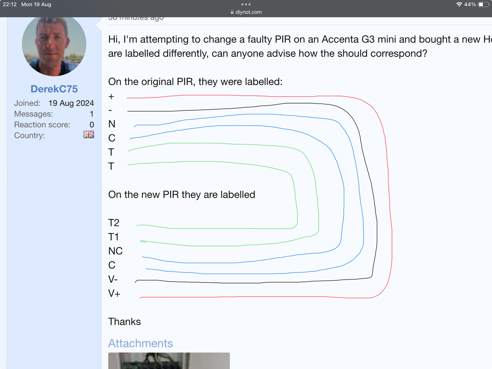

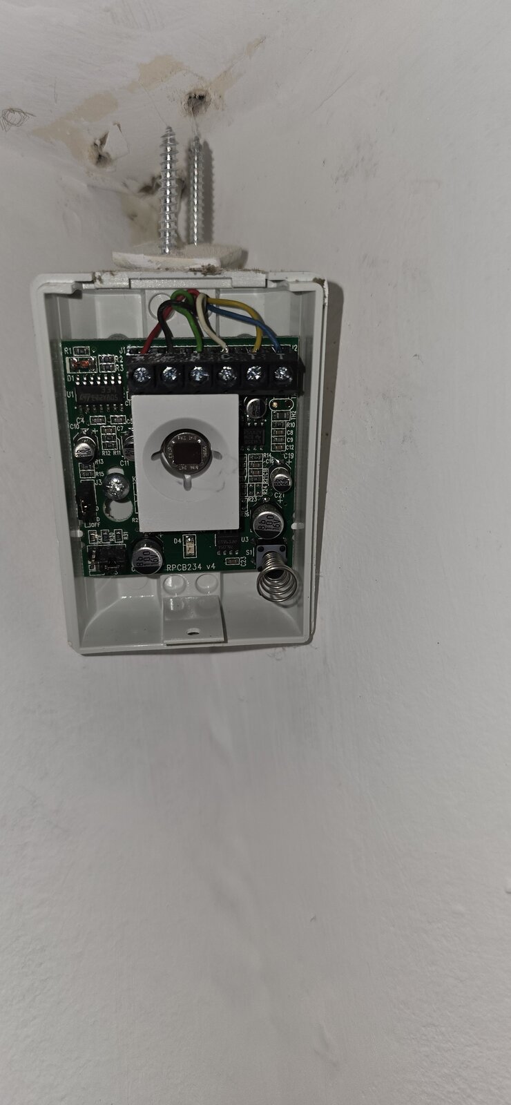

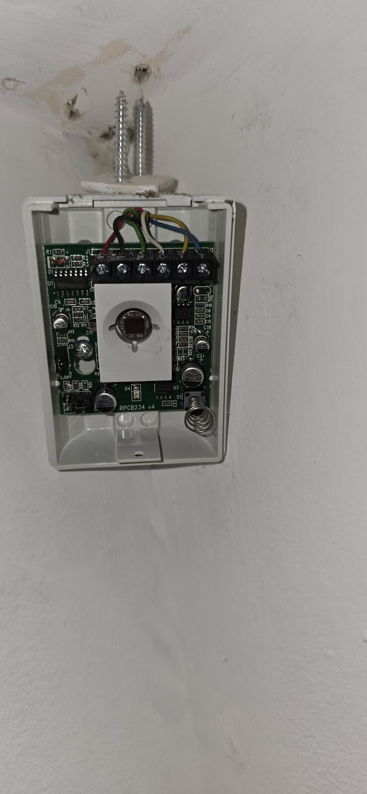

Hi, I'm attempting to change a faulty PIR on an Accenta G3 mini and bought a new Honeywell IS1312B as the replacement. The terminals are labelled differently, can anyone advise how the should correspond?
On the original PIR, they were labelled:
N
C
T
T
On the new PIR they are labelled
T2
T1
NC
C
V-
V+
As below
Alarm pair can go either way round
Tamper pair can go either way round
Power pair can’t
