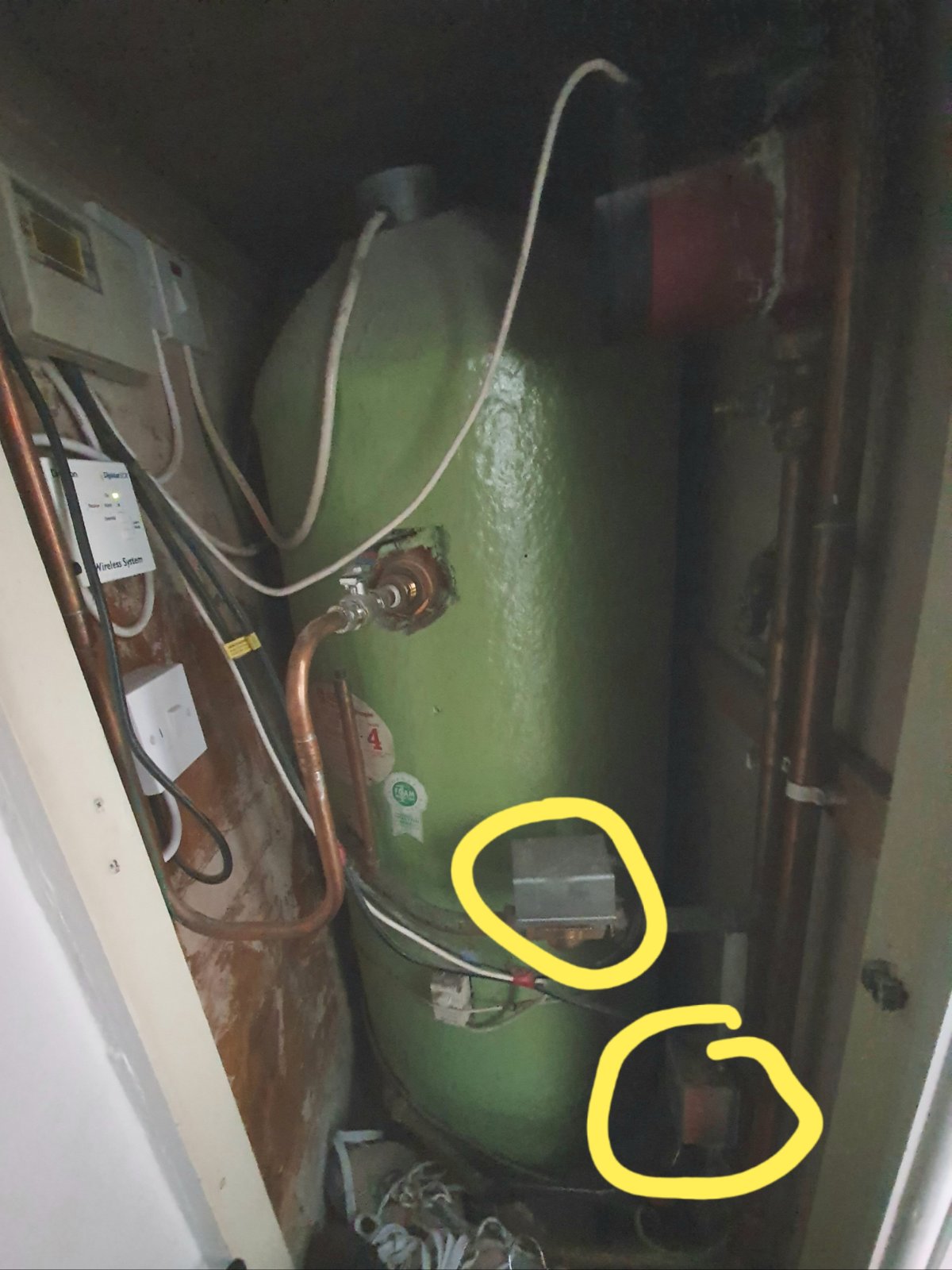

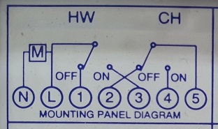

I recently bought a Nest Thermostat for our quite old but fully working boiler (Potterton Profile 60e). It is controlled via a Potterton EP3001 controller, and feeding into that is a Drayton Digistat scr wireless thermostat receiver.
I wanted to replace the EP3001 (an sd also replace the Drayton) as my hot water can only come on with the central heating, not individually).

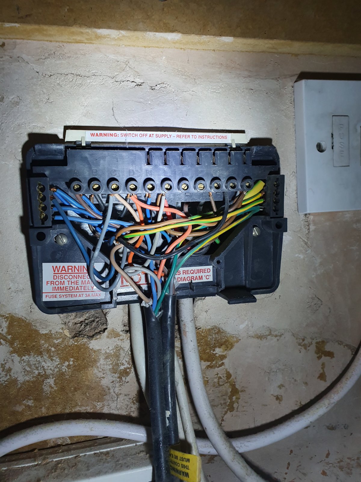

So I looked at the EP3001 wiring and hope it's a case of swapping the N L 1-5 etc wiring from the Potterton to the nest. Is it as simple as that?
Only complication is the ep3001 backplate has more wiring options that the nest.
Potterton has A B C D in front of the N L 1 - 5
Nest has N L 1 - 5
Drayton Has N L 1-4
There are also a lot more wires to the left and right on the EP3001 backplate (I think these are multiple N and earth's which would needc in a junction box before coming out into the nest? If so to where in the nest?) Or is that a bad assumption?

The block of blue wires to the left and green/yellow to the right - what do I do with these?

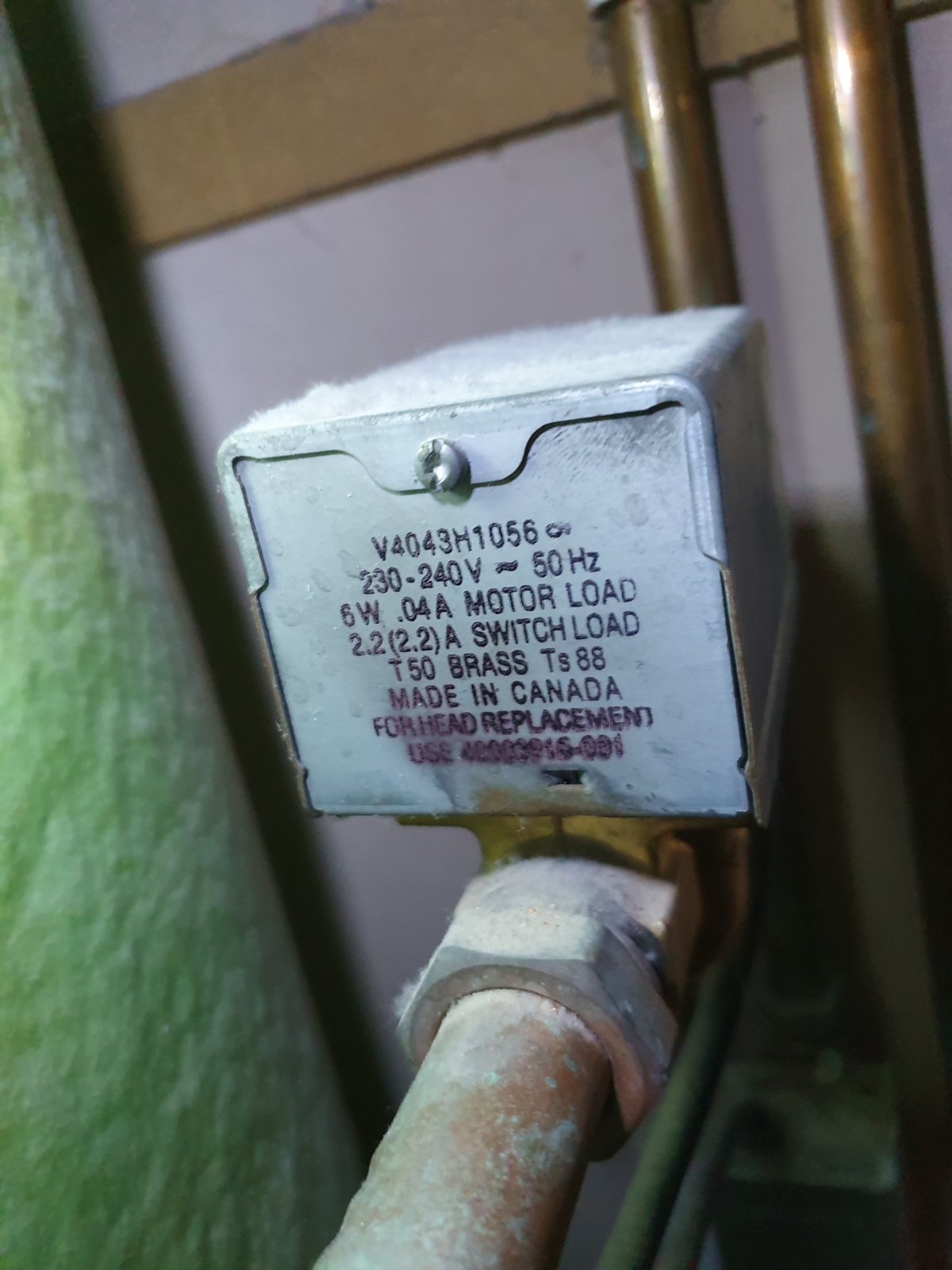

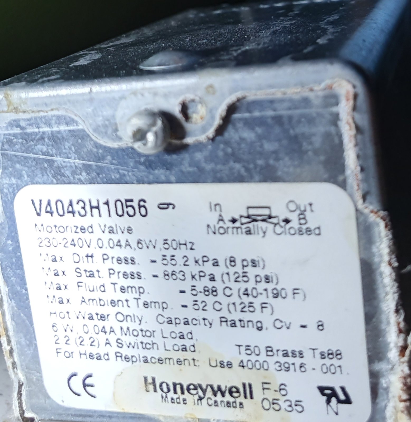

I think I have an s-plan system, as I have two honeywell inline valves (picture will explain), does that affect anything if I'm just copying the wiring?

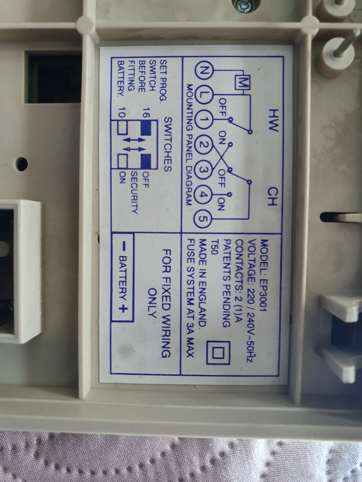

Pics should be attached,a showing wiring inof the controller backplate, the general layout of my system a (2 x valves circled), the valves mentioned above and the wiring diagram on the rear of the EP3001.

Ah, you have one of the more interesting (read complicated) installs! The old EP3001 is a combined programmer and wiring centre. You essentially need to completely rewire your system from scratch - take everything out of the EP3001, transfer it all to a wiring centre (except the cables for the SCR) then link your Nest in to that. About an hour's work for someone fully familiar with central heating wiring, but somewhat difficult to train someone to do via an Internet forum.
The EP terminals are printed on the back of it as per your photo
So it's a matter of moving the wires from the EP terminals to the Nest Heat link terminals that have exactly the same function.
So:

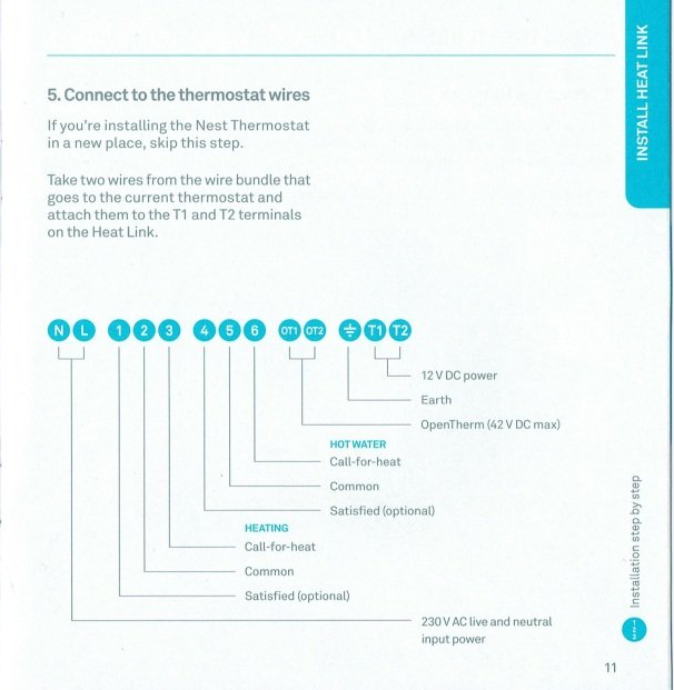

wires in EP N ..... Nest N
wires in EP L ..... Nest L (for now discard the link to EP5 we’ll come back to the links later) Once the link has gone, the remaining wires in EP5 will need to be moved to Nest L.
wire in EP 3 Hot water on.....Nest 6 Hot water call for heat
wire in EP 4 Central Heating on... Nest 3 Heating call for heat
Then add links so that Nest terminals L, 2 and 5 are electrically connected together.
EP Terminals A B C & D don't have any function as far as the programmer is concerned, they are just terminals to facilitate the wiring. So you will need 4 new terminals for them so that all of the wires in A remain connected together, as will all of the wires in B, C & D
The same applies to all of the neutrals and the earths on the far left and right. Normally I sink a new backbox in the wall behind and locate all of the new terminals in there.
You will also find it hard to get several wires in the Nest terminals, so for example in the case of the L terminal, I would also connect all of the wires into a new terminal and the just run one Live to the Heat link.
Please do not underestimate the complexity of this task. You need to be extremely electrically competent to do this and fully understand how your heating system works. If you inadvertently transpose wires or mix them up it will be almost impossible to resolve over a forum. So please don't proceed unless you know exactly what you are doing.
Finally you will have to be decommission the existing room thermostat. It can't just be disconnected, the two thermostat live switching wires at will need to be 'bridged' ie connected together to complete the circuit. As a temporary measure it can be set to its maximum setting, but it's not really a permanent solution.

In this case, I suspect that there is a fault with your hot water's motorised valve. The motorised valve is wired to the EP & Cylinder thermostat, and when heat is required by both they open the valve. Inside the motorised valve is a small switch that in turn starts the boiler & pump when the valve is fully open. My guess is that the hot water controls [EP & thermostat] open the valve OK, but the switch doesn't operate so the boiler doesn't start up. Then when the heating valve opens, the switch inside that starts the boiler & pump so both the heating and hot water can work.

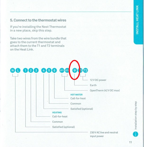

Only question really is there was an earth wire in the scr wiring which wouldn't connect to Nest, so I capped it. Should be ok?
Eh????.......
The instructions do state that the earth is only required if T1 & T2 are being used to power the Thermostat, but personally I would still park the earth wire in there even if I wasn't.
Exactly I wasn't sure if it was better to leave it out or use that, but as I wasn't using T1 & T2 I decided not to bother...
I can go back and do that tho
